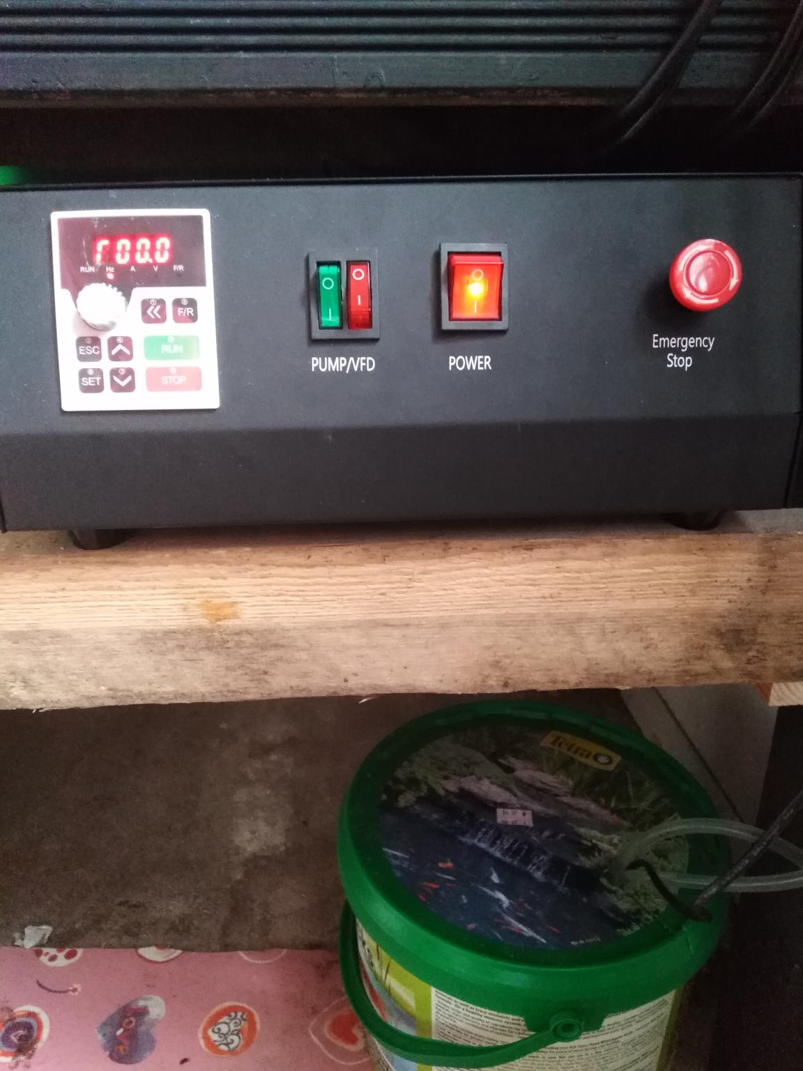

    Am trialing this CNCST4060AB3 for a while to see what its like , Not a serious machine like the Kew ,but it may have potential for the job i have in mind , milling urethane bushes with a 6mm single shank cutter. Basically all it needs to do is trim the over pour off and leave the bush flat on top.So hence having a look at this machine but i can not get the water cooled spindle to work , have looked on you tube for this type of box but no joy so here is a photo of it has anyone got one like it and knows how to get the thing to do something please

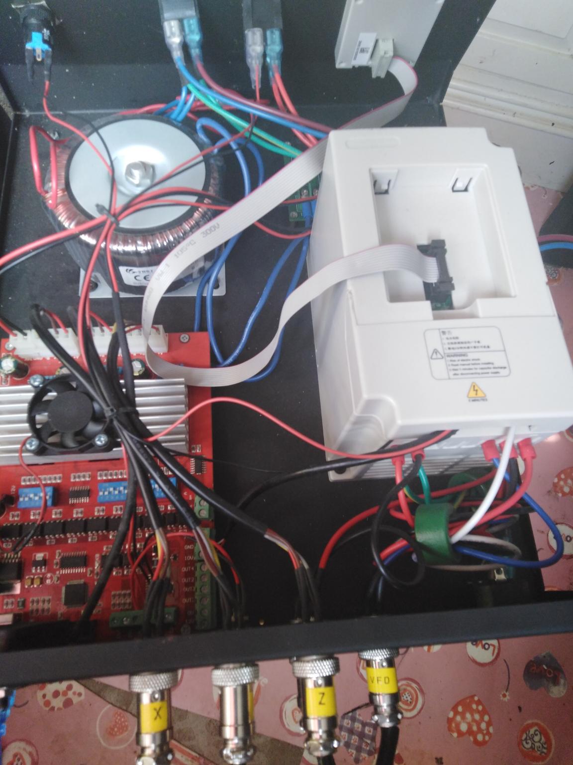

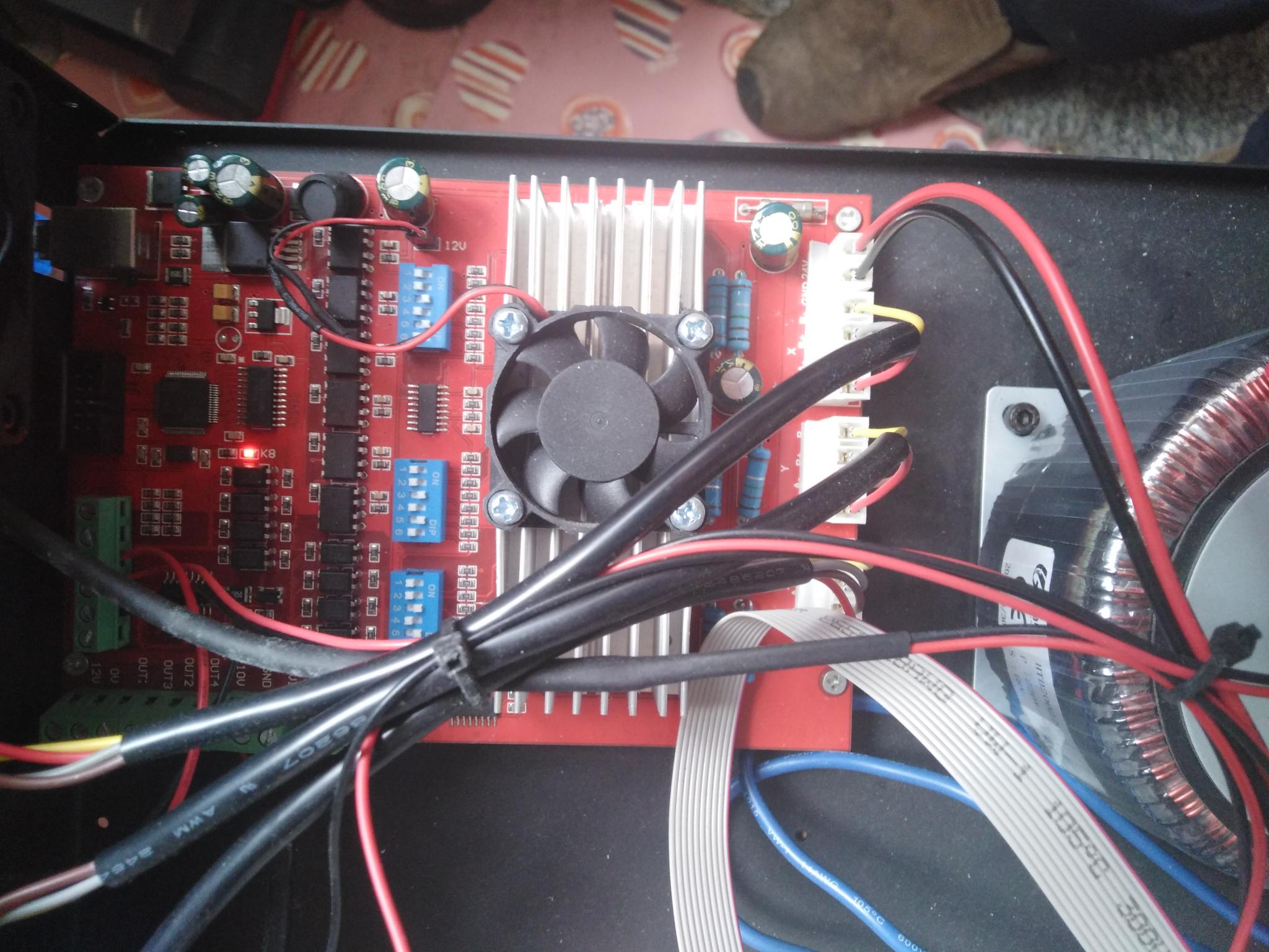

    Are you able to, or otherwise unable to open the enclosure for the VFD - there's more in that enclosure than just the VFD, but what is very important to the understanding of this is any interconnect from the internal (USB?) BoB and the VFD controller. That tells us if you have a Mach3-able solution or whether it's manual.
    The "r00.0" display indicates it's trying to run, but with "zero" frequency of rotation. I'm hoping that you've tried twiddling the knob on the front and that does nothing?, Also the green and red buttons should start/stop - but possibly just alternate between "r00.0" and "0000" (or something). If the green/red buttons are completely non-responsive then this could be indicative of a Mach3 configuration - and all the more reason to open the box and get some photos.
    What you're looking for are at least two signal wires from the BoB - for the Spindle On/Off, and the PWM spindle speed, along with likely a 0v/ground wire. If we know them, and where they are connected on the BoB then we can start to home on the Mach3 settings to give you spindle control.
    If there's no wires from the BoB to the VFD, and you've tried the green/red/knob controls, then we need to look at the VFD set-up. But without a model number for the VFD we're guessing as to the parameter list, and the mechanism for changing parameter values. Without care you could end up damaging the VFD, spindle, or both.

    ...I shouldn't dwell on this... but what's the red rocker switch, labelled VFD, do?, it's shown off, but the VFD is powered - so it's not a VFD power switch (unless it's borked). That's not been slaved to the VFD "Forward" signal has it?, So if you press the rocker on (1) what does the rotary knob do?

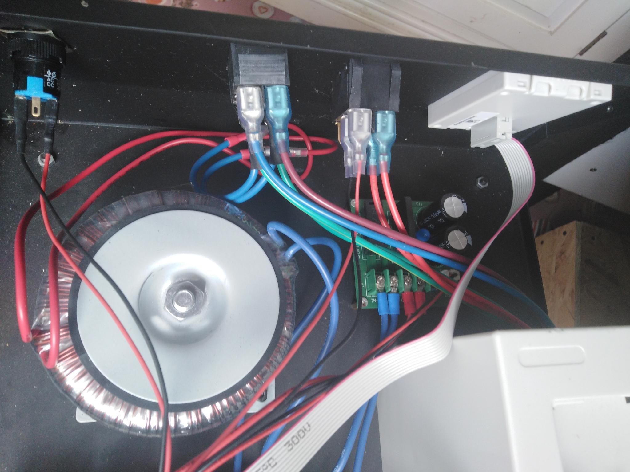

    Here are the photos .
    The red rocker switch is VFD on/off
    green switch pump
