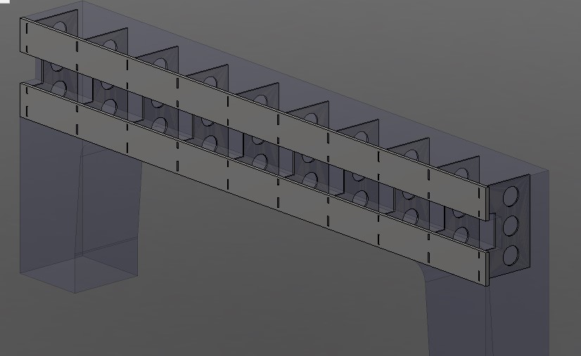

    Here's a quick sketch for what in my mind.
    Something like this, a thick 10mm steel on front for mounting rails & other stuff, And some 4 mm steel support inside the pour.
    Am I on the right track or not?
    And about the overall process, It will be not easy, I Know!
    I'll do my best in molding. My plan is cnc'ing the mold out of Melamine wood And lay them on an epoxy leveled flat floor.
    I don't have any hopes to get the Mounting plates flat after pouring on a big size like this. The base will go to a big milling machine to get everything flat & Parallel. Which will be another challenge since the estimated weight of this base around 600~700 KG
    I think I'll go with the fixed gantry design, I'll make the process easier than the other design
    If you support the table better along its full width then the fixed Gantry is by far the stronger choice but not how you have it drawn.!
    This was a fast drawing, And sure I'll make the table much more stable, Thank you.
    If anyone has any more suggestions, tips, Please share it (:
    Thank you All for helping

    Trying to stiffen an epoxy-granite structure with interlinked pieces of steel will only lead to issues due to the huge difference of thermal inertia. The steel will expand much faster than the EG.
    Forget about the bracing. If after calculation the beam is not stiff enough to your liking, increase the cross-section.

    Thank you guys, Got it.
    But, In John McNamara's build he put a LOT of enforcement inside, Like this base photo.
Name:	28-01-2019 9-40-45 PM.jpg
    I saw a lot of EG builds, most of them puts some kind of enforcement inside.
    Is there some way to do it right, Or should I just put plates on the surface for bolting ?
    Could someone please explain?

    Indeed many hobby people put reinforcements in their EG structure. Probably because they don't really know the material and treat it like a regular concrete.
    Look at how the big guys do it. Studer/Granitan, Durcrete/Nanodur, Rampf/Epument, ... You will never see reinforcements in their castings.
    Only place inserts where needed to bolt things on.
