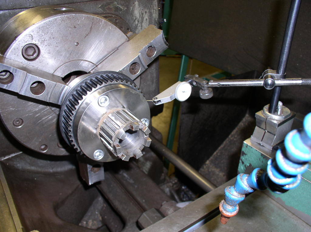

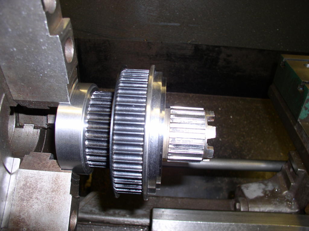

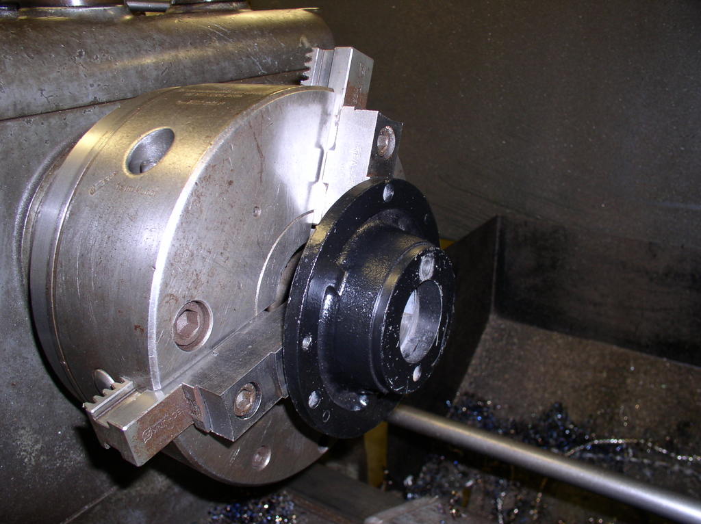

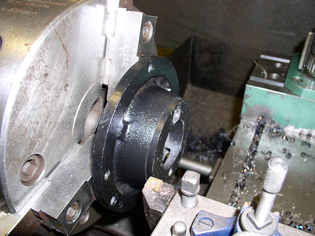

    After we put in some pins with glue we put the assembly back on the lathe to remove the rest of the pins .

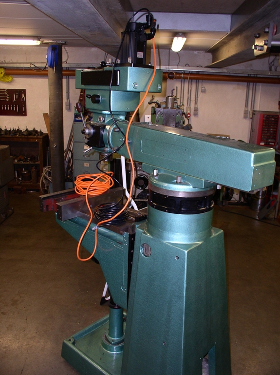

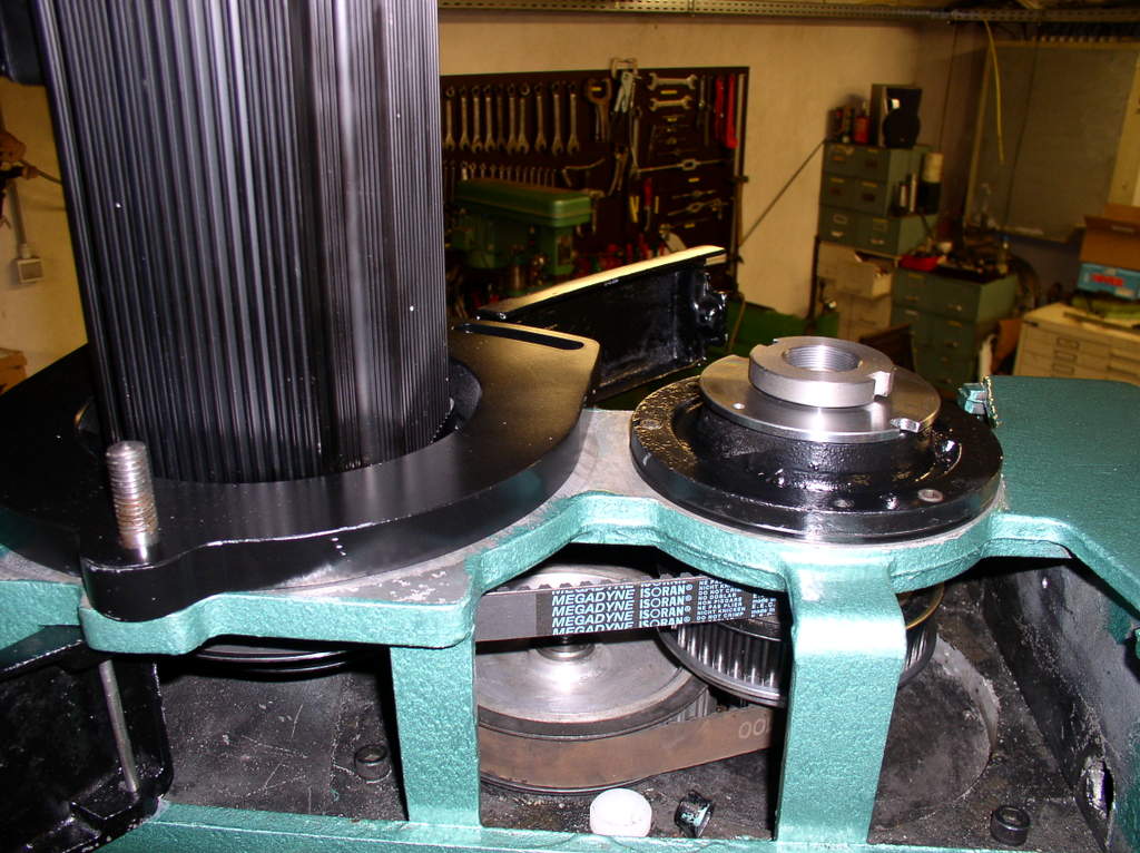

  2. #132

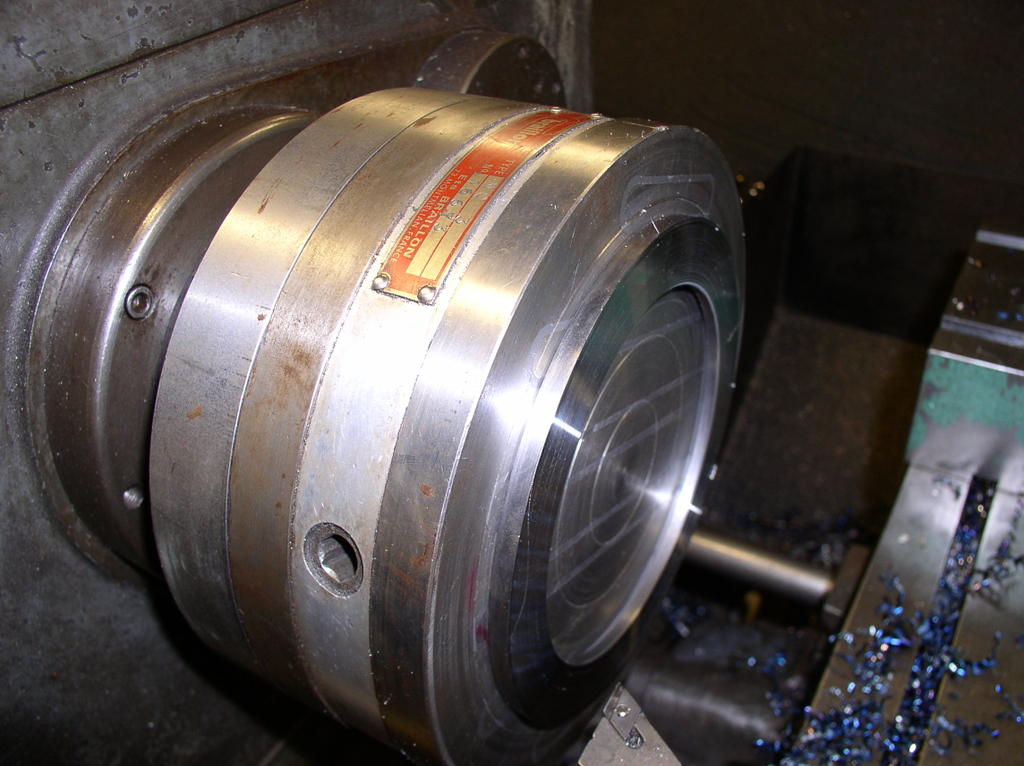

    I checked if all the parts are proper aligned .
ID:	3331   Click image for larger version.

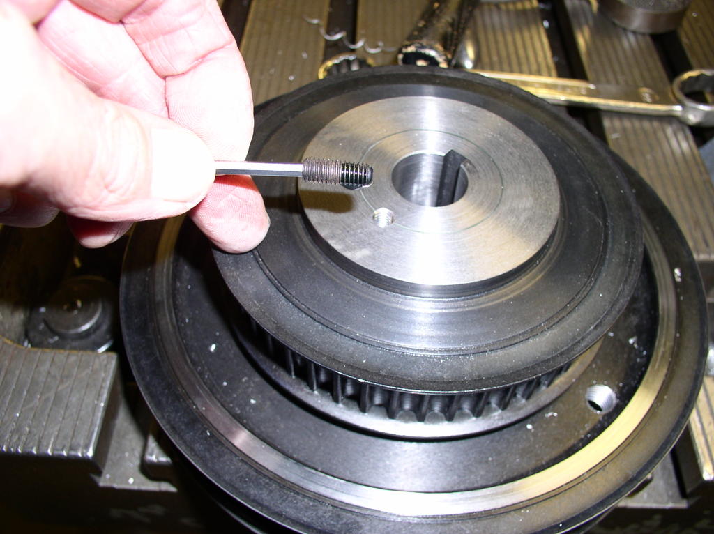

  3. #133
    I made in both assembly a M 5 hole so I could glue a screw in it.
    So things can not start to move .

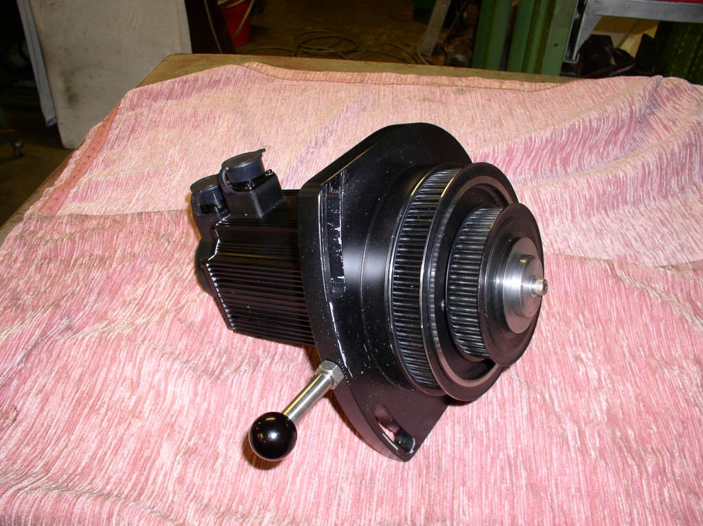

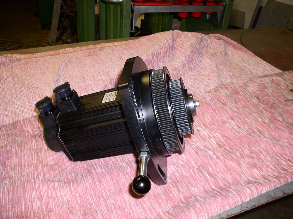

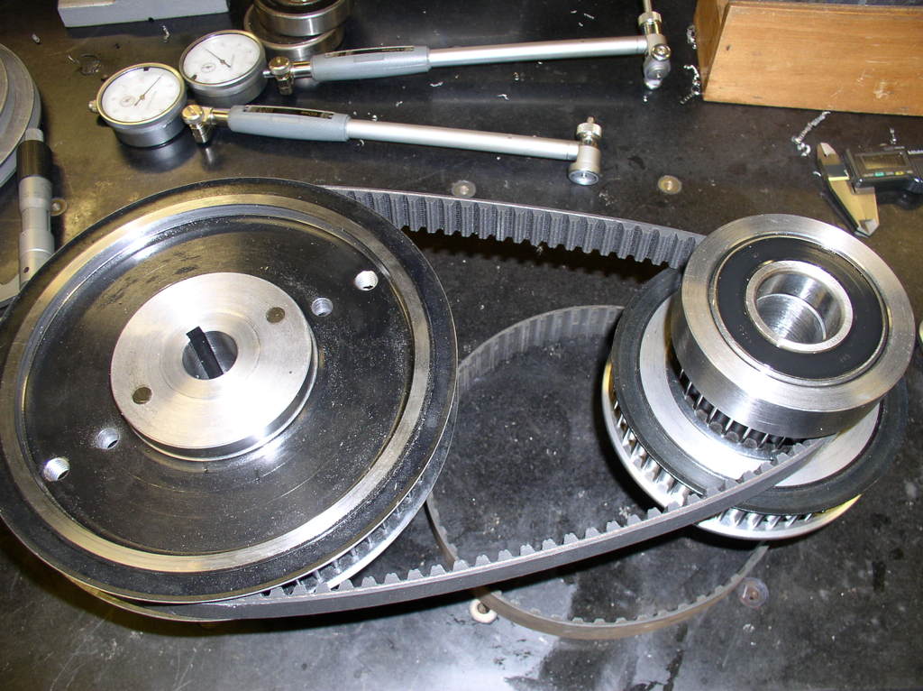

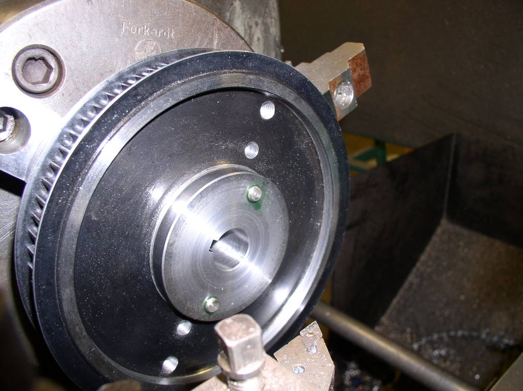

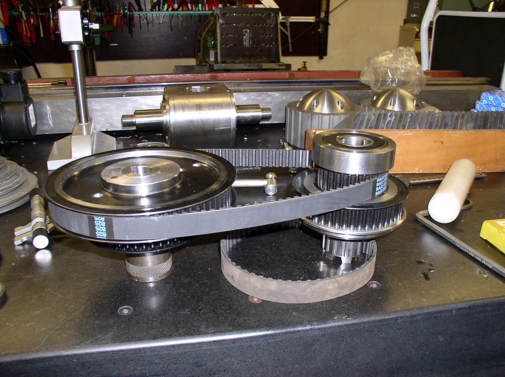

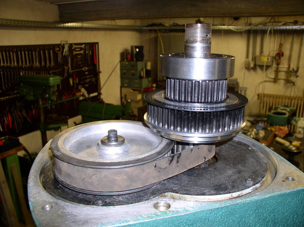

  4. #134
    Now it is time to assemble everything with new bearings and tryout the belt.
ID:	3336   Click image for larger version.
ID:	3337   Click image for larger version.
ID:	3338   Click image for larger version.
ID:	3339   Click image for larger version.
  5. #135
    And some more.
ID:	3341   Click image for larger version.

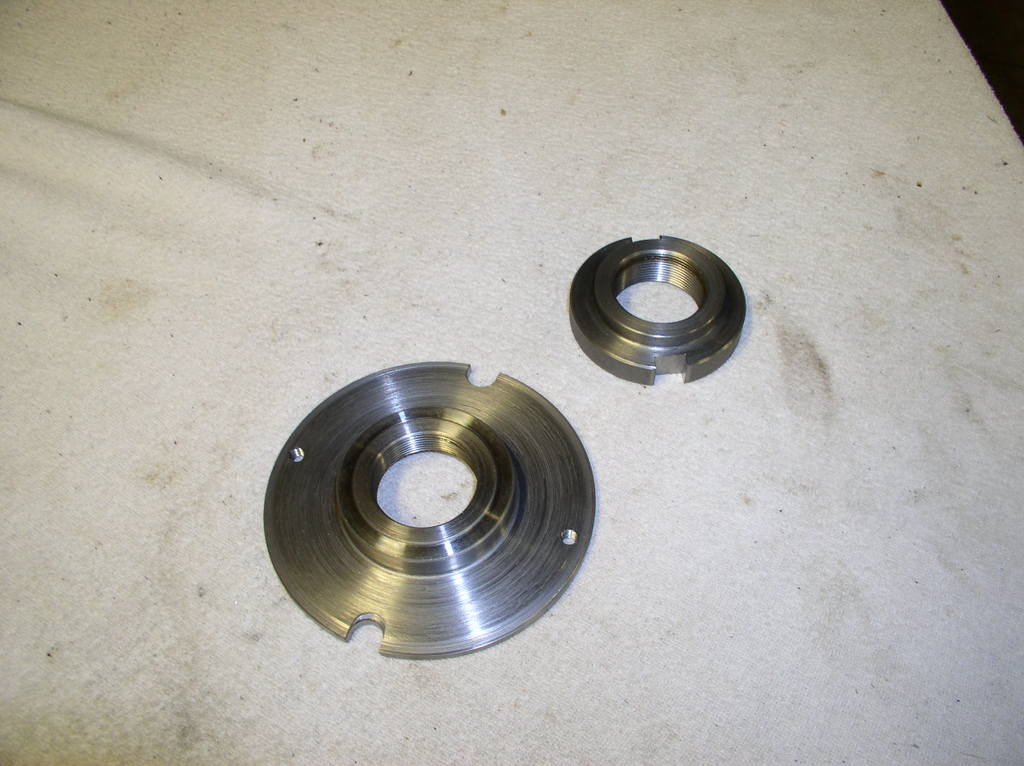

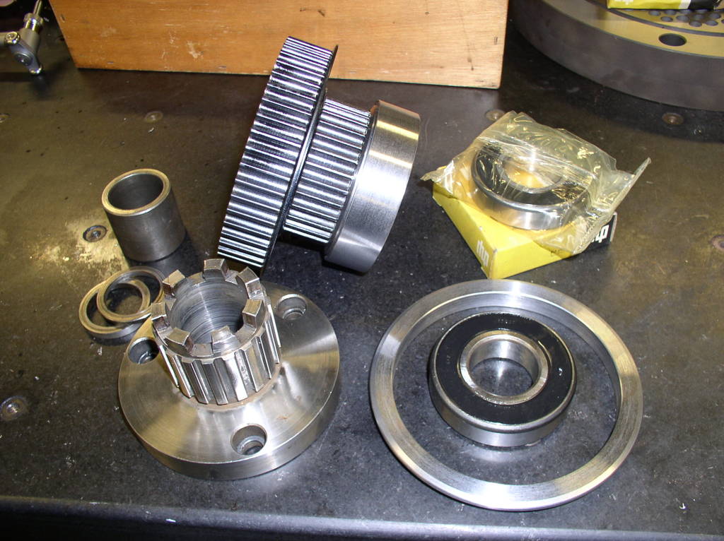

  6. #136
    We had to adjust the coverplate of the top bearing to get some space for the lock nuts.
    I made the two nuts in a way that i can use a SKF wrench .
    one the bottom nut I will connect the speed sensor .
    I also had to make a spacer to adjust the height of the top bearing.
    Kind regards,
    Andre.
