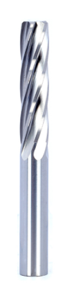

    Been thinking on making a fixture plate with threads and holes for dowel pins for the router.
    Would love to use 6mm dowel pins for aligning/fixture and wondering if this con be done by the router itself. I´ve got a 2.2Kw spindle, would a 5.9mm drill and a caribe reamer like this suit the process? How would you go about making this?

    I would have thought the RPM too fast for a reamer.. Could you not drill therough both pieces in situ and hand ream?
    Ideally I would like to have an array of threads and holes hence the plan to use the cnc.
    Boosting the torque on the VDF I´m able to drill given I stick to small diameters. My thoughts are that maybe by using a short carbide reamer this can be done on a chinese spindle, but would be great to hear if someone has done it already.
    Anyone has experience on this?
    In that case drill a series of holes in piece of scrap then machine each one a slightly larger diameter (4.000, 4.001, 4.002) with a 4mm end mill. Then see which hole has the best fit with the pin and machine your plate that diamater.
