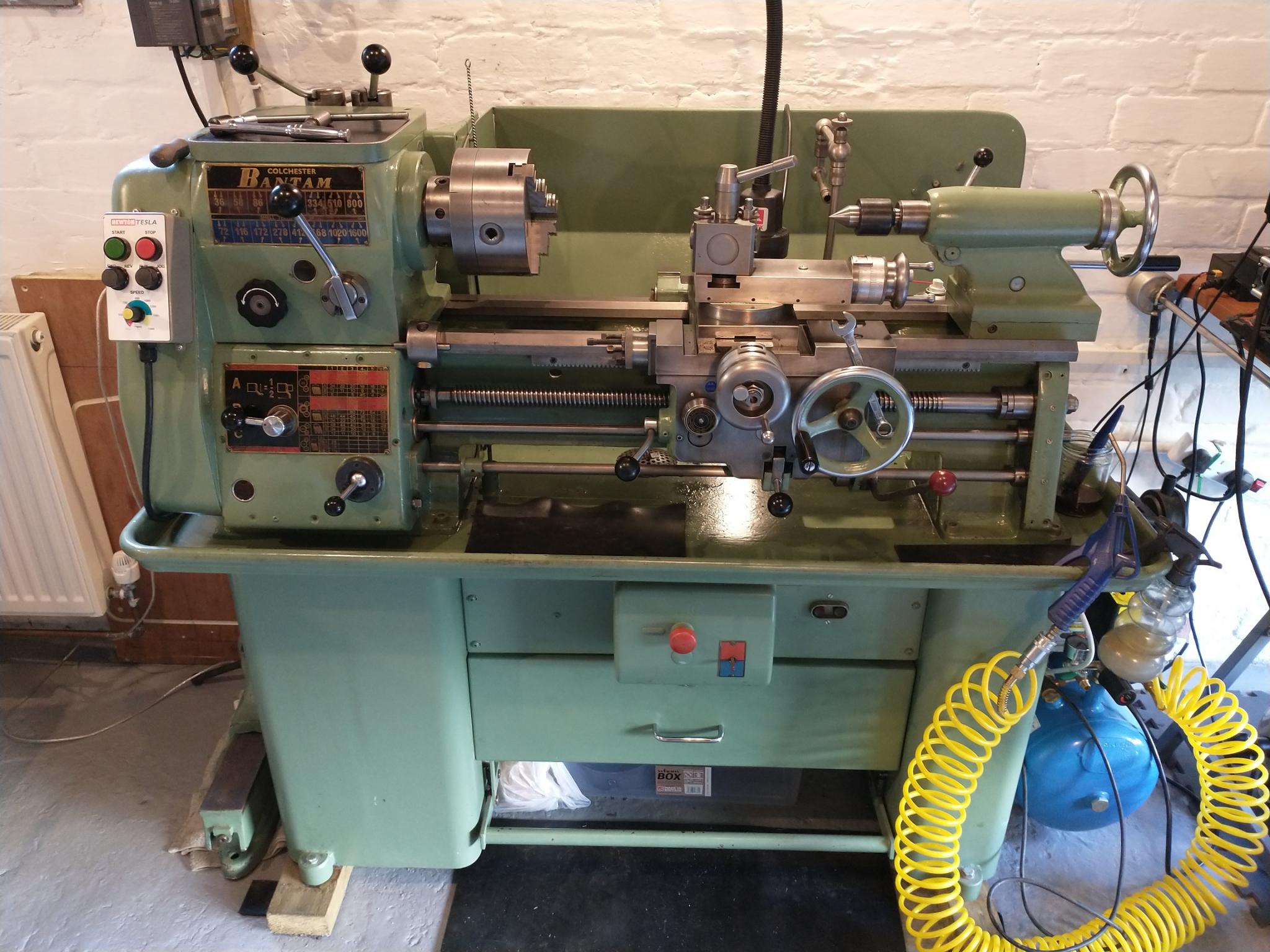

  9. #7
    Just thought I'd share this:
    I have a few more jobs to do including wiring the suds pump (also hoping for some help with that) ,fitting an emergency stop and connecting the foot brake. Not sure I can do that with the VFD though...
