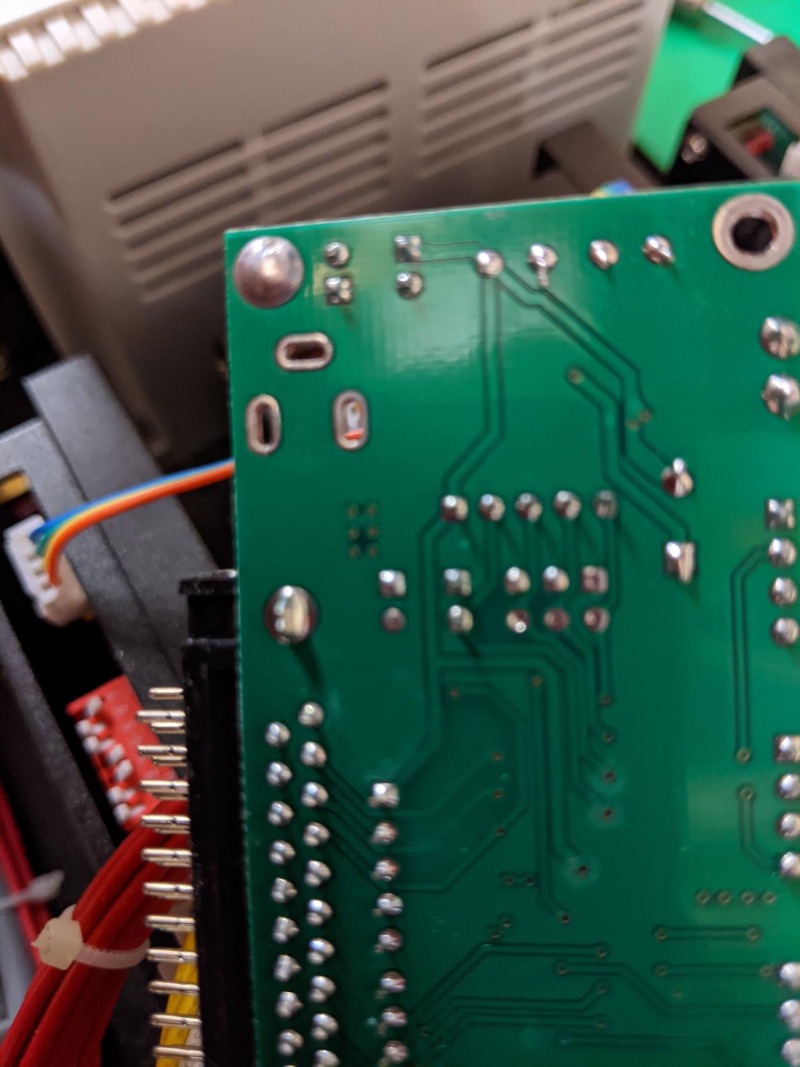

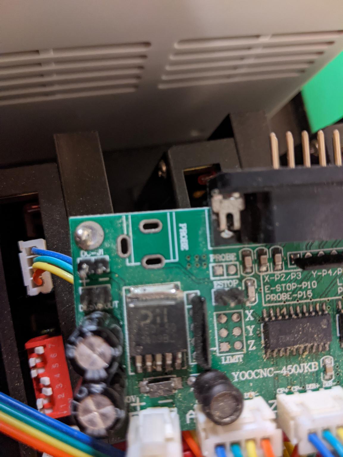

    Dummy back in, a new day, so I will try and post some pictures, my questions are
    1 can I wire home switches to this pub and if so where
    2 corresponding to the hole marked Probe on the back of the case there is some empty holes on the PCB marked Probe, can I solder a socket for one on it and will it work, looking at the underside of the board there is not any tracks from these holes to any components
    3 will I need to alter the switches on the units marked XYZ?
    Regards Richard

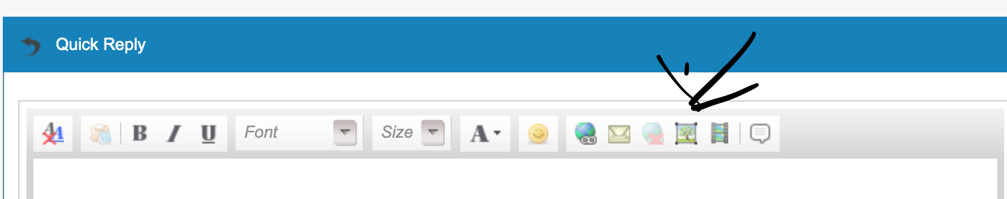

    Sorry for starting another post but it was the only way I could post a picture, as it does not seem to give me the option of how to post another picture on a reply, I can take a better picture with my camera then transfer to the computer to post it, but can you tell me how to actually post a picture without starting a new thread?
    Have you tried the advanced tab?

    OP: You have to acknowledge the image is difficult to interpret, but we can deduce the following:-
    It's a parallel port interface (the big black 25W connector on the left of the image as viewed). That immediately gives us options in terms of a replacement BoB, if necessary, although the board looks to be rather compact - we can't tell if a replacement board would actually physically fit, but we can play with that with a better photo.

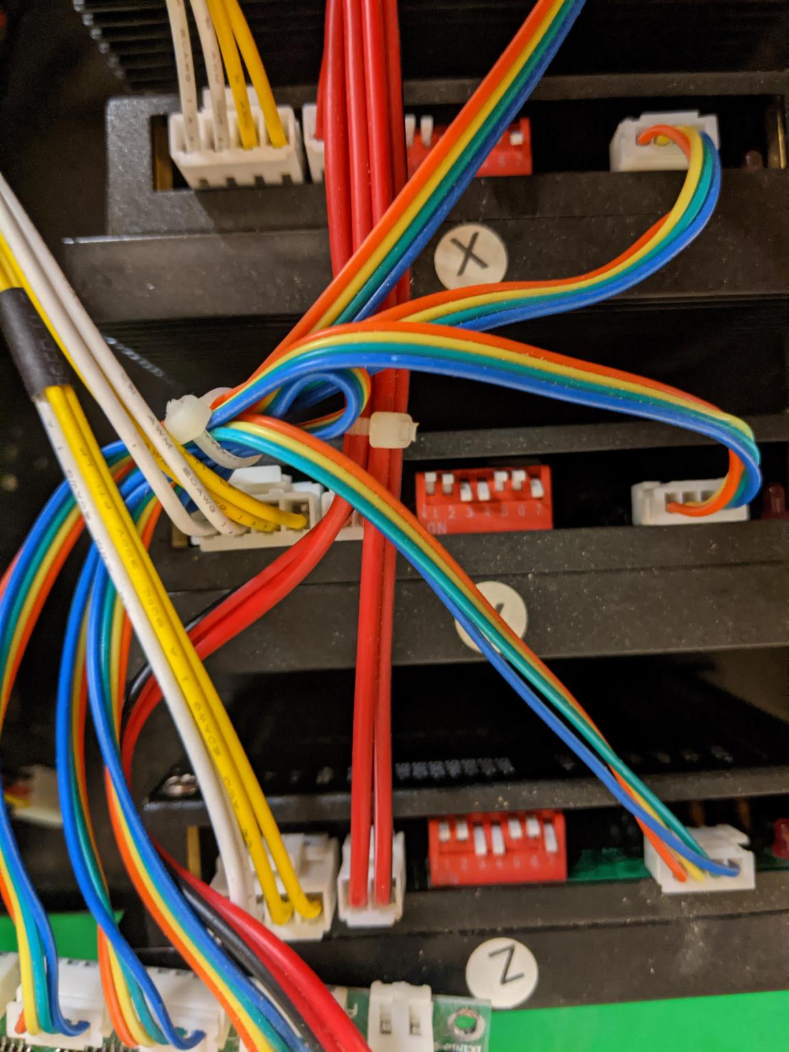

    If I take my glasses off, the image swims into... less focus... okay, worth a try. But, I have to admit that the connectivity to the board appears just to be power (lower right) followed by 4-axis drivers (the four four-wire interfaces above that). And NOTHING ELSE?! The circuitry around the lower-right connector I would guess to be a local 5V logic supply for the board (hmmm, maybe... pretty heavy duty if it is), and board silkscreen printing appears to show a power jack (not fitted), some jumpers - not fitted (although there's a two-pin jumper fit, but can't read the silkscreening around that). What isn't evident are the usual 5x digital inputs - used for E-Stop/Probe/X-Limit/Y-Limit/Z-Limit (conventionally, although can be used for practically any function). Nor any suggestion of the usual opto-isolated inputs to support these.
    We do need a better image and to understand how much you're prepare to play with this. I'm half guessing (through squinted eyes) that the board does not support additional inputs, as would be required for the limit switches. A cheap Chinese BoB will likely work well (if we can work out the pinouts for compatible connectors to the existing wiring looms), and would cost less than a tenner, and give you a more conventional interface. That would work almost as a plug-and-play swap for the existing board - though you'd have to map the new input(s) through onto Mach3/whatever-you-use. It's an option.
    For now though - as much as a buggeration as it is - clear photos would really help.

    Crude arrow pointing to where you attach a photo.
    This is about as good as I can get, I hope this works

    Perfect. However the connectors that you need are not fit to board - just the solder pads for them. That's not bad, it's 10 minutes work to add the connectors if you want to persue this. My question - how's your soldering?
    erm, just a point - the 25W connector is missing it's shroud (steel "D" shaped form that surrounds the pins) - is that still attached to the case?
    My soldering is near on perfect, I have Two temp controlled, fine tip irons, heat sinks etc., just lacking the electronics capability, but was a white goods and small appliance repair person for 50 years, so I can do as I am advised so long as I have some sort of diagram to follow
    The two pin E stop plug is in the loom, I had to unplug it to pull the pcb out
