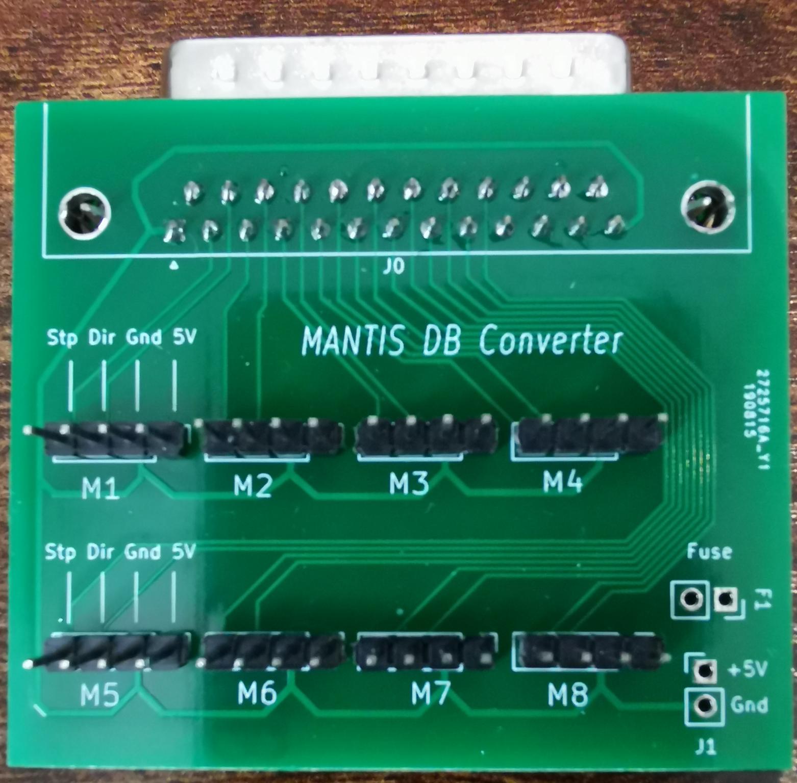

    I've been told it's really useful to add enable/disable switches for each driver on a motion control system but I don't understand how to wire this. I'd really appreciate some guidance.
    Firstly here are the drivers I'm using:
    3DM2283T - https://www.omc-stepperonline.com/di...ice&order=DESC
    DM2282T - https://www.omc-stepperonline.com/di...ice&order=DESC
    DM542T - https://www.omc-stepperonline.com/di...tepper%20Motor
    I'm using Mantis and have a very simple BOB (pictured).

    Don't think I've ever seen manual enable / disable switches for each Axis - I'm not sure there would be a big use case, unless you wanted to manually position an axis for some reason without using Jog and with no care to machine home or soft limits.
    What is commonly done is to wire the enable line up to the controller, so that it can enable the drive when sending it movement commands. I use this as part of my fault system - if one of the drivers or the Spindle has an error, the drives remain powered but are stopped in their tracks and disabled through the enable line. Is that what you're after?

    I'm with Neale on this one - but anyway, we haven't yet actually been helpful about your original question.
    I don't think you need a separate 5V PSU to achieve this - it looks like you've got 5V and Gnd available from the breakout board, and as its a signal line it won't be drawing a large current to worry about. I'm sure a more electronicsy person can chime in and confirm or deny.
    The switches also are quite overkill - I wouldn't expect the illumination to work on 5V DC at these currents as its designed for 240V AC, so you might be able to find yourself something simpler. End of the day though, they're switches so will function.
    Should be as simple as ENABLE - wired directly to GND, and +5V via switch to ENABLE+. Hopefully one of those electronics boffins will tell you if you need a pull-down resistor or not. You may need to tell the drive that you want to use the ENABLE signal, most of them ignore it by default so that people can leave them disconnected. Your stepper driver manual should give some details on this.
    Each stepper driver I've disassembled (okay, all three of them) have had a cheap, slow opto-isolator input for the enable line, with a series resistor around 270R that's set up by default for 5V switching. So, yeah, as Andy says, apply +5V/0V to the EN+/EN- inputs to disable the stepper driver (/axis).
    As both Neale and Andy say, though, unusual and specific wiring choice.
    Also, as Andy says, those switches incorporate a neon indicator which won't work at these low voltages, rather 220VAC.
    Thanks for the replies. Please bear in mind I'm very new to this but perhaps the confusion as to the usefulness of these switches is the difference between a CNC machine using multiple linear axis' (XYZ) vs the motion control machine I am building to control a video camera.
    I am only using one linear axis which acts as a slider. All other axis are rotational motors which are used to control; focus, zoom, pan of camera, tilt of camera. Then there is another motor which is used for a large rotating table. Finally, I'd have two other optional motors (8 in total) which I could use for other tasks, things like; moving a piece of the set, moving a product, throwing liquids. Motion control video can get very complex but it's quite different compared with CNC machines although the components are generally the same.
    Given the above, I'm not sure, although again I could be wrong, that home or limit switches would even work. I can see how they'd work on a linear axis but not on the others. That may be due to my lack of knowledge though. As such, maybe this is where these on/off switches come in handy? Maybe...

    Limit switches are never a bad idea if you can make them work for you; I would hate to see a motor destroying a camera focus mechanism by trying to power it through an endstop for example.

    I wouldn't worry about adding limit switches or home switches, as any kit used should be able to resist a stepper motor stalling.
    I've got no idea how Mantis interfaces the BoB with the KFlop, but there are pins on the KFlop that should be able to control the enables directly.
    If you're unsure, it's probably best to post over on the Dynomotion forum, as the man who designed the KFlop will give you a definitive answer.
    And for those wondering what Mantis is - https://www.bfg-motion.com/index.php?p=1_4
    It's essentially just a computer program connected to a KFlop that lets you control 8 axes simultaneously. It's not really anything that complex, just a nice bundled package that's pretty easy to use, aimed at photography/filmography purposes so you can repeat scenes.
