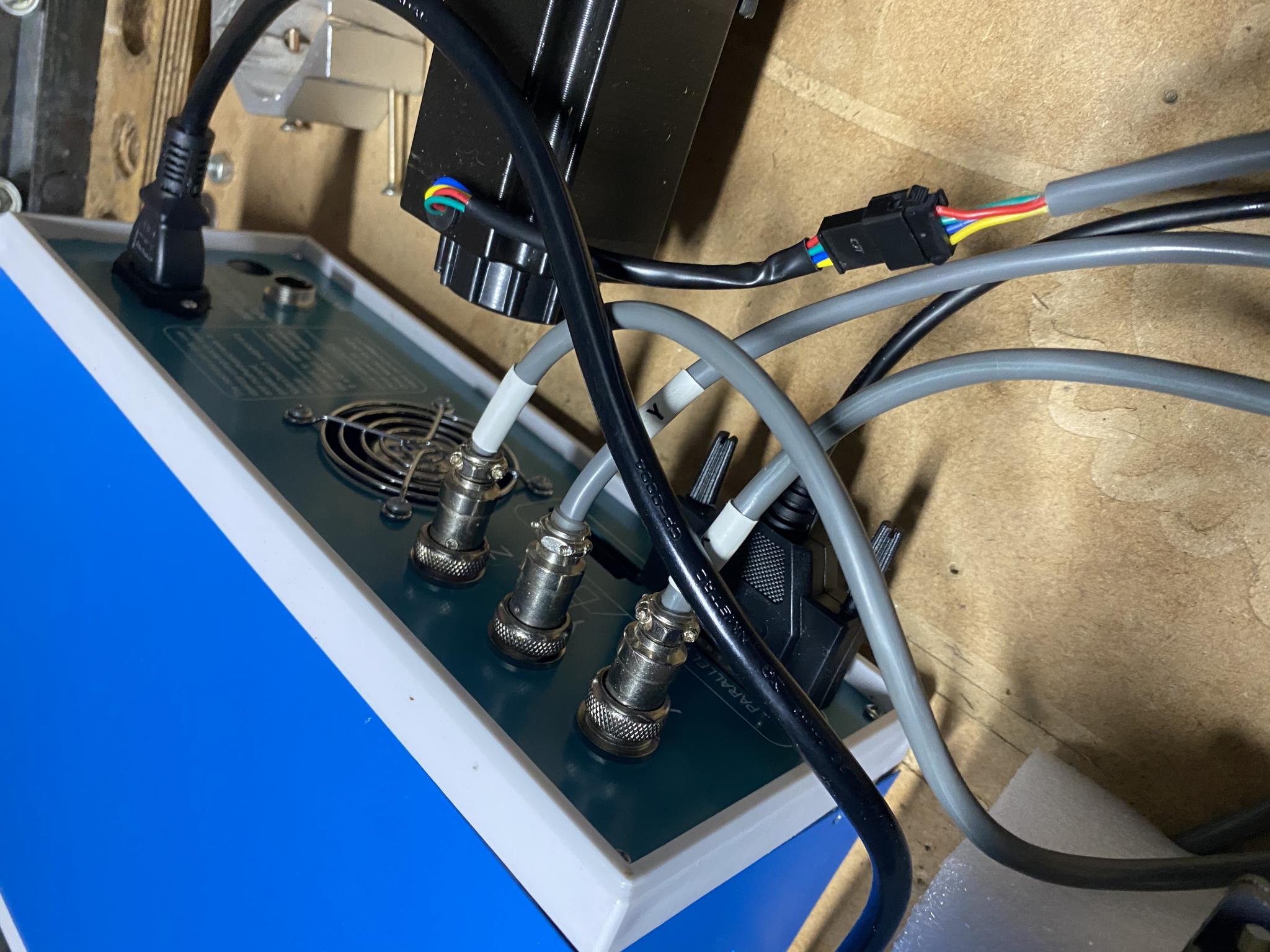

Ok so I have the control box and the VFD all hooked up and have power going to both of them. I can start the spindle up and control it with the VFD. I have a parallel port to CNC connection which I have inserted and I have downloaded mach3 and CNC usb. I would prefer to use the mach3 if I can as it’s easier to use. I followed the set up videos for mach3 and it’s not working. There is no power to the motors. Next problem to overcome ?? Anyone got any ideas ??

Do I need to plug in Via parallel port or can I run with CNCusb ?? I don’t really care how I go about it. I’m just looking to get it set up as best as possible and as fast as possible as I have projects coming up and this is my only machine lol if anybody is in the midland I will happily pay for anyone to come and sort it for me. Thank you again for any help and guidance

You mention CNC USB - if that's the software from PlanetCNC - do you believe that this is compatible with your 6040? It's unusual to support that, and Mach3, and the board doesn't appear to be a PlanetCNC board.
Getting spindle speed control is generally straight forward if the board (Breadout Board, "BoB") supports this - but the images you've provided to date are not very clear. If supported, you'd have to change two parameters on the VFD as well (allowing spindle forward/reverse control over external wiring, and allowing spindle speed control over external wiring) to support this - that's straight forward, but you have a bigger issue of getting Mach3 working first.
You mention the spindle speed control through Mach3, but in the next breath mention motors (plural) not powered. I expect you're talking of the 3 axis stepper motors? Have you no control from Mach3 at all?, and are the motors unpowered (you can rotate them by hand), or just not moving (they've be very difficult to turn by hand if powered, unmoving). It's unusual, however, for the steppers to be unpowered outside of an e-stop situation.
It could be useful to explain exactly where you are here - it sounds like you've possibly recently obtained this machine - we need to understand your starting point, and what you have working, and how much you understand. I'm forming a view but it's too easy to overlook or guess at missing information.
