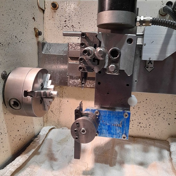

    I am wary of QCTP with an aluminium base, as most of the cheaper ones seem to be.
    I got the all metal ones .
    Dickson style but Size T37. Beautifully made in the far east, but they will probably be OK

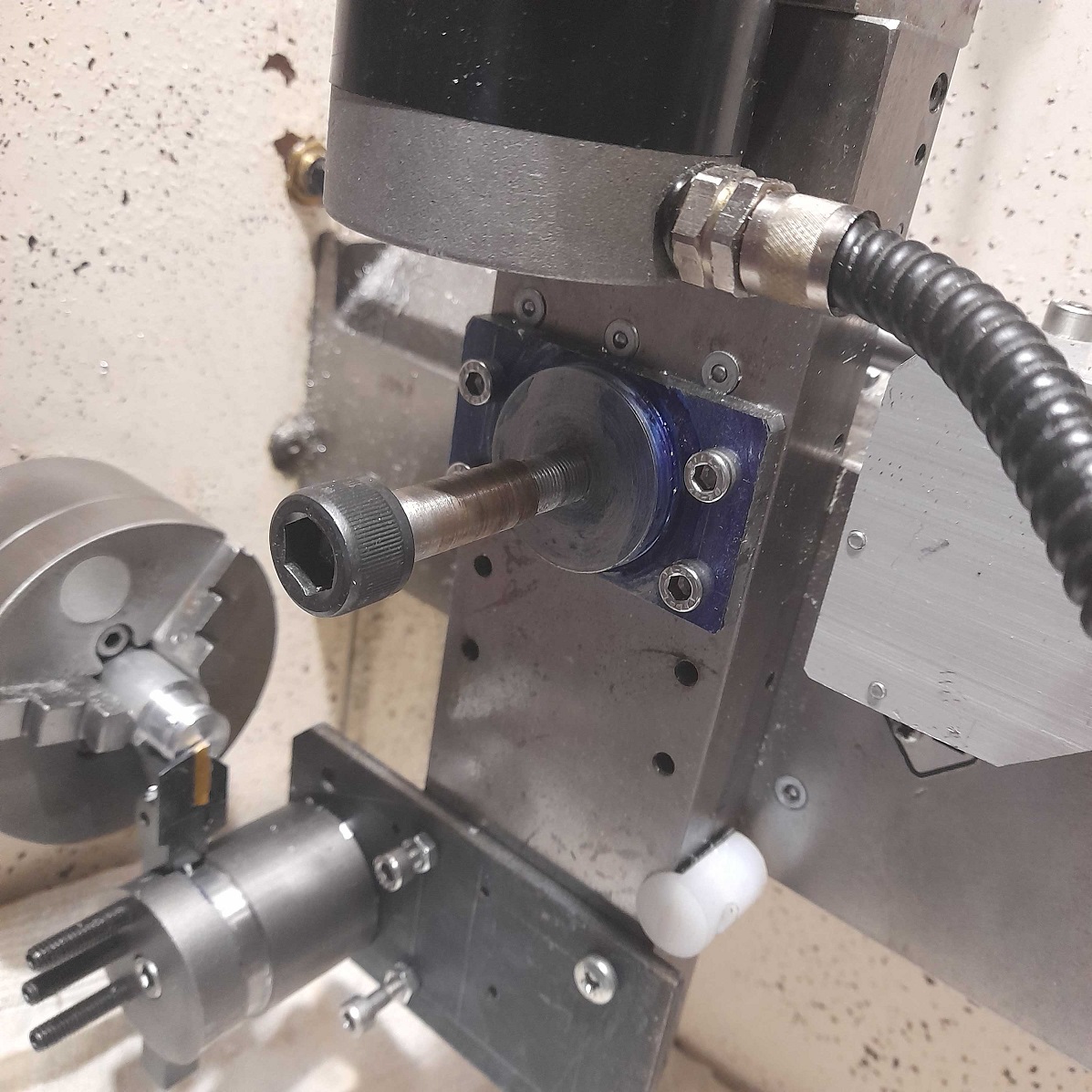

    I could send you some pics William.
    Am just in process of adding a rear toolpost for parting off (but this is a self made item)
    Hi John,
    some pics would be much appreciated.
    thanks, william
    Will get you some pics shortly William , when I get the hang of this new phone with 48Mp camera
