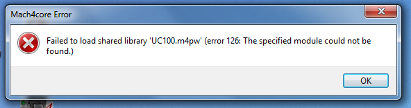

  1. #21
    So this is now winding me up
    I have installed the plugins and they now appear in my M4 plugins file
    But I have restarted my computer (and M4) and I just get the message as follows.
Name:	error message.PNG
    I have just tested this on my office computer but of course no UC100 device is connected
    On the workshop machine (where a UC100 is connected ) I do not get the error message but when I select to configure/select motion device then UC100 does not appear as an option .
    I only see "simulation device" which i presume is part of the M4 software as supplied.
    So where do I find the wisdom which will tell me what I am doing wrong

  5. #25
    " MAke sure the .net framework 3.5 is installed (enabled in the Windows features on Win 10.)
    Run the UCx00 automatic installer application, select MAch4 and select the UC100 if you using that.
    Make sure to plug in the UC100 to the computer's USB port. (You can also verify that the USB drivers were installed properly with checking the Windows device manager.)
    Run Mach4
    Enable the plugin in MAch4.
    Select the UC100 as motion control device in MAch4.
    Enjoy. "
    Unfortunately it didnt work!
  6. #26
    OK
    so sent a query in to Artsoft . Mach support supplied a remote connection link and while I was having my dinner the problem was resolved in my absence . Came back after dinner and a notepad message told me UC100 was now connecting.
    I will ask tomorrow if they can tell me what was wrong for the sake of others who may have similar probs .
    I will now embark on the configuration process, but already I have the tool post whizzing about at silly speeds . Probably need a bit of motor tuning but that will be tomorrow.
    Thanks to all that have tried to help . Will come back if I can get more info on what I might have done wrong.
    Meantime I will continue with configuration and motor tuning then maybe see if I can do spindle pulleys and threading.
    Watch this space
    John

  8. #27
    So it seems I did not enable the plugin.
    Now I have to say that finding your way around Mach 4 is anything but intuitive so that is my excuse .
    This is not helped by the simple fact that the manual applies to the 2014 version, and version 2 of M4 which has only been around since early 2018 has not yet had an updated manual produced.
    So you try working through the old manual , and find the various configuration pages in the current version bear no resemblance at all.
