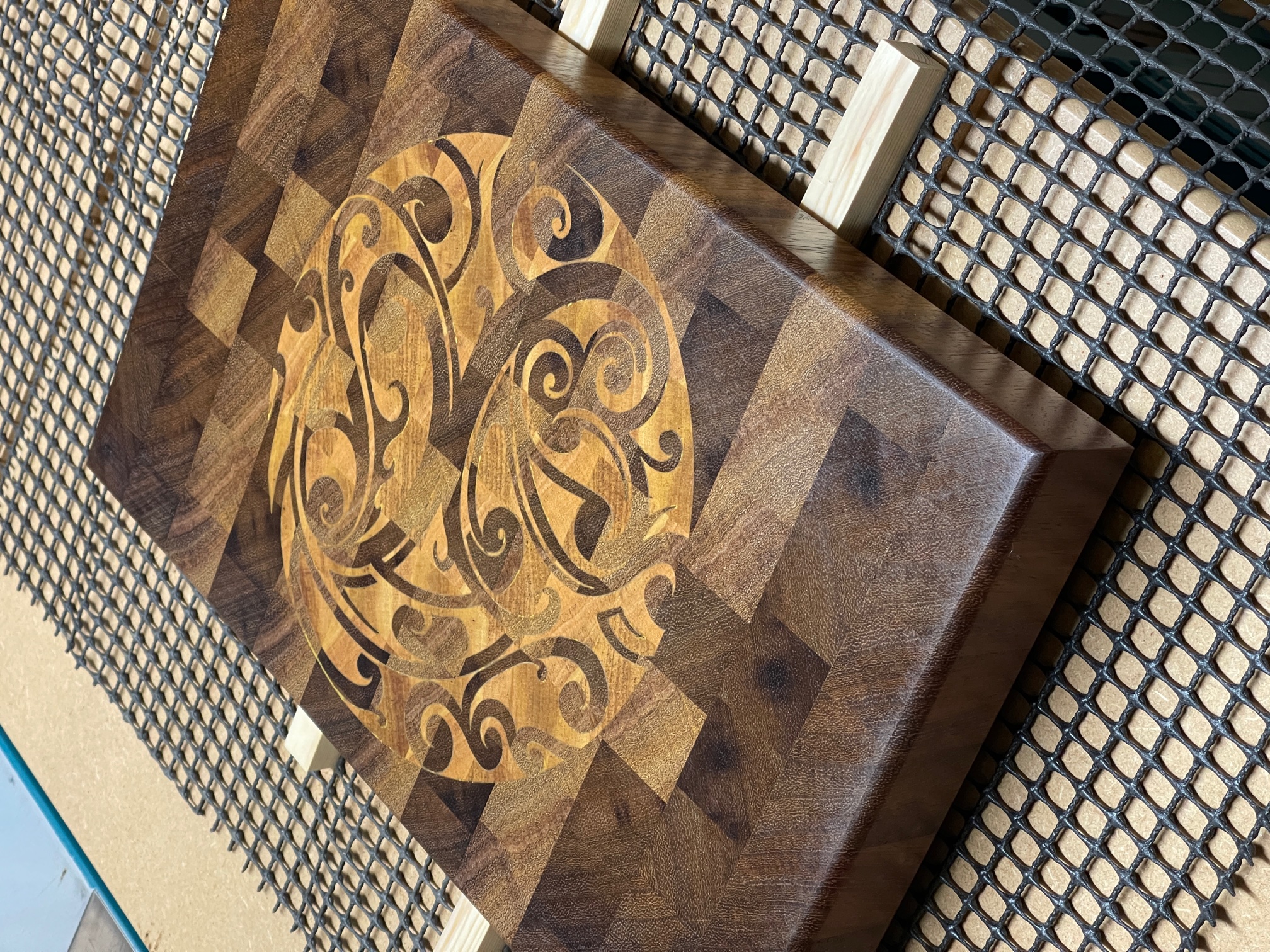

    He should have tried my concrete feet idea! Anyhow, apart from the usual bit holder, colett holder, box etc, here is my first proper effort. Lots of learning points to get me moving from acceptable to perfection but I’m now on the journey!

    Well, Sir all I can say is Wow, with only a week's experience using a CNC machine you should be massively proud of that and I can't wait to see what's rolling off in a year's time. .

    I'll add a 'Wow!' of my own, that's brilliant. I know the Aztec calendar is a popular test but it's the ability to cut out pieces like this that will fit together properly that really tests the accuracy of your machine's geometry. I'm hoping my own contraption will perform reasonably well in this respect once I finish putting it back together.
    Re the vibration: it's the accelerations that cause the trouble (apart from shoving sheets of MDF through doors, of course). Different control software has different properties re how much 'jerk' you get, something to do with how many derivatives of the rate-of-change of direction you put in the maths. I was never that hot on calculus. Reducing accleration settings will reduce the gyrations but slow down your cutting of complex shapes.

    Lovely inlay in that end grain chopping board, Pilsbury. As Kitwin says also a pretty good test of the machine too. What sort of feeds and speeds did you try?

    The 3mm EM I ran at 18000rpm and 3000mm/min. 3mm deep cut. Seemed to sound fine to me. But really I have no clue what I’m listening for��. The 15^v bit again 3mm cut and 18000rpm but lowered to 2000mm/minute. Absolutely zero method to my madness!
