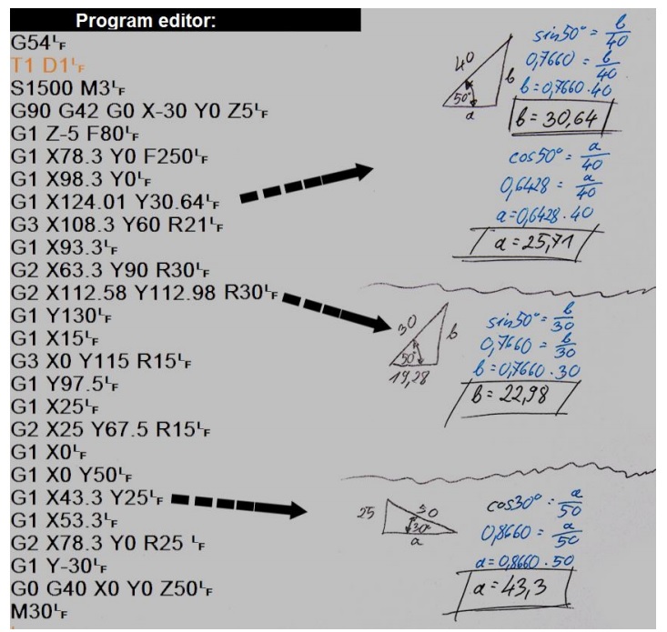

    I have a problem with rays, arcs.
    I made the first example myself using g2 / g3 / R
Name:	R RYSUNEK.jpg
Name:	R RYSUNEK - CNC G CODE.jpg

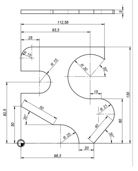

    In the second example, I am supposed to use I, J
    I am looking for some materials but they are hard to understand for me.
    Does anyone have any material on using I, J for arcs and radius
Name:	I J RYSUNEK.jpg
    Please write some code for this drawing
    Use the I, J functions maybe then on this example I can understand how the commands work
