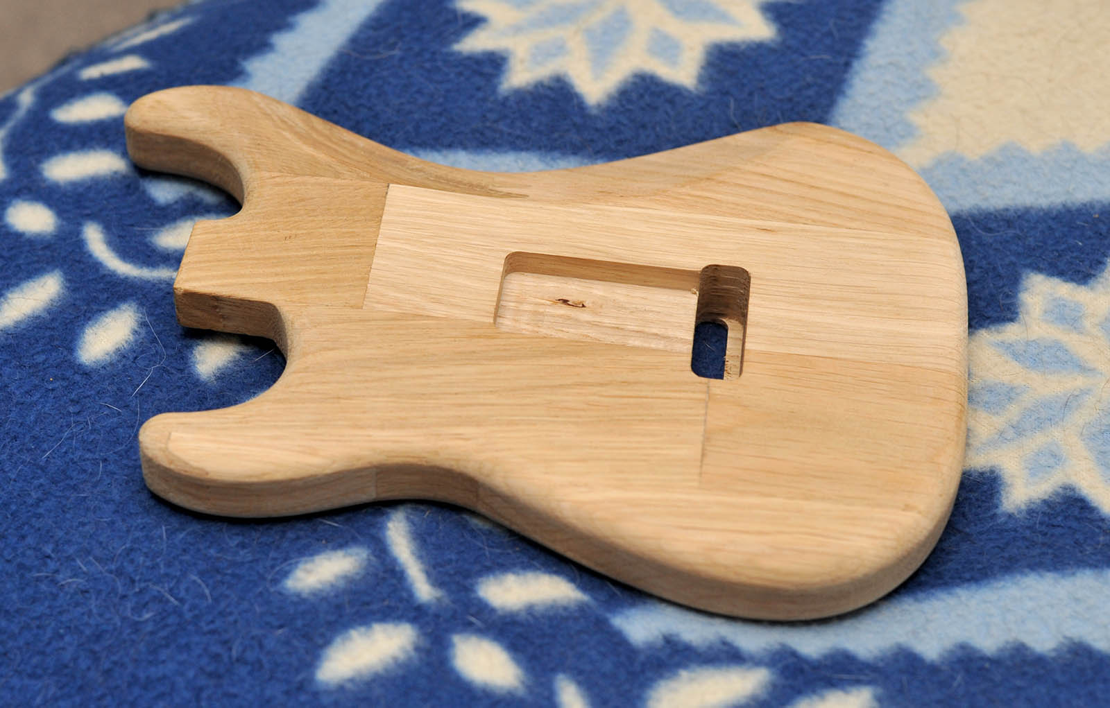

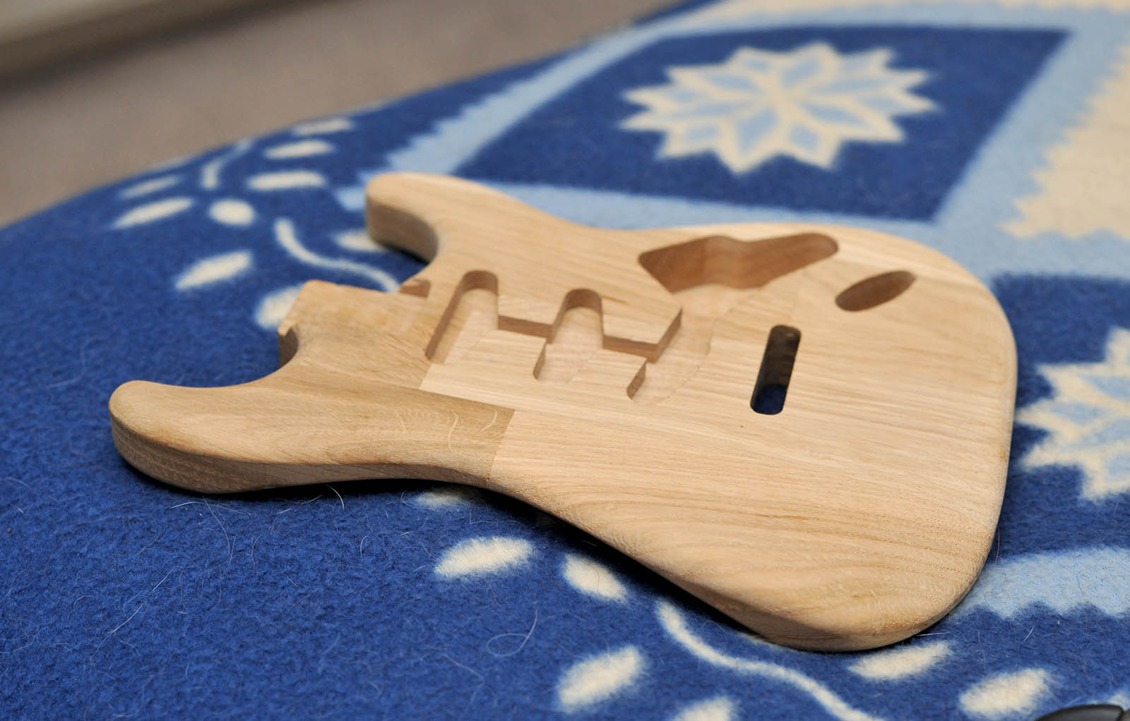

    Hi there,
    I managed to find a few hours to jump onto my new machine and have a go at some two sided machining today. I followed some tutorials on how to set up my stock and workspace for two sided machining using 5mm steel dowels as locating pins so that everything lines up nicely when I flip the blank over and machine the top of the guitar after having done the back. It worked better than I had hoped and its given me the confidence to have a go and try something full size in the near future !!
ID:	29823Click image for larger version.

    That's a great looking mini strat body, I'm looking forward to seeing and hearing the finished full-sized instrument. What software are you using for this?
    Kit
    PS Unfortunately one of the things you CANNOT make with a CNC router (even a JAZZCNC one) is a pair of EL34s.
    Hi Kit,
    Thanks for the comment. This one done in Fusion 360 , imported the model as a step file and created the G Code in the Manufacture side of Fusion.
