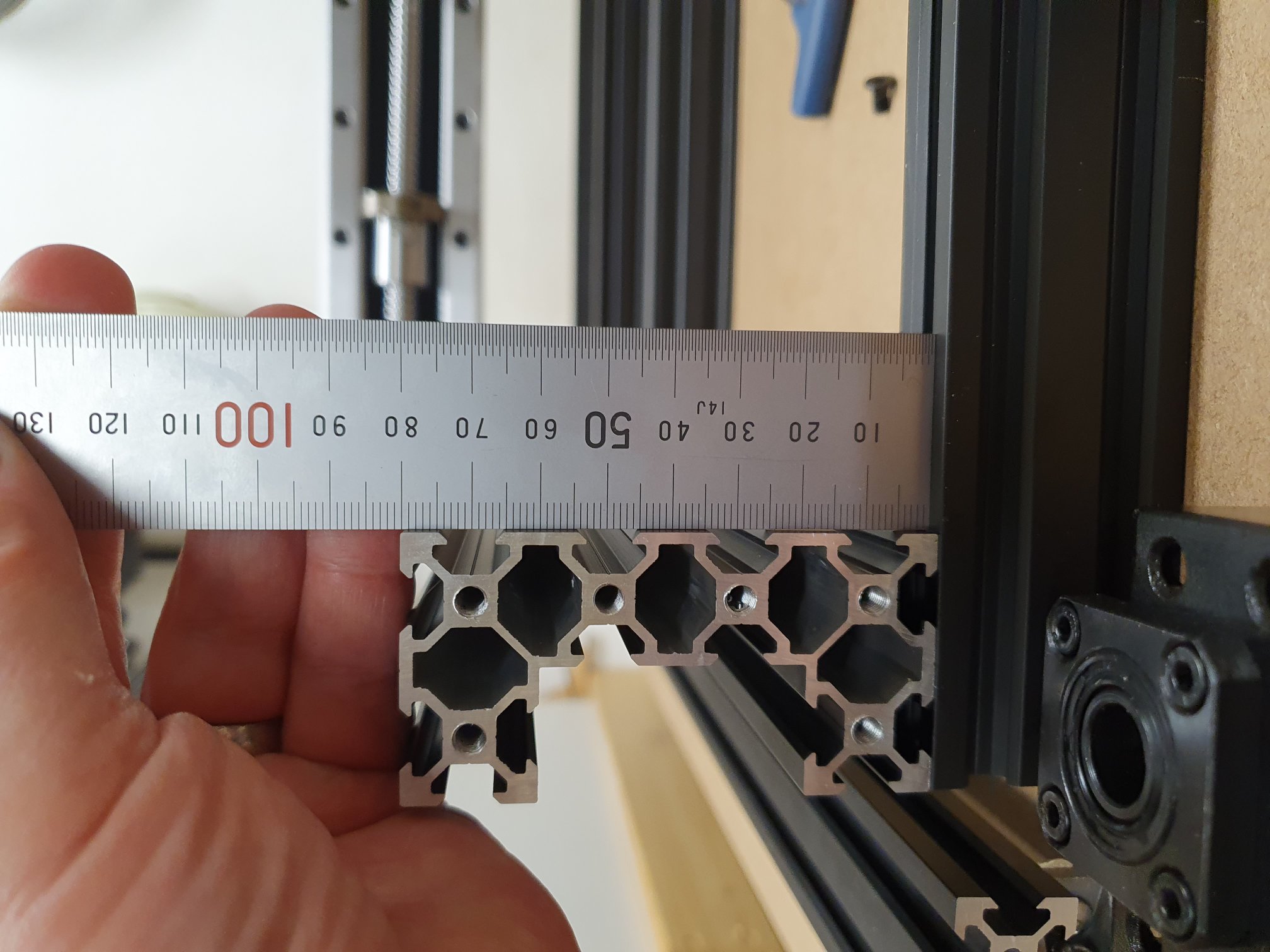

    Are all your profiles 40x80? I tried to catch up a bit and went back in history to try to figure out what you actually bought for parts, but to be honest, I failed. I don't know which parts you bought, or if you just bought a drawing or a complete kit with some modifications of your own. Somewhere else you posted a link to this machine from cnc4you:
    Attachment 30144
    Is this similar to yours? Now, I have no idea about the dimensions here, but it looks like mostly 4x120. As you can see, the BK/BF of the X screw is placed over one groove, the picture shows clearly that the BK/BF is fixed through drilled holes in the extrusion between the grooves. That is also possible to do as a solution, but if you have only 40x80 all the way then you have bigger issues. Anyway, it is not clear to me at this stage what you actually bought, how the parts are meant to be installed or what the actual problem is, other than the fact that the BF/BF won't fit into the grooves. In any case, if 45x90 is not working, perhaps 40x120 would work. It adds some costs, but surely, not nearly as much as Ģ800 because I am pretty sure you could save and use most of the stuff, depending on the design. Never the less, it would be a good idea if you posted some pictures, it would help a lot in the discussions. Anyway, if you buy new extrusions I can recommend you buy it from DOLD Mechatronic. They have good prices and fast delivery. Some extrusions won't cost you an arm and a leg, and you can easily cut them in your workshop.
    I think that the 20 rails are MUCH better than 12, which in my opinion is only suitable for 3D printers, so in my opinion that's a good choice. I also think that using a smaller than 1605 screw is not a very good thing. 1204 may work, but not on such large machine. I am using 1204 on one of my 3D printers. 8 mm ACME is a joke for this sort of thing, it is suitable for 3D printers, but not a large CNC.
    If I were you I'd try to make something out of the parts you have, even if in the end it will take longer time. What's been said several times and in several forms is that you must make as a minimum, some sort of plan on how you want the machine to look like. If you do that in a CAD software, that's fine, but it is my understanding that you don't want to do that, so the absolute minimum is to take a piece of paper and a pencil and start sketching, measuring and making drawings. I think Jazz misunderstood my comments, because it sounds like he thinks I am against using software, which I am not. In fact, I do use several, but not for machine design and machine assembly simulation. Even though I am not using any machine modelling software, the mistakes you made would never happen to me, not because of CAD or no CAD, but because I do read specifications, look at technical and mechanical drawings, check dimensions, make sketches and measurements and so on. I think that it is ABSOLUTELY necessary that you do that as well, otherwise your build will be extremely expensive and may end up in the garbage if you just ignore things and assume that it will work out somehow. I don't know what sort of things you have made before, but you seem to have a very large and luxurious workshop, especially compared to mine, so surely, even if you only worked with wood before, you must have made many drawings for whatever you made. I am not a wood worker, and my last wood project was two very simple birdhouses, but I made drawings even for those before I bought the material and started cutting up. So yes, drawings are VERY important according to me, but machines were made long before CAD software was invented, so that is not necessary at all. The type of table CNC we normally build is actually a pretty simple machine compared many others which can be made without and CAD software, so that is not required, but careful measurements and drawings are definitely necessary.

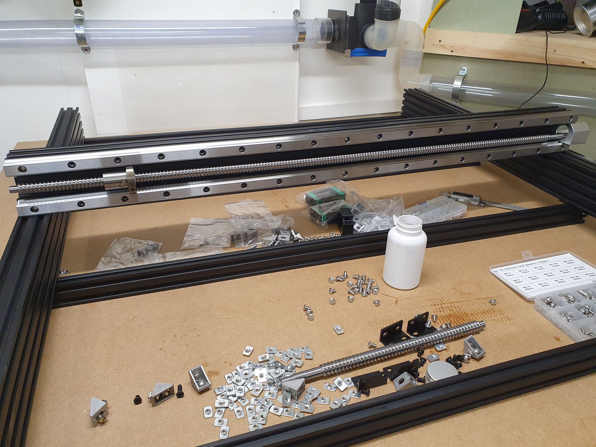

    OK, open to suggestions - i did have an idea!! an outer plate and an inner plate - how the bloody hell i was going to make them though?
    However, before we or I can help you further will need to give me a detailed list of what you have and the length and dimensions. Either post it here or drop me an email and I'll help you get this together. YOU ARE NOT GIVING UP..
    All my extrusions are exactly 1000mm
    All my linear rails are exactly 1000mm
    All my ball screws are exactly 1000mm
    You kind of see my problem - i can understand how the 'linear and ball screw kit worked - but it was never for my profile of extrusions!!
    To be fair (as I like to say!) why would i not assume that the ball screws would be longer, they are when you buy them separately
    Oh, just to make you smile, laugh or cry? Why did no one tell me that if you take the nut off the ball screw, that all the bearings fall out! What a crap design

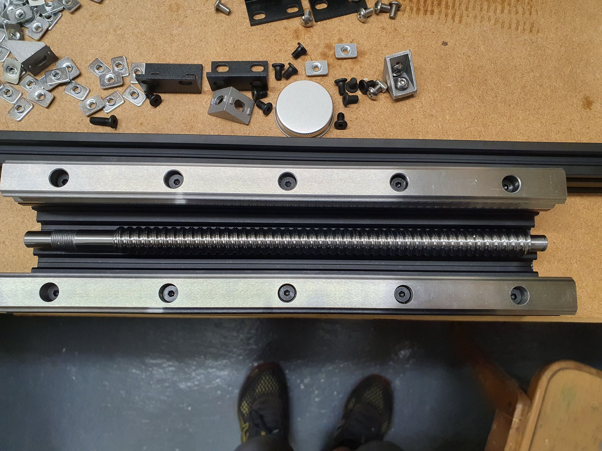

  4. #24
    Quote Originally Posted by WoodKnot View Post
    WoodKnot

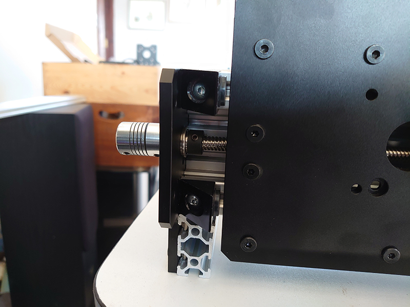

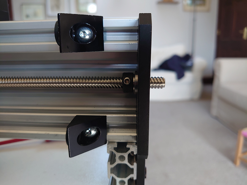

    I do see the problem
    A. you can't attach the stepper coupling
    B. It wont reach each bearing also :(

    We need more details.
    What profile are the extrusions?
    What size are the rails? 20mm?
    What size are the ball screws, what type of ball nut is fitted, and what support bearings are fitted?
    Either links to what you've bought, or some photos will help us provide suggestions.
  8. #28
    WoodKnot
    I actually don't see the problem with those lengths. With those lengths you can indeed get the full length movement, which is 1000 - 160 = 840mm. There is no such rule that screws must me longer than the rails. As I said before, it depends on the design, but you always lose at least as much as the carriages take (normally more) so why would there be a problem? The 1605 should be machined like this:
    Attachment 30161
    So from the full 1000mm you lose 11 + 39 + 15 = 65mm which means that you have 935mm movement and that is more than enough for your 1000mm rails. ...but you can't build that on a single 80mm wide extrusion, so you have to come up with a better solution. Anyway, we need more details, MUCH more details.
    If you absolutely want longer screws, one solution is to cut off a bit of the rails. The length is easy to shorten, just use an angle grinder. But like I said, it isn't necessary to have longer screws at all.
    I think by the way that I indeed mentioned NOT to remove the nut, and be careful when installing the carriages because the balls will fall out. But... if that happened, you could collect them all, clean everything and assemble all together again. It may take time, but no big deal. I think you can even buy balls only, in case you have lost some. Here is an example of a seller:
    https://www.aliexpress.com/item/1005001533634944.html but DONīT buy any without you checked carefully the size and know if you really need some. Note that I have nothing to do with this seller and never had to buy any yet.

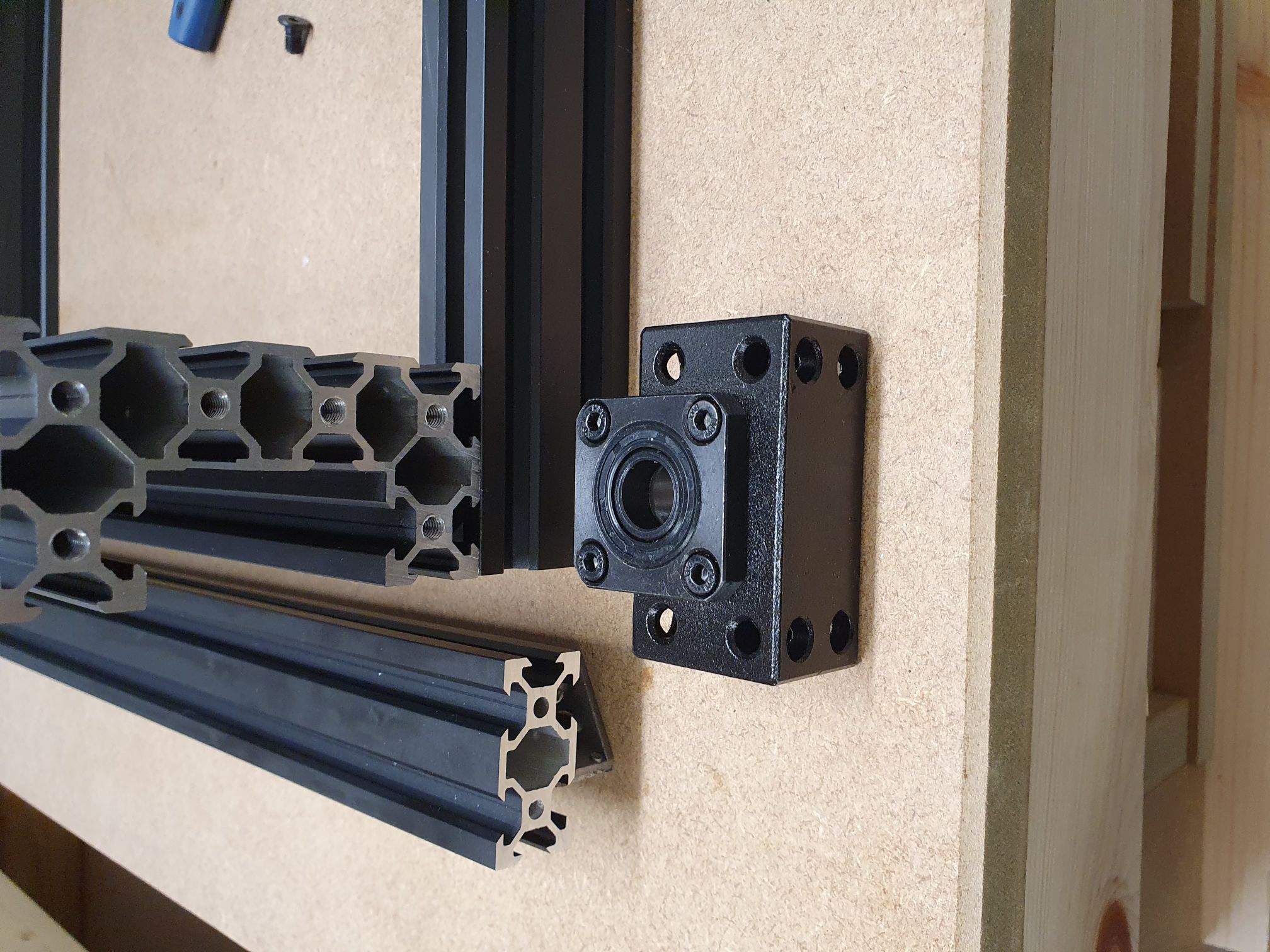

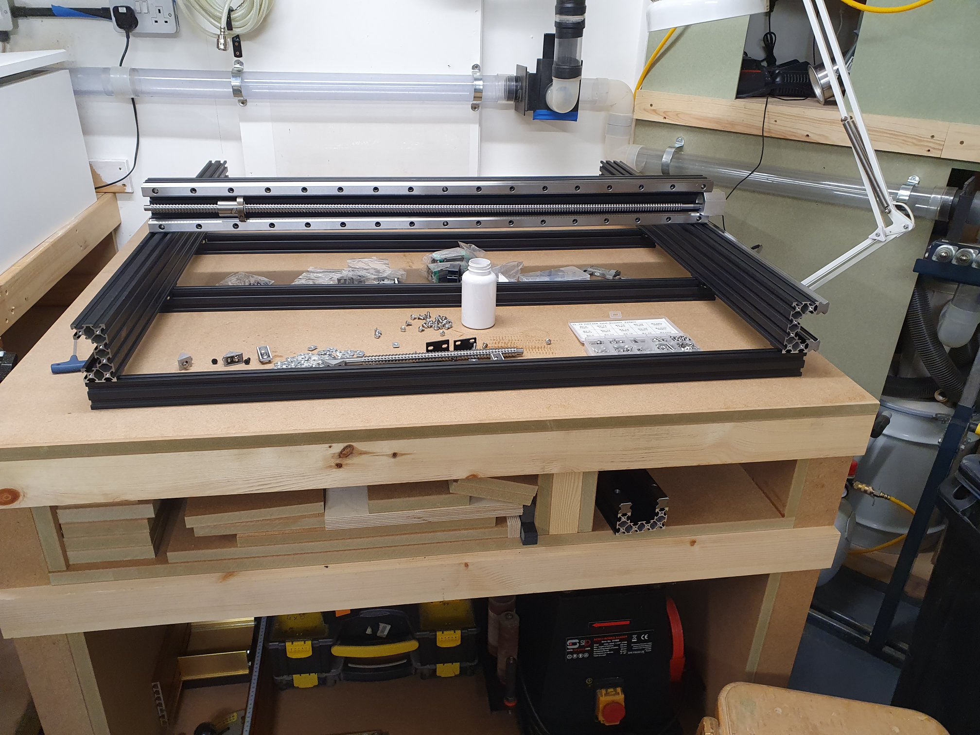

    Hello all, not had a chance to read any threads yet, but have at a few Images.Click image for larger version.
ID:	30162Click image for larger version.
ID:	30163Click image for larger version.
ID:	30164Click image for larger version.
ID:	30165Click image for larger version.
ID:	30166Click image for larger version.
    Have to take dog out for his evening walk, catch up later
    WoodKnot
    Carpe Diem
  10. #30
    OK, I have read everything that has been said so far!
    All the machines that I have seen, watched, use this profile, on wheels, no rails, many belt driven and they knock out some nice stuff.
    I know that you have all said they flex, so how are they managing it. Many make 1500mm x 1000mm machines from this stuff!
    I thought by putting some HGR 20 linear rails on, that would introduce a lot more rigidity into the build
    Most of the upgrades that people are doing is that, but often using 12mm rails and occasionally 15mm rails.
    Most are still using 8mm Acme ball screws, I went for Rm1605, so twice the thickness.
    Yes, I have seen the issues with long 8mm screws 1500mm long, I believe you call it whip or something else?
    So I have exactly 40mm to play with between the rails, less the HGR20 carriages.
