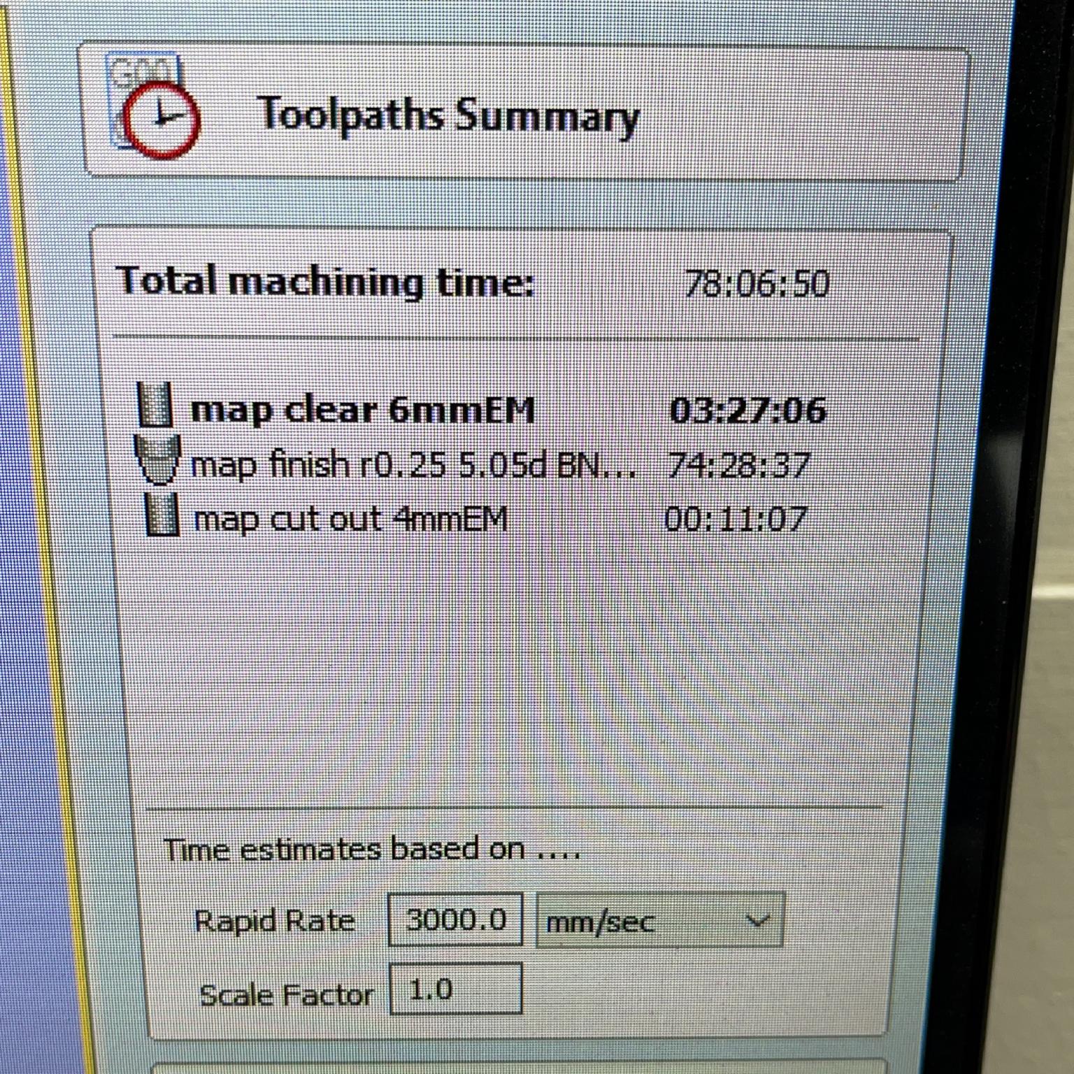

    I’m now doing a bit more..... a lot more in fact. Probably not efficiently either! Basically I’ve got a predicted 72 hour cut with a 0.25mm tapered ball nose endmill with an 8% step over. Project is 800x450mm so I can only imagine the G Code running into many millions of lines!

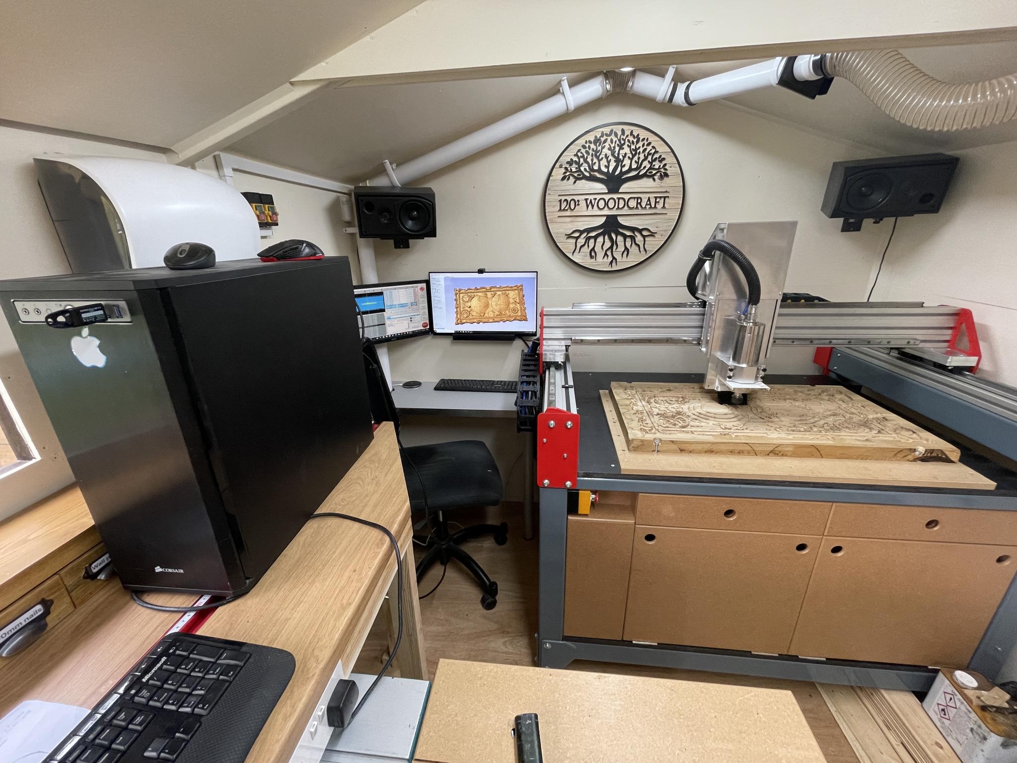

    Thanks all for the advice. Kind of limited in upgrading the PC. One of those very small form factor jobbies that can’t take more than 4GB ram.
    Tomorrow I’m going to shift my home pc out to my workshop and hook that up. That will certainly answer my question if it is the PC that’s the issue. Although it too is a few years old it has some decent grunt and chomps through HD and 4K video editing like butter.
    All sorted. Had to wheel out the big gun for this - a core2 duo with 4gb ram doesn’t cut the mustard.... new cnc pc is needed. Click image for larger version.

    Before you go too far it might be a useful exercise to go through all the parameters you have set for the machine.I seriously doubt you will be achieving rapids of 3000mm/second.I don't think I have yet met a machine that rapid.There could be something in the mix that isn't helping.
    Yes. I spotted that. Just an error in setting the time calc. Machine is set for 3000mm/min.
