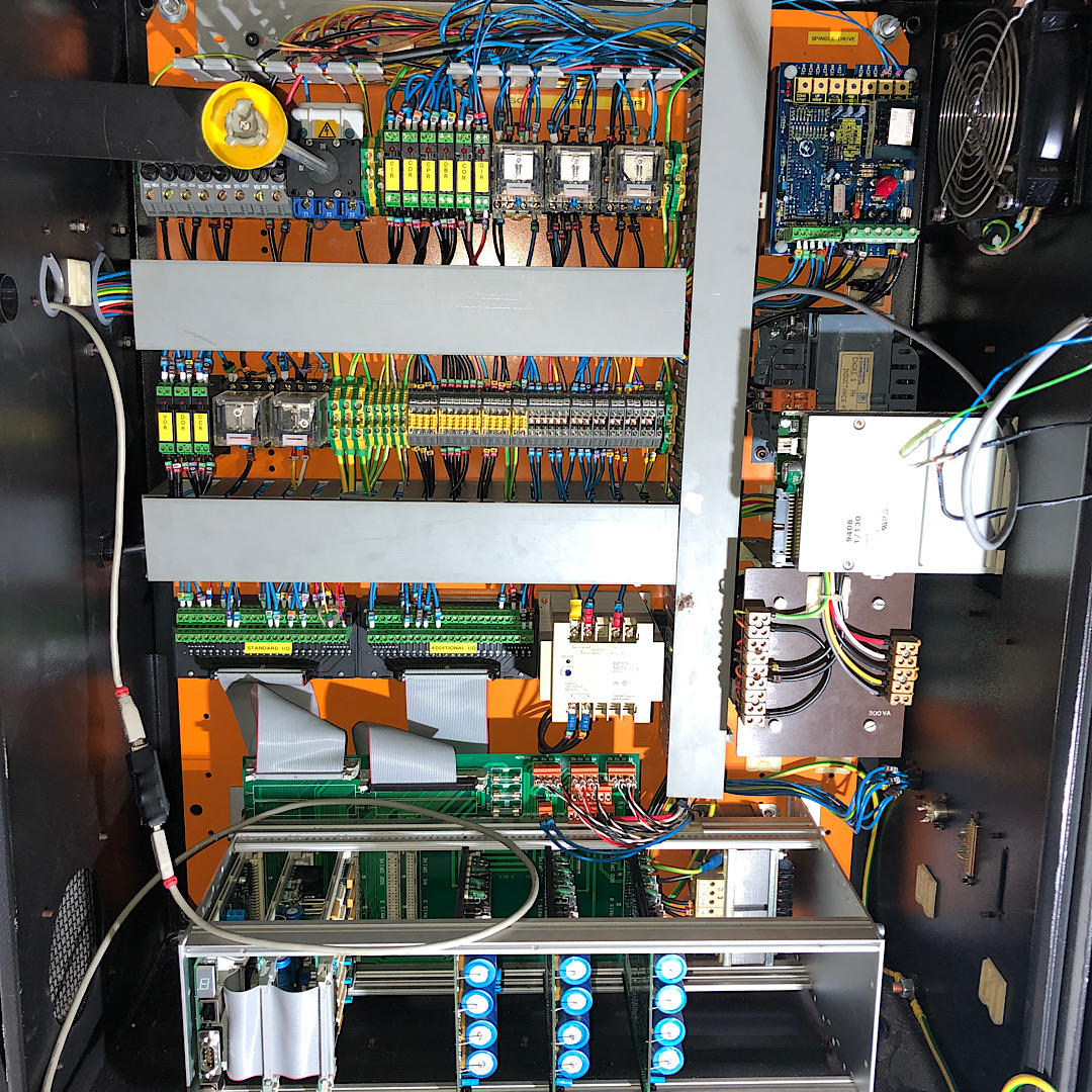

  1. #31
    The full cabinet…

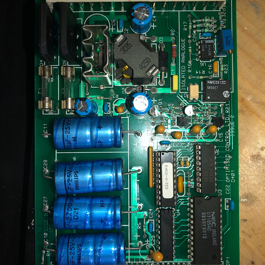

  2. #32
    Lives in East Lothian, United Kingdom. Last Activity: 7 Hours Ago Forum Superstar, has done so much to help others, they deserve a medal. Has been a member for 9-10 years. Has a total post count of 2,909. Received thanks 360 times, giving thanks to others 8 times.
    It's the card inbetween (second from the left) we could do with a photo off.
  3. #33
    Oops! Sorry… attached wrong image!
    I’ll try again… :)
  4. #34
    …the whole cabinet and rack.
  5. #35
    That's handy, they've even marked out what area of the board does :)
    First thing I'd be checking, is if the NME0512D (5 to 12V DCDC converter) is outputting 12V.
    If it's not, then I'd be checking to see if it's receiving 5VDC.
    Beyond that, you really need an oscilloscope to check things.
    It's a case of seeing if the opto-isolator is receiving a signal (from that previous thread, the Baldor outputs a PWM signal, which is amplified to drive the opto-isolator), and if the opto-isolator is switching it's output. It's a case of working through the circuitry to see where you are, and are not getting the required signals.
    Off course, the problem is doing all that while the card is installed in the rack.
    I'd probably solder on jumper wires to test the key points (8 wires - both sides of DCDC converter, and opto) to establish at least what side of the isolation is at fault.

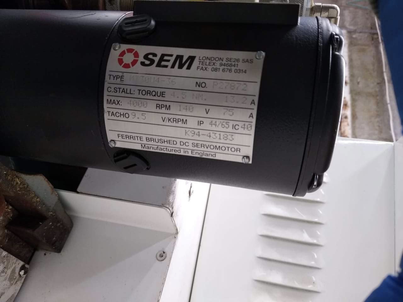

  8. #37
    What is the rated speed of the motor?
    I seem to think the original motors were rated at 3000RPM.
    As long as the sprint drive is outputting the rated motor voltage, then everything is doing what it should be, as with DC motors, Speed is directly proportional to Voltage.
  9. #38
    4000rpm
    The bit I don’t get is that the pot is working, but not giving me the range it should.
    I guess if I check the voltage output from the board / input at the motor I’ll get an idea if everything is as it should be.
  10. #39
    Checking the voltage will give a definitive answer, but I've just realised you said you only wired the pot across 1 and 3. It should be wired to 1, 2 and 3.
  11. #40
    Thanks… had this realisation too, and guess what?
    Being wired correctly makes it work correctly… who’d have thought it?! ��
    Now to sort the comms properly… new post coming shortly…
