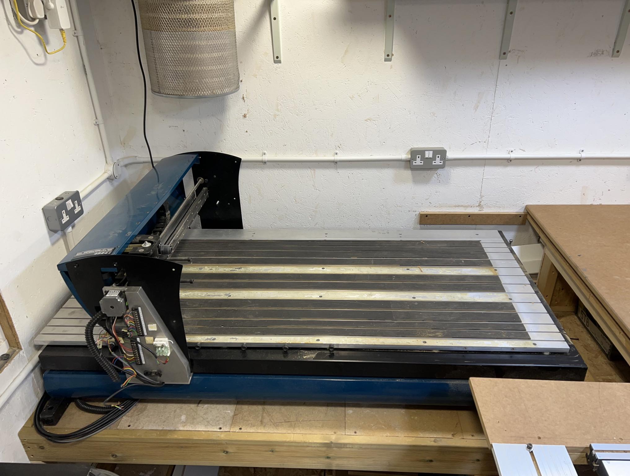

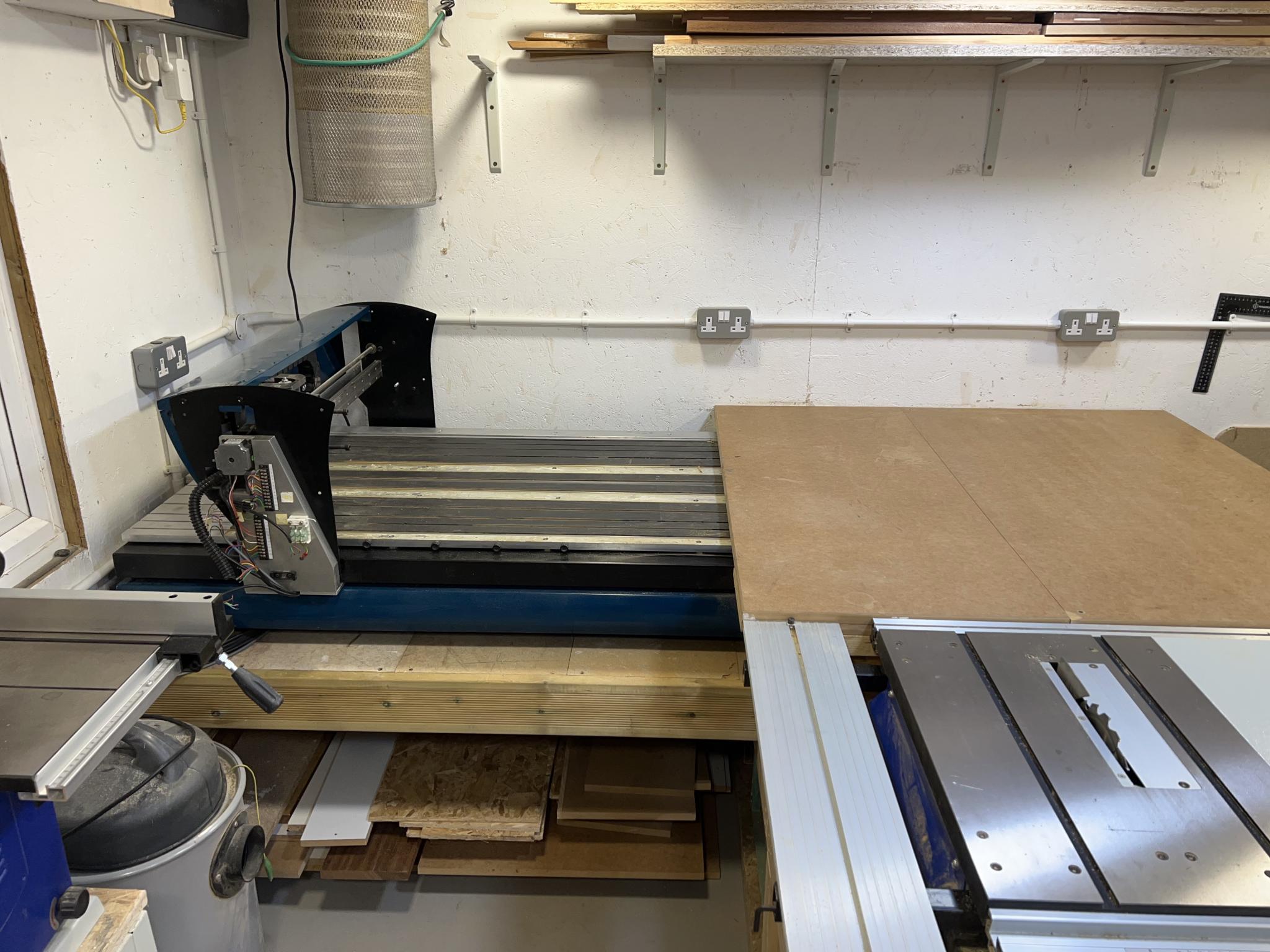

    Made good progress today. I built an additional bench to hold the CNC. I had to cut into my outfeed table / workbench but I think it's turned out well. When not in use I can fit a board over part of the CNC so I can use the table saw outfeed, I simply have to lift the board out to expose the whole CNC.

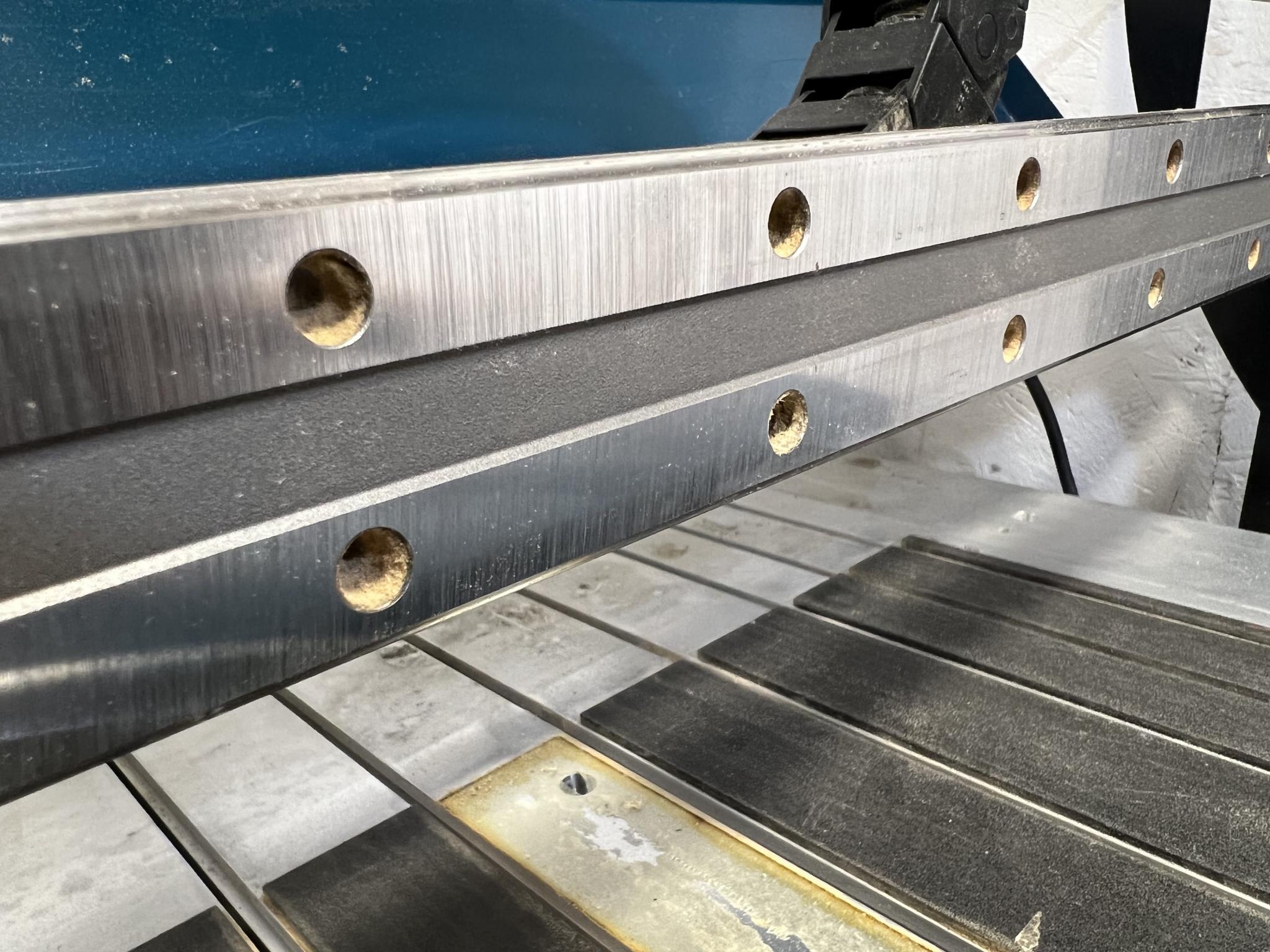

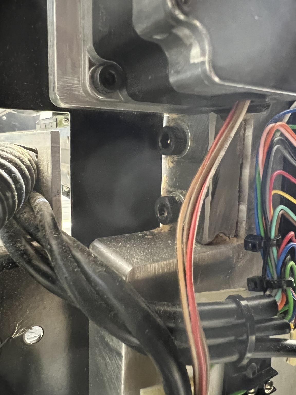

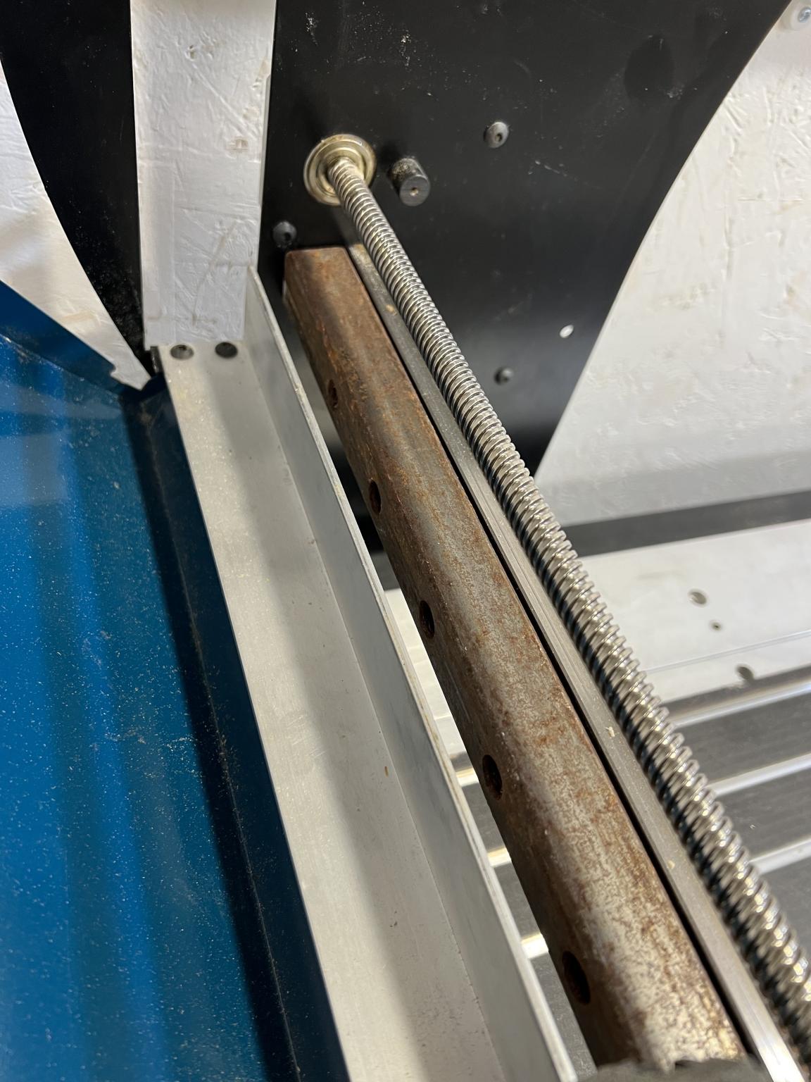

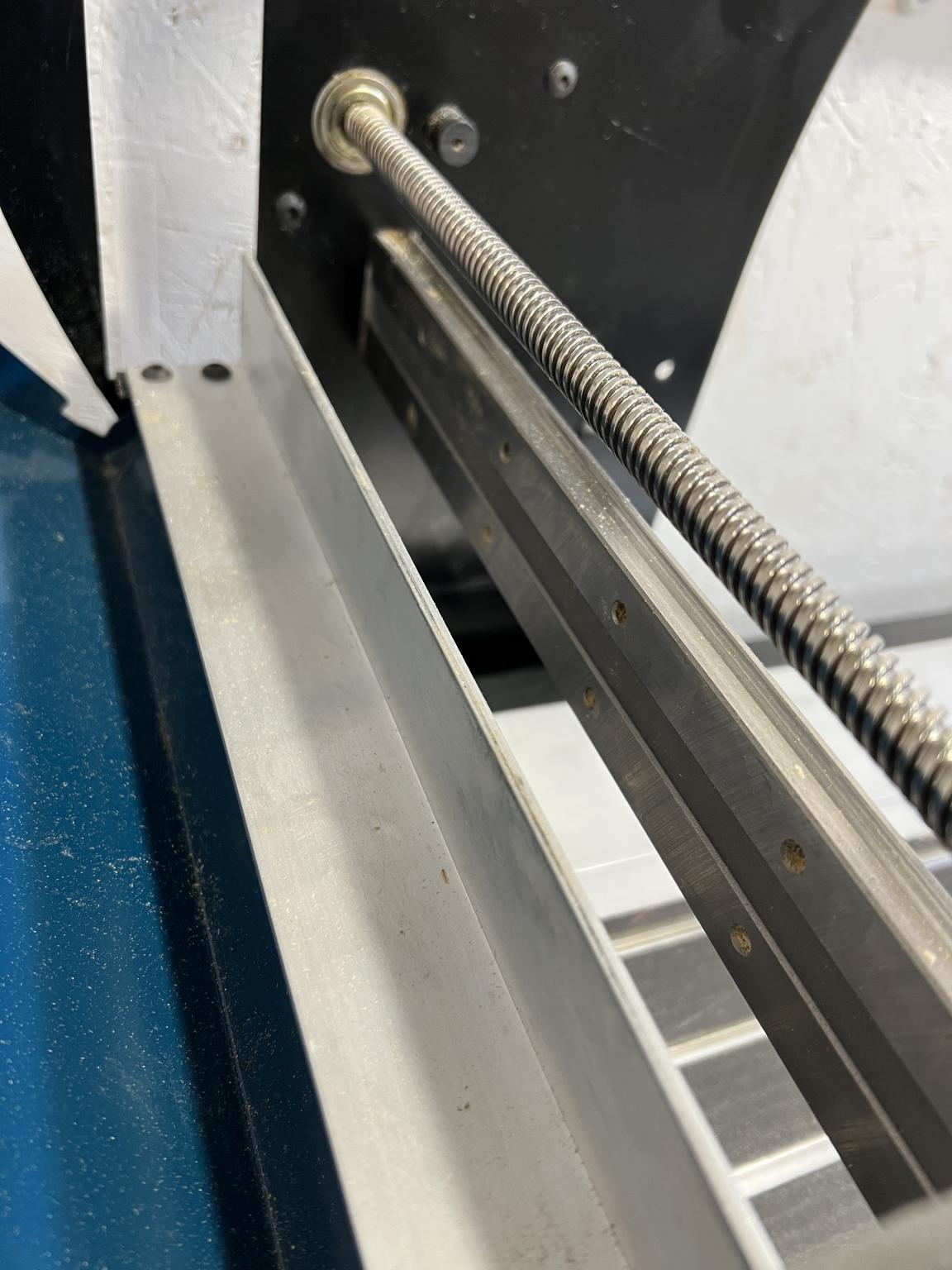

    Looking at the strength of the X axis. I agree that the axis looks weak, there is nothing support the linear rail against any deflection. I have had an idea to strengthen it up. I'm going to get a length of 28mm square steel tube. My plan will be to bolt this to the back of the linear rail and tie it back into the gantry supports (which are ironically very well built). I'll have to cut a little bit of the thin black plate away t(but this is just cosmetic) to allow the tube and linear rail to bolt into the supports. In one of the attached photos I'm holding a piece of section to give you an idea. Would like to know what you think?

    My honest opinion is that you are wasting your time with this gantry setup if you want to use it for a router as it's just not strong enough and certainly would be wasting your money trying to fit a 1.5 or 2.2kw spindle to it. The Single narrow beam just doesn't offer enough support for the Z-axis, really you need another above the lead screw so it offers support for the Z-axis backplate.

    I did some load / deflection tests and I have to agree with JazzCNC about the stiffness of the axis.
    First I wrapped a strap around middle of the X-axis linear rail (with the Z axis out of the way) and applied various loads measured with a luggage scale. I then measured the deflection with a DTI. Secondly, I moved the Z-axis to the middle of the gantry lowered the z-axis to it's lowest position. I tied the strap to the spindle collar and repeated loading and measuring the deflection.
    Once I had a base line set of numbers I clamped a piece of box section behind the X linear rail and repeated my test and saw a very noticeable improvement in the stiffness in the Y-direction and twisting forces on the Z-axis. So I think I'm going to add this regardless to beef up the gantry - every little helps!
    I have had an idea of how I can add a second support above the lead screw as JazzCNC described but that will take some fabrication - so I'll park this for now.
