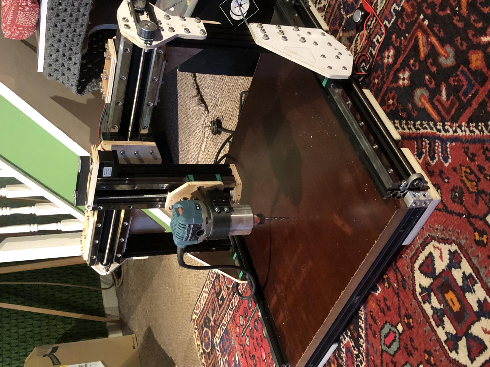

    Hi Rob, did you make a decision on what your going to build yet?
    .Me
    I went for a moving gantry setup in the end.
Name:	Photo 17-12-2022, 15 45 42.jpg
