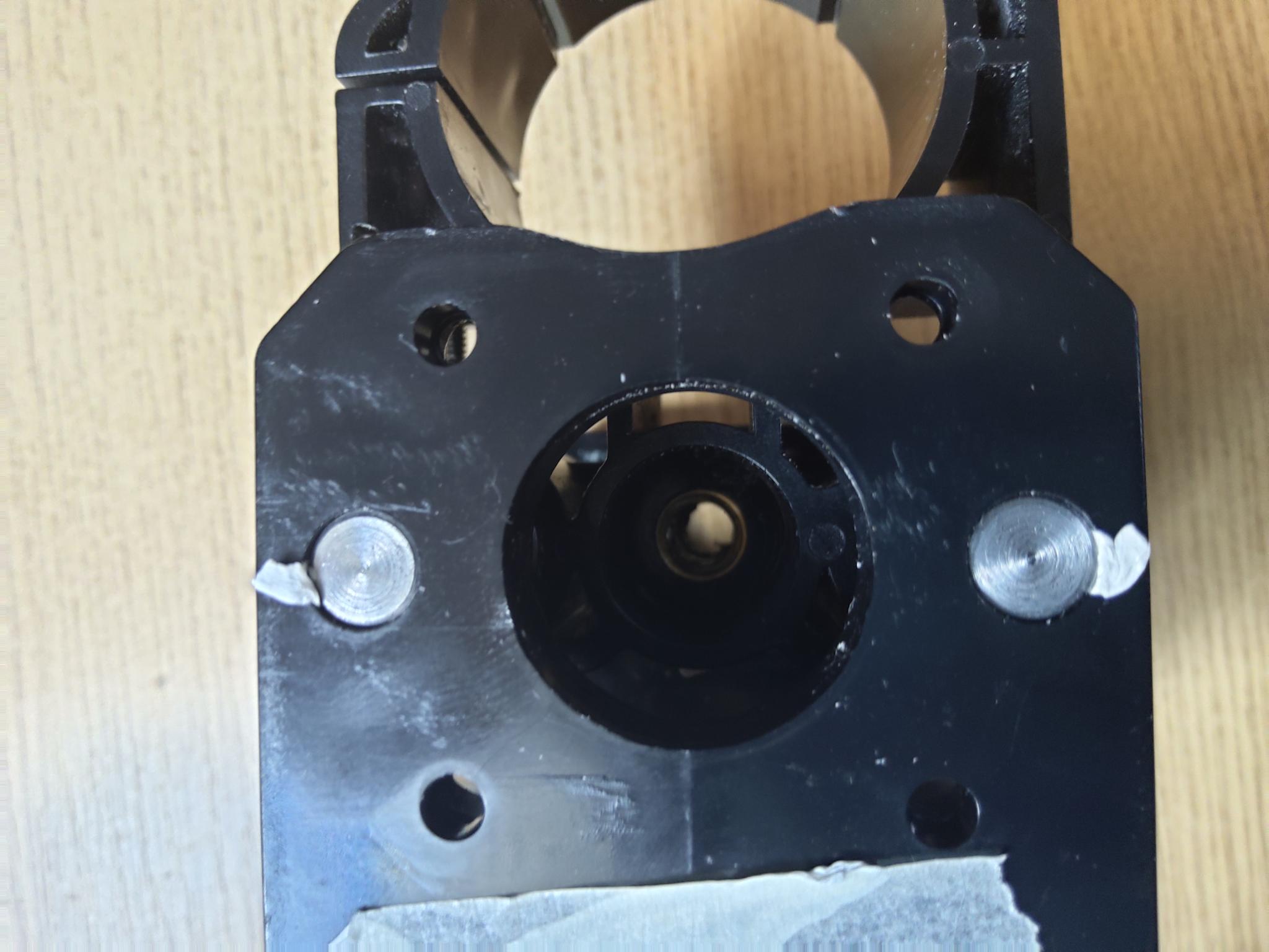

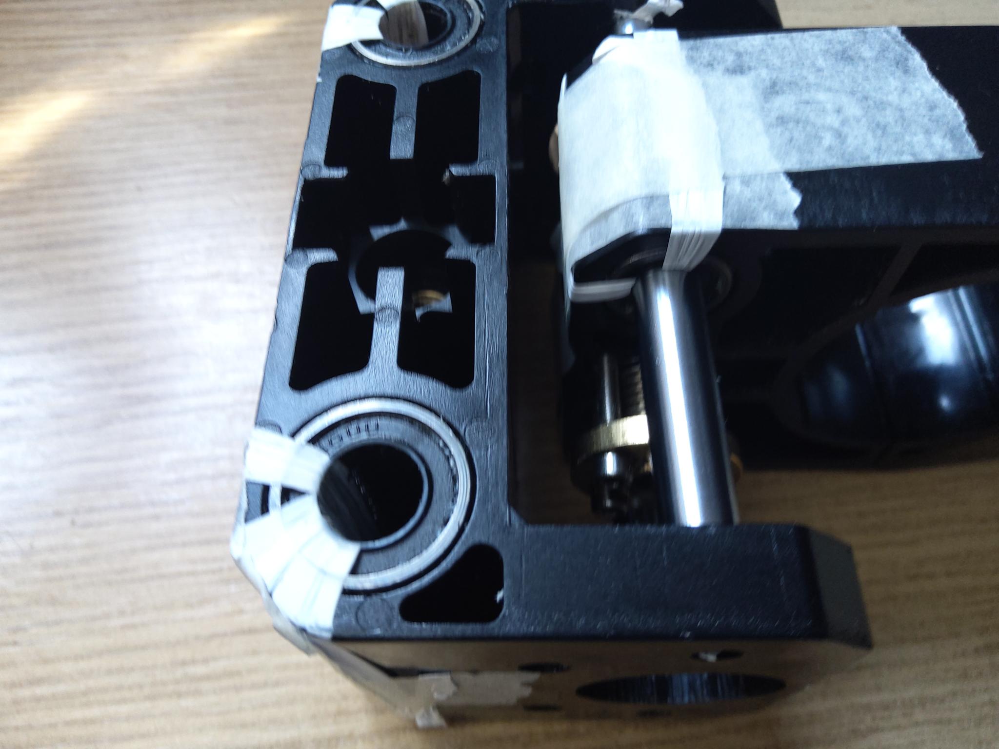

Back to p.c.b. I took the CNC apart to clean out all the plastic dust that had built up and noticed that the X axis has some play between the linear bearings and the guide rails, and a bit of play in one of the vertical bars of the Z axis. I figured this may be the cause of the inconsistency and to prove it I fed some PTFE tape through the bearings and taped the ends around the back of the motor unit and put a piece of tape in the hole of the Z axis bar and that took the slack out. When I fire up the machine I was surprised as to how much quieter it was and I managed to engrave a test p.c.b.

Thought I would add a picture of the PTFE fix, subsequently found play in the Z axis fixed as well.
