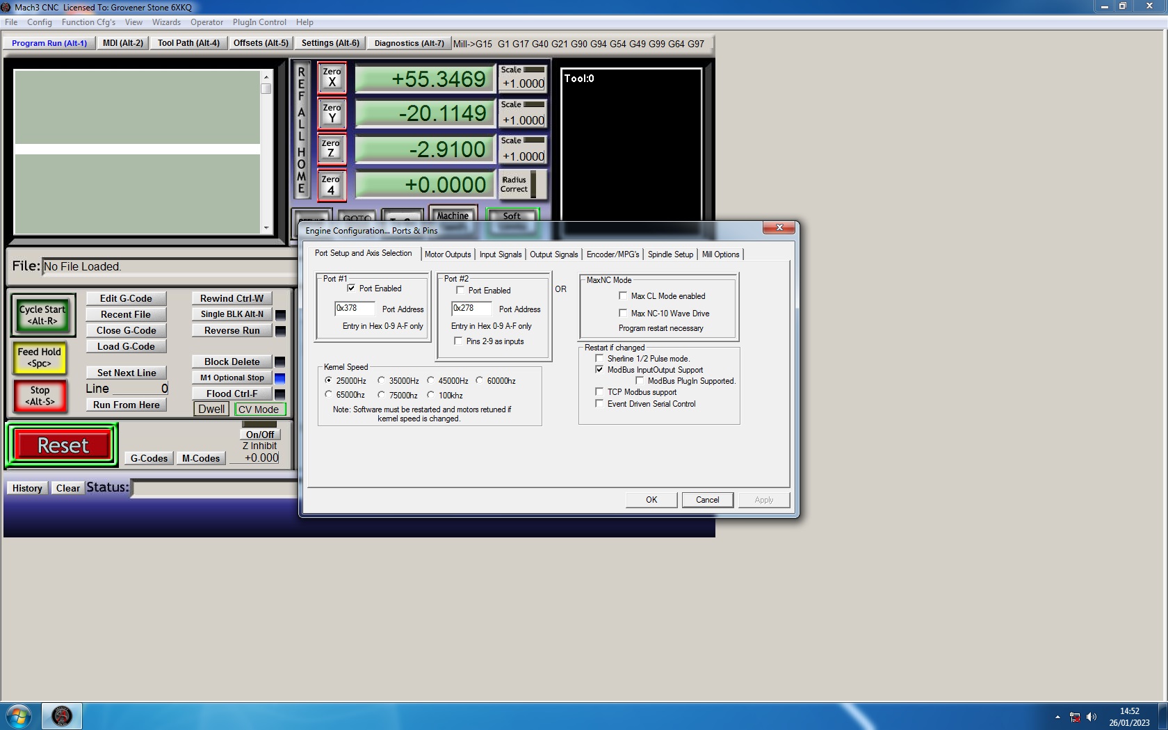

    It could be the parallel port is set to the wrong mode in the BIOS, but it's that long since I've had anything to do with a PP, I can't remember any of the details.
    There should be guides on the Mach site, or in the forum.

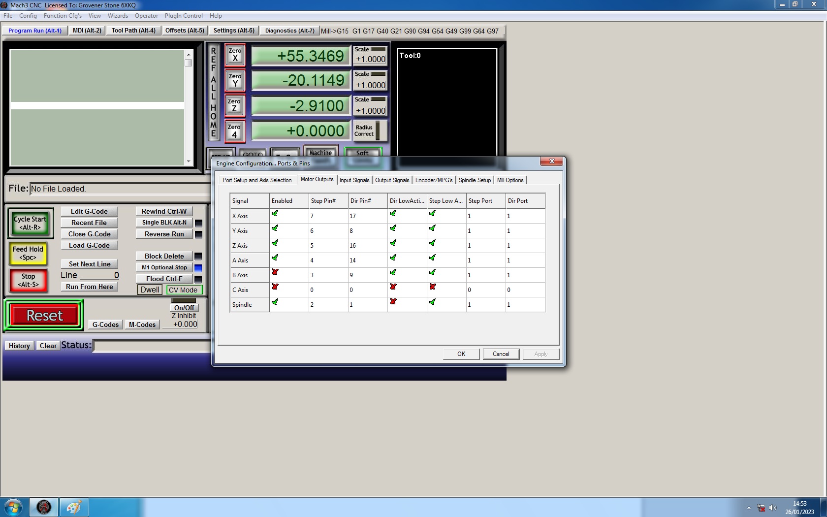

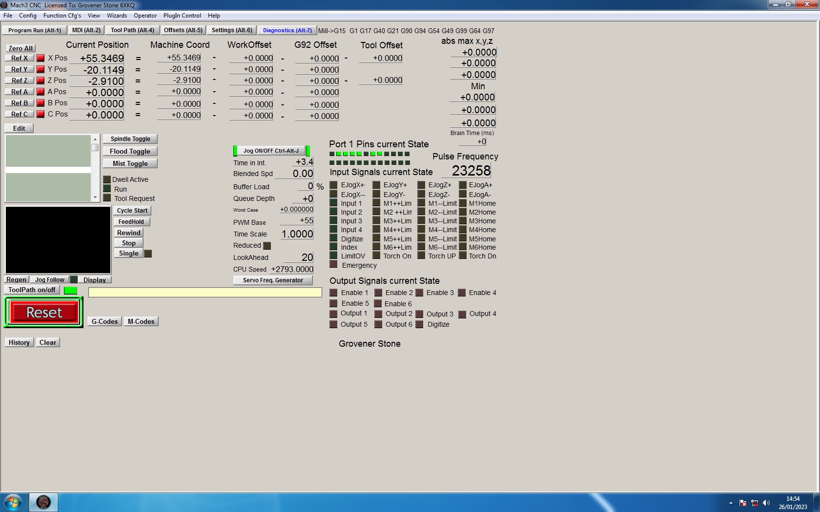

    I'm having zero luck with this.
    I've flicked through all the modes for the PP in the bios and tried each
    The port address is definitely correct, the mach3 drivertest tool runs fine. I've gone through several threads and the fix is always something to do with the port address.

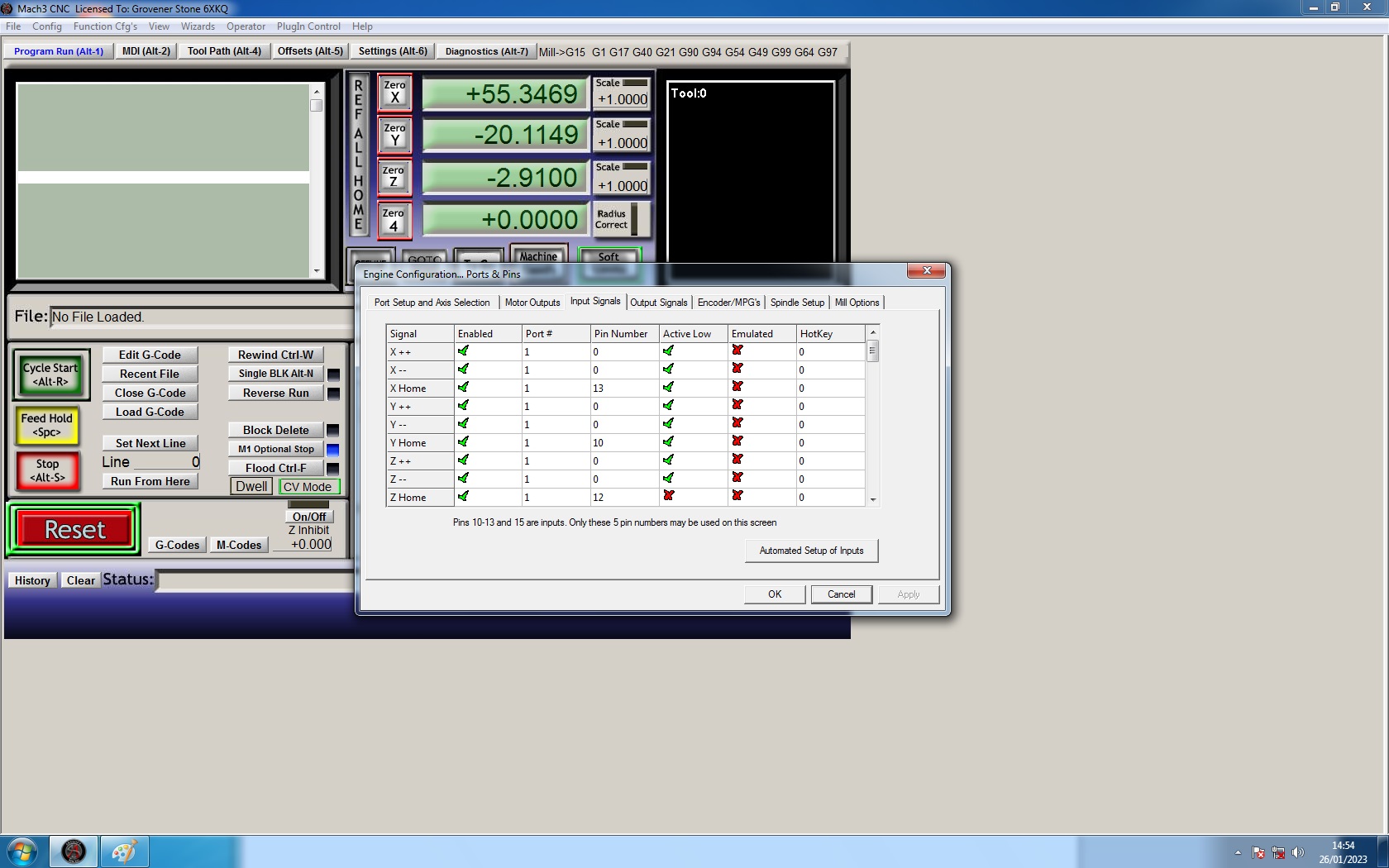

    I've attached some screenshots of my stuff
Name:	ports and pins.jpg
ID:	31675Click image for larger version.
Name:	motor outputs.jpg
ID:	31676Click image for larger version.
Name:	input signals.jpg
ID:	31677Click image for larger version.

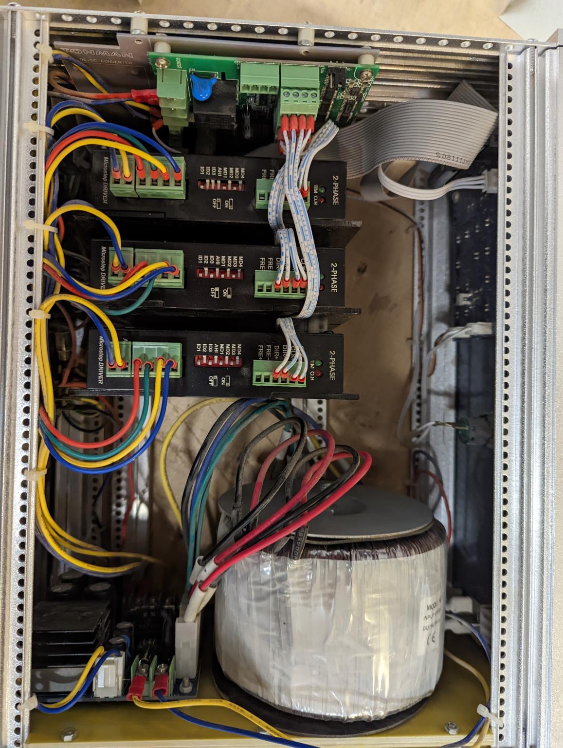

    Did you manage to work out the wiring for the machine?
    Have you got any photos of what BOB (Breakout Board) is fitted?
    My suspicion is it's possibly a chargepump config issue.
    The chargepump needs to receive a fixed frequency signal from the parallel port, otherwise it won't allow any of the outputs from the BOB to enable. It's a safety feature to avoid any 'random' movement/activations caused by uncontrolled parallel port outputs, which can happen as the PC hardware gets configured as the PC boots.
    However, the fact the E-Stop light goes off during booting, may mean it's using a simple enable output.
    Some photos of the inside of the control box would be helpful.
    Really appreciate your input m_c. I've attached an image I have to hand of the inside of the control box, I can get a better one when I'm in the workshop tomorrow.Click image for larger version.
