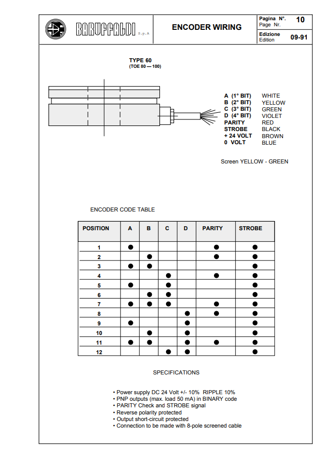

    We have a very old CNC that hasn't been used in like 20 or more years and since I just graduated, I was tasked to retrofit it. Along with this is the Baruffaldi Tool Turret - TOE100. The thing is, I was told to control the turret using a PLC (FX3U clone to be exact). I refer to this manual: toe1001st.pdf. Firstly, I need to test out the positions of the tool turret.
    The Encoder Code Table shows this:
    I may be wrong but through very limited research (due to lack of information in the net), I wired the encoder to the PLC like this (NOTE 1: Supply Voltage = 24VDC) (NOTE 2: FX3U and the encoder are connected in parallel to a power source through DC+/DC-):

    The problem is, when I test it, it does nothing. The contacts do not close in accordance with the should-be position of the encoder. Can it be that the encoder is faulty? If my wiring is wrong, can you guys help me?

    Are you manually rotating the turret to check the encoder outputs? That would be my first step. And I wonder whether the COM pin on the FX3U needs connecting to 0V perhaps?

    Most likely this.
    Easy way to test the encoder outputs, is with a multimeter. If you're getting voltage, then the encoder is at least doing something.
    BTW, you probably don't want Strobe being used as part of the position calculation.
    Strobe is used as part of the locking process and triggers the locking solenoid timing.
    To calculate position, all you need are the Bits (A, B, C and D). You don't even need to use Parity, as it's sole purpose is to provide a basic value check.

    Pardon me because forgot to mention that I did try connecting COM to DC- but it does not work. I also did try connecting the blue wire to COM. Nothing changes - the PLC contacts do not respond accordingly.

    I'll try to test it. If it does not provide voltage, can I conclude that the encoder is faulty and needs replacement?
    In regards to Strobe and Parity, If I understand correctly, I should remove Strobe and Parity to the position calculation (the PLC program I showed) right? Then, I will use Strobe for another rung for the locking process. Right? And I should completely remove Parity from the PLC program and disconnect Parity from wiring?

    If your encoder looks like one of these - essentially, unless there's a common-mode failure (e.g. supply line to the PCB) then each of the 6 signals is independent from the other - and it's highly improbable that the entire encoder has failed. I'd have to really dig around for any notes I may have but believe the encoder outputs are open-collector. If the PLC doesn't provide a pull-up, or cannot be configured to switch-in a pull-up then try with a 1k-10k resistor between DC+ and the output.

    You can still use Parity for position calculation, as it does provide an extra check that the encoder is on a valid position, but Strobe is only needed for timing purposes.

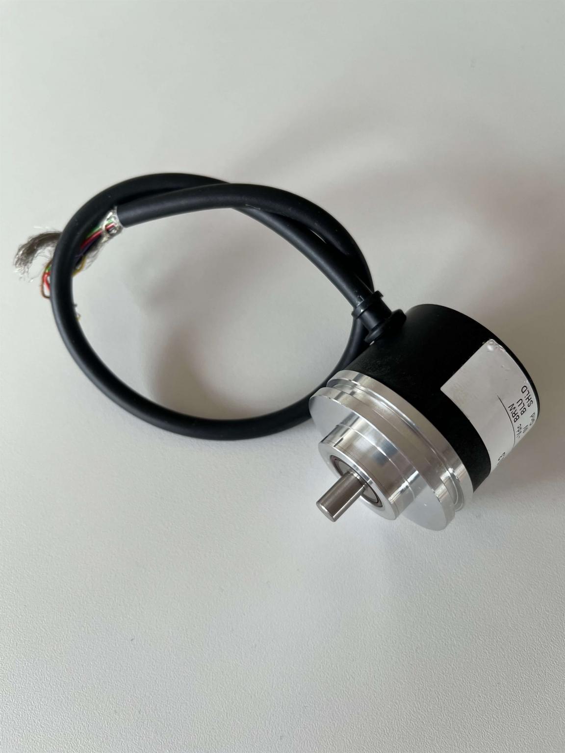

    I don't think my encoder looks like that. The encoder looks like this.
Name:	AG10 12 POS BARUFFALDI-p.jpg
    However, I'll consider what you've said. Thank you!
    Edit: If you're pertaining to opening the inside of the encoder, I might check it later.

    I understand the Parity and Strobe thingy. Thank you for explaining it to me clearly. Update about the encoder, I tested it and no voltage was recorded. Seems like the encoder is replaceable...
    About the PLC program, I am aware of Click PLCs and I'm willing to install Click PLC software just for the sake of having a great resource and knowledge later on. Thank you so much in advance!
