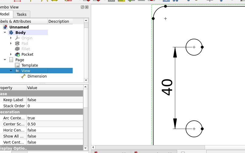

    So, not unfamiliar with CAD concepts. But have found FreeCAD, although powerful, has its own unique protocols for commands; some intuitive but many not so. My issue: to get to the nitty gritty, is vertices/constraints in the 2D Techdraw workbench. Have modelled a number of simple flanges: plates with a vertical web - tranvesrse and longitudinally - inserting the views is executed well and I am able to dimension all the profiles without any issues. However, when it comes to setting a dimension to position the holes in the flange-plate relative to the outer edges the hole centre (vertices) is “glued to the edge of the hole and not at the hole’s geometric centre. Videos, demonstrating dimensioning hole positions, use the displayed vertices which, in their examples, is at the epicentre of the holes. What might be the reason for this not being so in my 2D drawings? The sketch for the flange plate is “fully constrained”.

    I've been learning to use Freecad for a while and would never consider Fusion,given the way the providers move the goalposts regarding what capabilities they might allow access to.That being said,it isn't easy or intuitive too much of the time.I have zero experience of 3D printing or the software best suited for the purpose and may be a long way off the mark for suggesting that the Tech Draw workbench isn't really used for much more than producing old style 2d drawings.I would suggest the Part Design workbench is where you ought to be working as the constraints while sketching are the factors that govern a shape.I suppose the sectioning aspect of Tech Draw is useful for verifying that the characteristics of any given location are as desired.It might help with arcs if you delve into the options and switch the "show arc centres" selection to "true".It might need a recompute to update existing sections.

    I don't know if this screenshot of the relevant tab might be helpful.It does show that dimensioning from centres can be done if you delve into things a little.

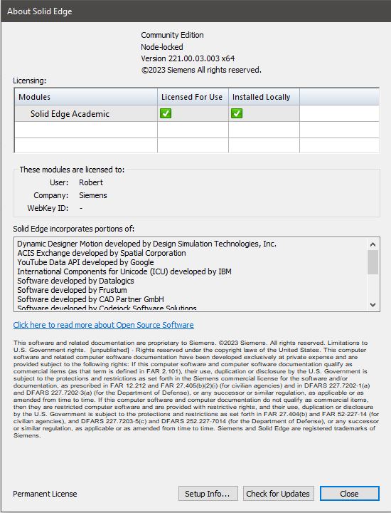

    I never realised Solid Edge was free ! Can you explain a little what version you are using, eg for students, or startup etc ?

    Yes Fusion 360 was my original choice but I’m running Windows10 upgraded a good while back, from Win7. The hardware incorporates integral graphics which HP - the mfrs - have no later drivers for. I mention this because when I tried to run Fusion - I’d run cleaning scan and stopped a lot of stuff running at start up, Fusion simply refused to run smoothly; freezing frequently and even completely crashing. Trued unistall and reinstall twice, but no material change so, I gave it best and downloaded FreeCA D V.0.20.2 instead. Even this took two goes to get running smoothly but it has since been working well enough. It also happens the men’s association - Men in Sheds - I belong too has downloaded FreeCAD as it is - apparently - recommended if you want to make your own models for 3D printing. The incentive there is we have recently been gifted a fully working 3D printer. Apology for the delay in reply, but thanks for your interest. Oh! have solved the centres problem with the techdraw in FreeCAD: seems the centres are disabled by default in the preferences. As they are crucial for accurate dimensioning, cannot for the life of me understand the logic (if any) behind this decision by FreeCAD. I’d ratger have the option to “disable” them rather than “enable” them!
    I am on 2021 Community edition. There may be updates, but I have never bothered (I may do now). Here is a screenshot of my 'About' page.Click image for larger version.
