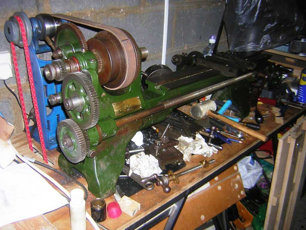

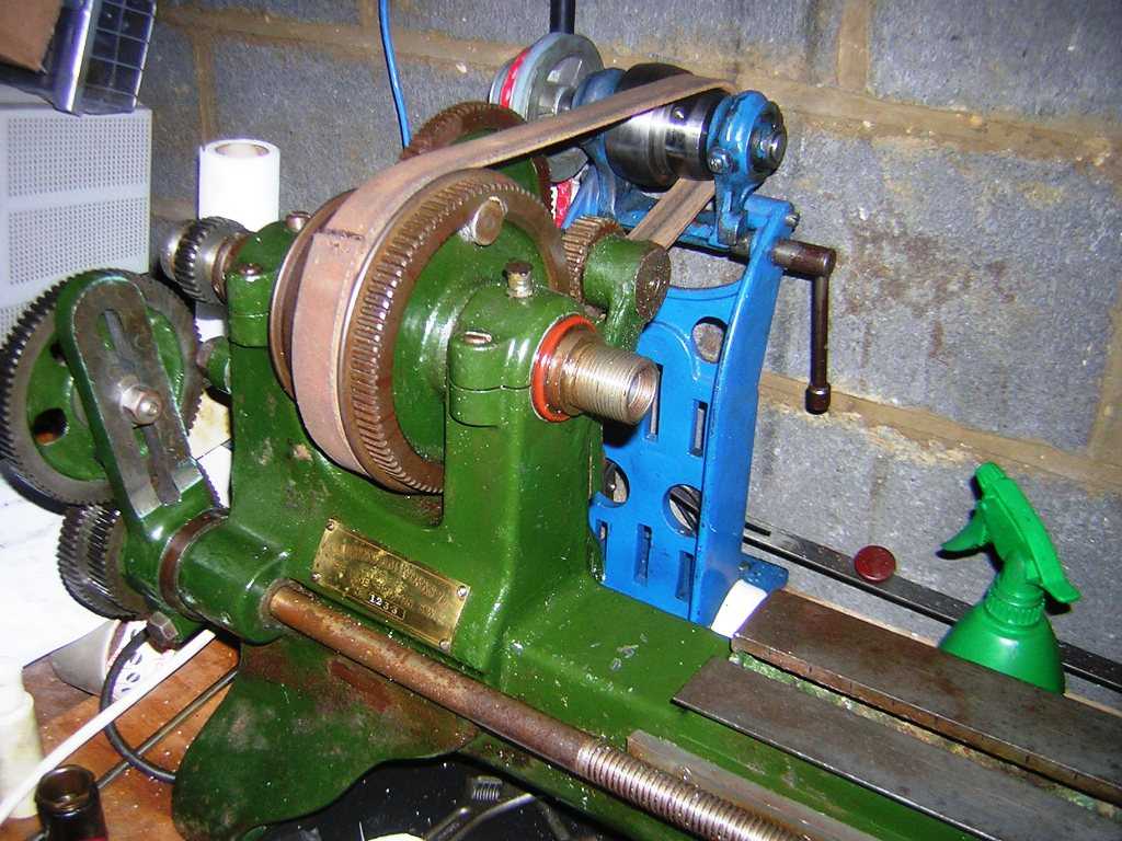

  1. A thread to document the potential rebuild of my SuperRelm lathe... I need to decide how much I want to do this instead of spending £400+ on a new minilathe or a 1960's Boxford or similar.
    The SuperRelm, c1915, is a classic early C20th English flat-bed lathe with the heastock and bed cast as one piece. It is an 8.5 x 24, so considerably bigger capacity than most minilathes, with an MT3 spindle bored 20mm and an MT1 tailstock.

    The rebuild will need to cover:
    • Sorting out the saddle, which binds about 32cm from the heastock end of the bed, but is loose enough to rock slightly about 5cm out;
    • Sorting out the top- and cross-slide leadscrews and nuts which are badly worn with a turn of backlash plus the cross-slide has 4mm of movement!
    • Sorting out the cross- and top-slide gibs to remove binding
    • Sorting out the plain spindle bearings to improve accuracy
    • Replacing the flat-belt pulleys with a v-belt (not sure about this one)
    I think thats the order to do it as each will make the lathe more usable

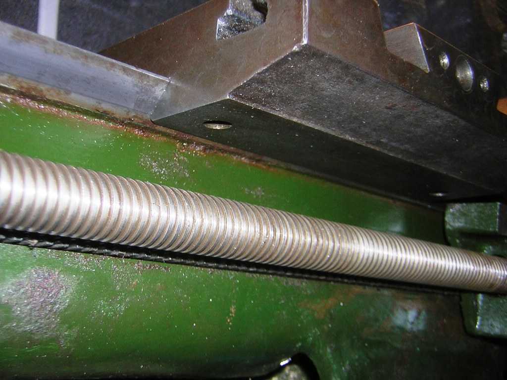

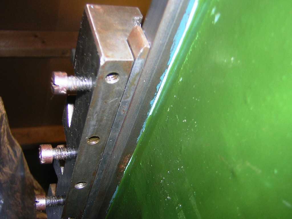

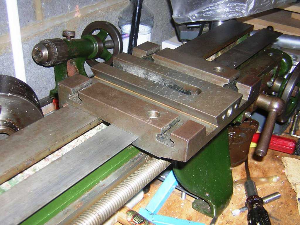

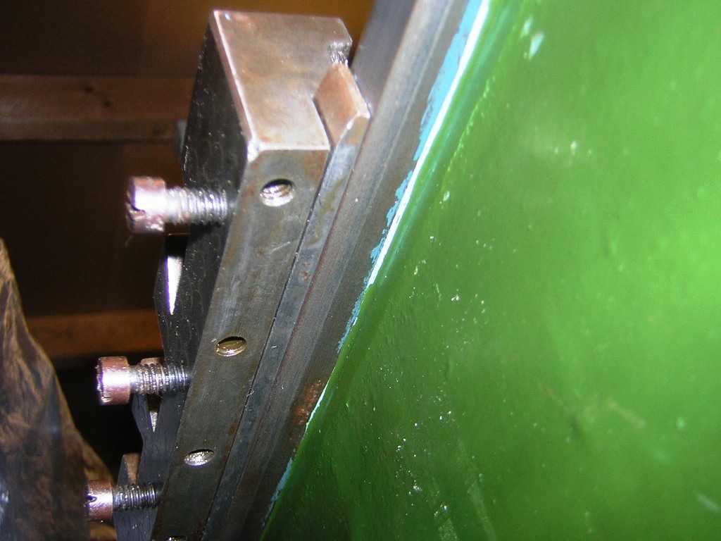

    Here is the saddle stripped down, and a close up of the dovetail and gib (with the vertical retaining plate removed). The saddle is disconnected from the apron so that I can assess how well it fits the dovetail. There is no rocking on the dovetail as far as I can tell.

    The saddle binds around 32cm from the headstock end of the bed and loosens up around 5cm out. I marked out every 2cm from the headstock end and measured the width of the bed using the saddle as a guide to keep the digital calipers square. The results show that the bed varies in width from 102.95mm to 103.36 with the low and high points as suspected. Its hard to tell on which face the wear is however a parallel placed on the rear face shows no gap while placed on the lip of the dovetail shows definite high spots. The dovetail face itself seems flat though (how would I check this?). The saddle has no relief at the point of the dovetail; I am wondering whether to mill one there so that the face of the dovetail takes the load and not the lip... or should I hone down the lip?
    The steel gibstrip itself is banana shaped by about 0.5mm at the ends so that could do with a new one being made up. Would bronze or brass be the better option? I am tempted to machine a tapered gib and do away with the four gib screws. There is plenty of metal in the saddle to accomodate one. I would also incorporate a saddle lock which this doesn't have.

    As you can see the saddle has some t-slots and these will provide the means to mount a boring spindle to rebore the bearings in situ. Options are here to repour the bearing and rebore or to bore oversize and fit bronze sleeves, but I am not sure about the wear of the spindle on the bronze, which is harder than the plain babbit bearings....

    On the cross slide how is the rear side held down as the gib looks to be verticle with nothing shown to hole it down to the bed!.

  3. see the threaded holes in the bottom of the saddle - there's a plate bolts to that to stop the saddle lifting. I'd probably make a new part that allows for a tapered gib there as well.
    For the actual gib I reckon there's enough material to machine the gib face to a taper and then put a tapered gibstrip with a slot in it to accomodate the adjuster which will fit into the end of the saddle.

    As far as checking the dovetail, part of the issue is trying to decide what reference point to use. There are three possible ones, the rear face or one of the two inner faces. What I cant tell is whether the inner faces are ground well enough to be a reference, and the rear face is the one thats likely to be worn.
    I think I'd start with getting the top surface flat and as level as possible (taking the extreme ends as a reference). Have you got a good precision straight edge?
    Does the tail stock run against the inner edges? If so, any sign of wear?
    The inner edges will have been machined at the same time as the two reference edges, so if they aren't worn too badly, they should at least be straight and in line with the original spindle. If you use a smooth parallel up against them to average out any 'lumps and bumps' you should be able to get a pretty good idea how far the two outer reference edges are out.
    If I were doing this by hand, I'd flatten and straighten the rear edge before tackling the dovetail. Use a right-angle and a gauge pin (or the shaft of a carbide milling bit) to check the dovetail.
