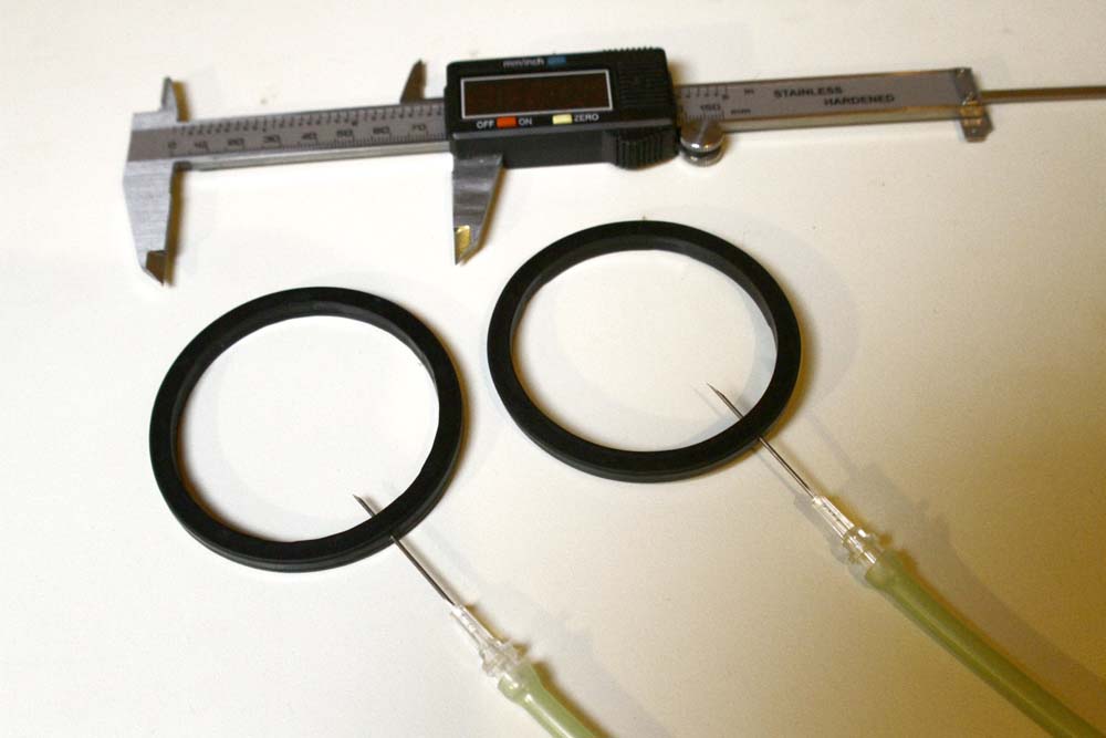

    75mm oil filter seals, iv no idea why i save them when i service my car?
    1mm outside diameter hypodermic needles, i drilled the seals with a .75mm drill (by hand)

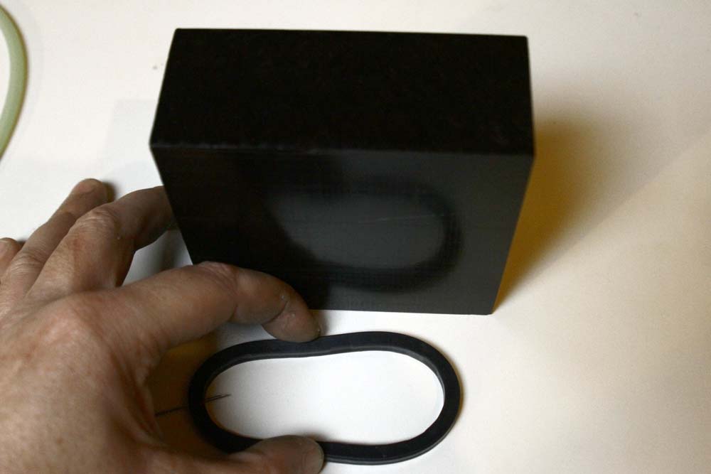

    squash for unusual shape

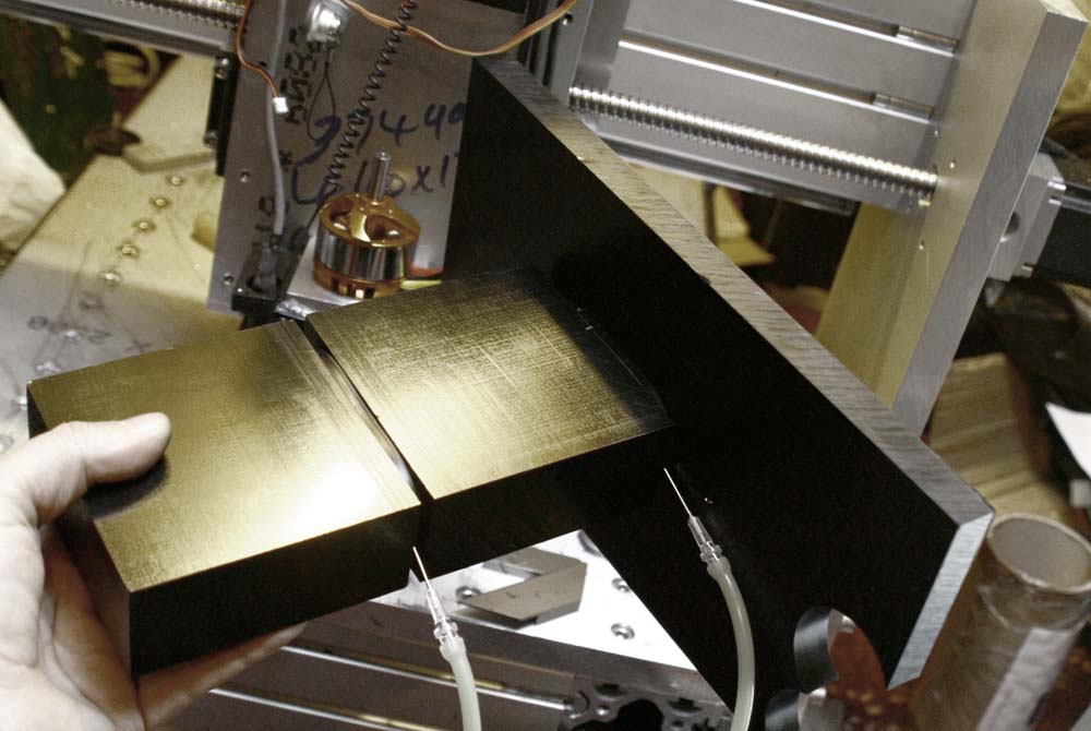

    plenty of holding force, the first seal is happily holding the weight of the second two blocks, i can slide each block around to square up but there is enough resistance for reasonable machining especially in acetal plate
    i have used the smaller pads to cut 28mm washers out of 1mm alli, i had one failure with it creeping... it takes a light touch. they will be fine for my engraving job

    Some where on this forum I had a thread about vacuum tables. I suggested cling film to mask off the unused holes.
    However, I like your solution. simple, elegant, and best of all, QUIET!
    Templecorran
    Where the Light was kept during the Dark Ages
  3. #183
    nice one ill give it a try, should work well with small holes, i was thinking latex but i guess over time you would build up a collection of anything that works
    blu-tack might be an option for slighly larger holes, i think anything over 4 or 5mm would need a more sturdy plug
    high on my list, my router is running inside the house (thank god im not trying to cut wood)
  4. #184
    Rubber test tube bung?
    I got the syringes yesterday - thank you Bigger than I expected - I'm impressed at the pressure (or lack of pressure!) that they can hold. I'll do some experimenting over the next few days...
