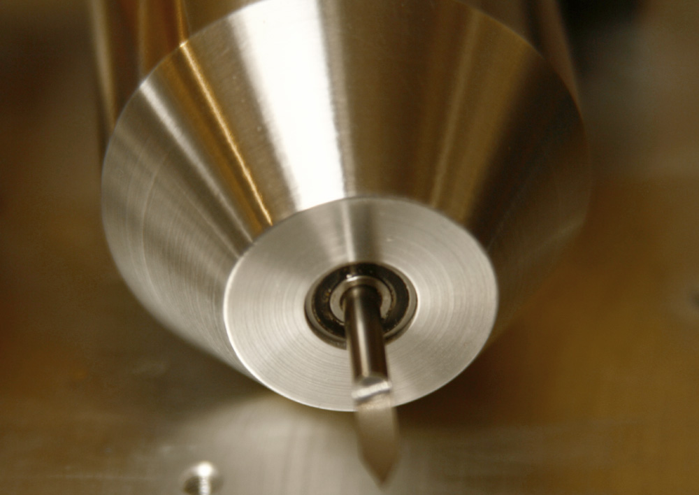

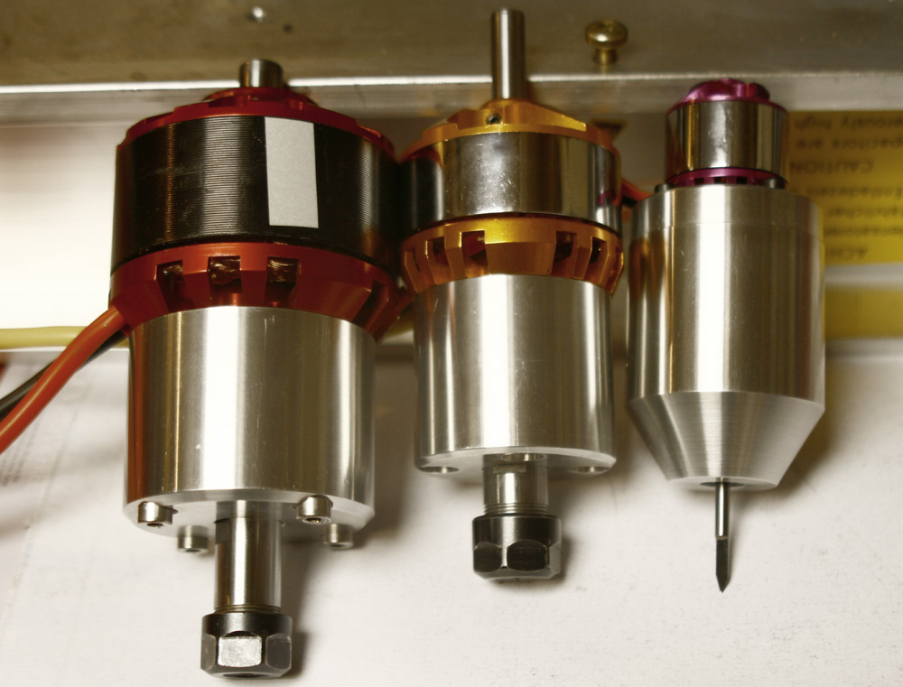

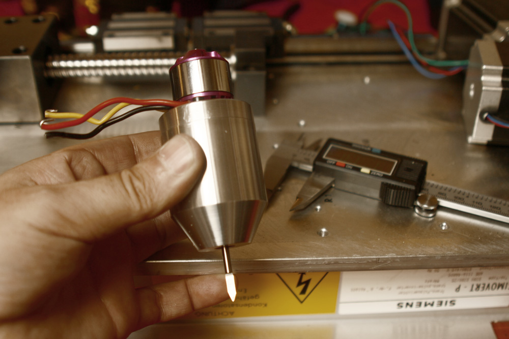

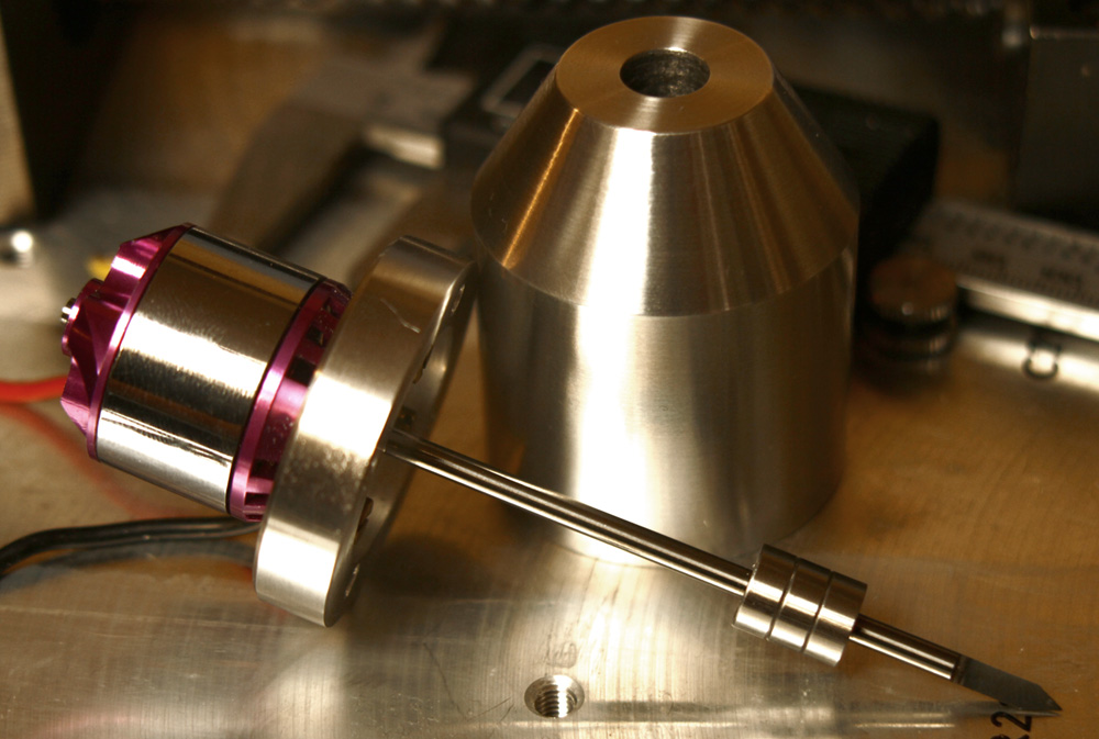

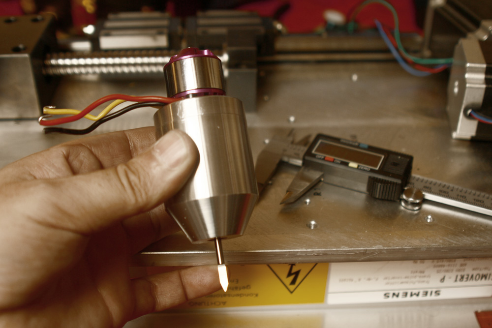

    though id have a play with my attempt at an engraving spindle
    the motor is 4000kv so in theory it should run at 48000rpm at 12v
    i managed to find an extra long engraving bit 115mm and mounted it straight through the motor and put three plain ball bearings at the nose
ID:	3166Click image for larger version.
ID:	3165Click image for larger version.
ID:	3168Click image for larger version.
    i ran it flat out for a couple of min's and both the motor and the bearing housing got pretty hot pretty quick
    im not overly worried about the motor getting hot its to be exspected IMO but i think the bearings on the nose are soon going to be way above 110 degrees..... i think ill test it to destruction before i look at water cooling i just cant bring myself to do it just yet, ill admire its simplicity and form for a while longer and have a think about it :)
    another problem i might have... when i run it up i can hear a bearing skidding now and again, im pretty sure its one of the motor bearings (only paid £7.50 for it new) so that will need upgraded bearings pretty soon
    has anybody had a go at sharpening an engraving bit ?????? this one cost me more than the motor

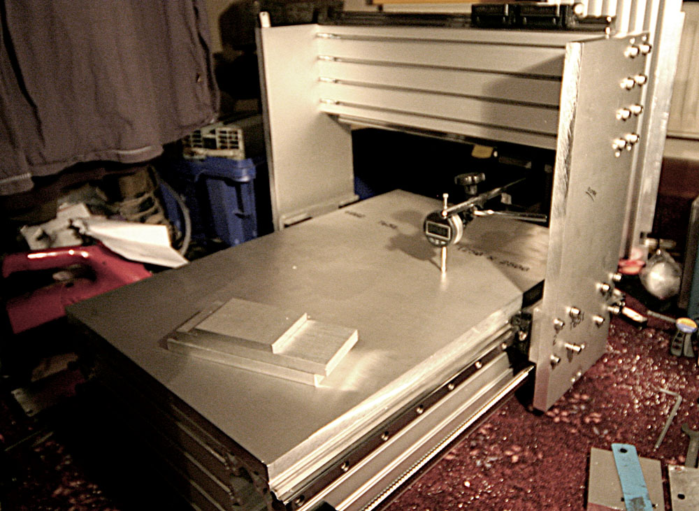

    Why is it that no matter how careful i am measuring and marking out i allways end up having to oval a slack hand full of holes, each time i start a new project i think " this is it now, im on it, iv learned by my mistakes and THIS time its all gona work like a bobby dazzler"...........Bollocks!!! there must be a tare in the space time continuum cause im buggard if its me! :)
    anyway, its starting to look like my drawing now, i drilled all the holes using my larger diy spindle and my Y axis up-ended as a sort of pillar drill (didnt want to be swinging around with a hand held)
    im pretty sure ill have to oval a couple more holes when it comes to trueing it up but iv got a sh*t load to do before its finished and i dont want to think about it :)
    (anyone thinking of useing helli mode on a RC speed controller, dont bother, it dosnt seem to hold revs any better than standard and it has a slow wind up to speed so every time you jam your drill you have to pause for it to catch up)
