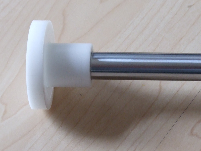

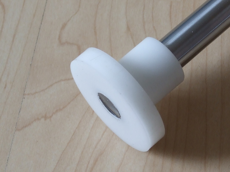

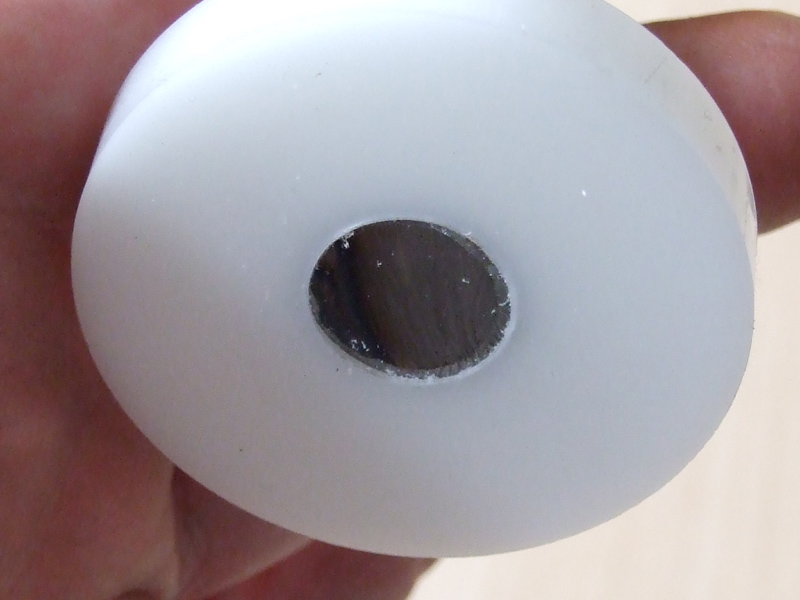

  10. #60
    My first serious piece on the mini lathe...the rail mounts,this is only one...need 3 more for the bed.
    Not too bad methinks,bore diameter is spot on...only need to drill four equal holes around the shoulder. :dance:
ID:	2679Click image for larger version.
ID:	2680Click image for larger version.
