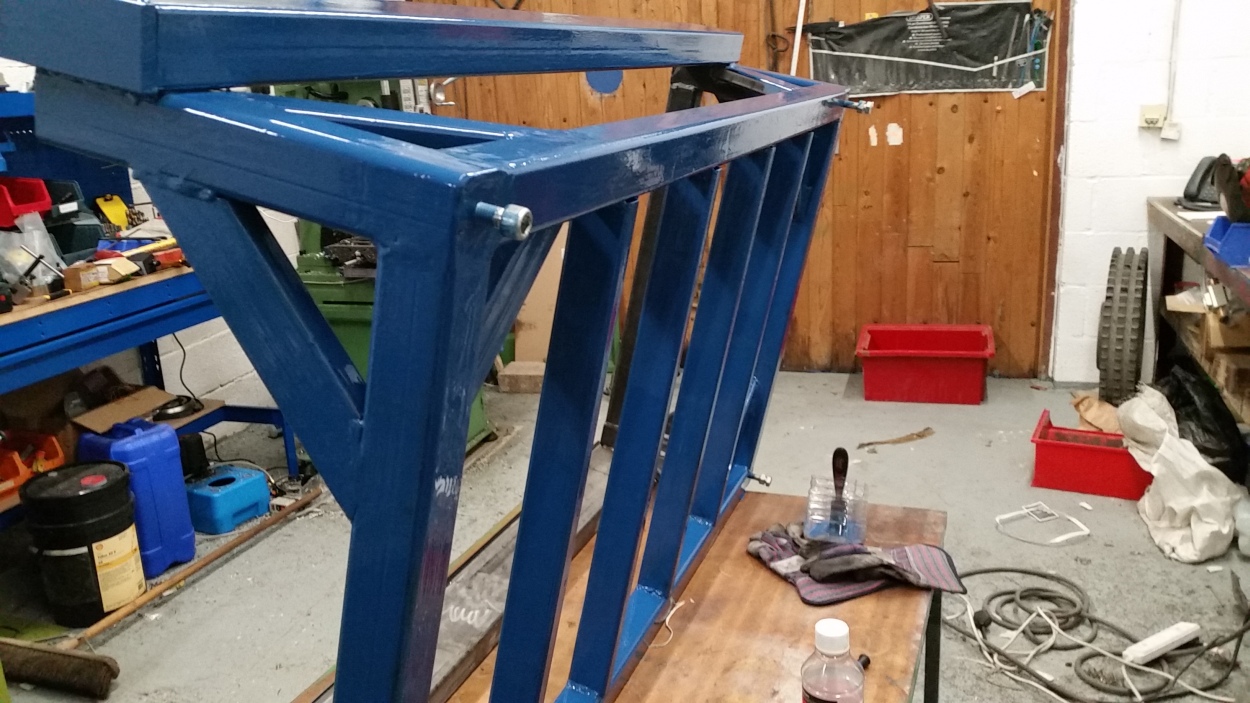

    Did a bit of painting this afternoon for an hour....
    Neil...
    Build log...here
