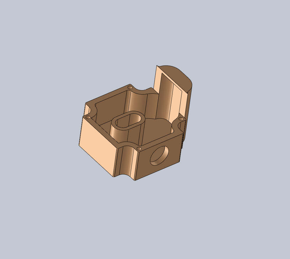

    Beautiful work.
    How about making some of these;-
Name:	Nema_23_Motor end cover.JPG

    Beautiful work.
    Cheers Clive!!
    If I had a 3D printer I would.....now if there was someone out there who could make those then I'm sure I'd be in the market for 3 of them (plus a Nema34 one...).....
