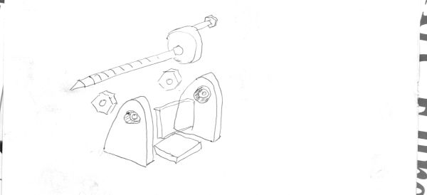

    Need a decent picture of the tailstock and centre hight to help here but it could be your first job.
    Two bits of MDF for the uprights, counterbored to take two nuts thwacked in, base, upright spacer and a sharpened length of all thread for the spindle.
    Alter recipe to suit ingredients.
