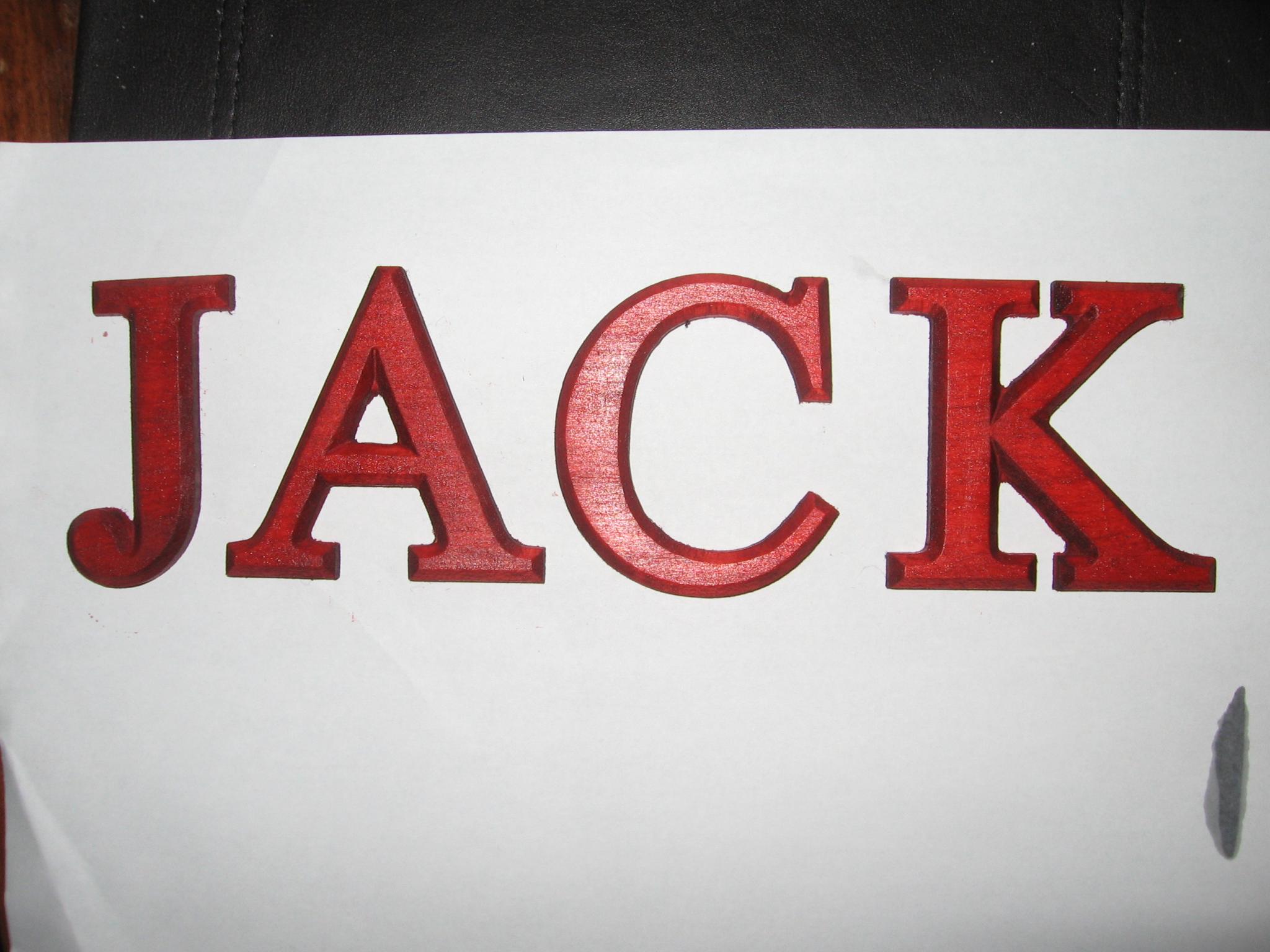

    a couple of things cut with vetrics v carve pro
    both cut from sycamore, the letters are v carve's prism letters

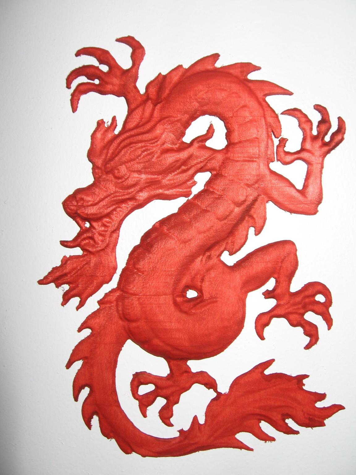

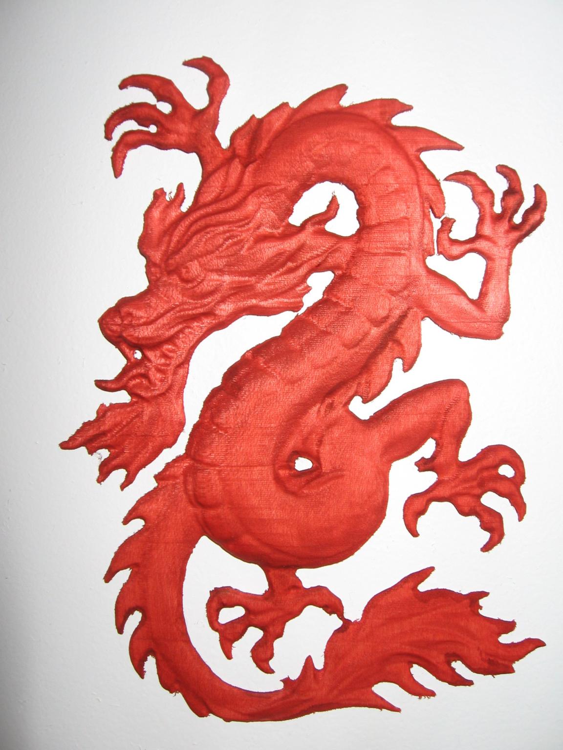

    the dragon from vector arts 3d , although vcarve pro cant do 3d on its own
    it can import toolpaths from va machinist

    Looking good Jonm, I like the dragon how long did it take to cut?
    jonm's Avatar
    Location unknown. Last Activity: 19-06-2011 Has been a member for 9-10 years. Has a total post count of 89.
    andy
    took about hour and a half roughed with a 8mm endmill
    fininished with a 3mm bullnose at 10% stepover
