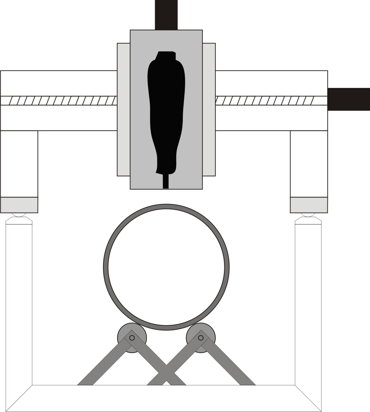

    MC,
    I have just been thinking about what you are trying to do and I think that you could do it with a fairly simple design.....
    What I am thinking is that you will only need 3 directions of movement, Rotary (A) to spin the pipe, Linear (X) to move along the pipe and Vertical (Z) to plunge the cutter. You could even do away with the Z axis being controlled by steppers and do it manually seeing as you are only cutting through pipe, just a thought.
    With a max pipe dia of 8" then why not limit the travel on the X axis (along the pipe) to something similar, maybe 10"-12" will do. Moving along the pipe to cut various other holes could be done with a second linear move and clamp system that could be positioned manually anywhere along a 5ft pipe.
    Your design then could consist of a fairly small X axis which could be done with a ballscrew as you will only need a small amount of travel. Same goes for the Z axis (if you go for stepper control), use a manual move and clamp method to get it close to the pipe surface depending on the pipe dia and then you will only have a small distance to go to plunge through the pipe.
    Pipe would be held at one end by a chuck which is controlled by a stepper motor for rotation and by a simple 3 roller type system at the other, 2 at the bottom which again have a manual height adjustment for various dia pipe and one roller at the top to hold it on place.
    Hope that makes sense, trying to dip a hobnob in my tea at the same time as typing this is a bit distracting.
    Have a look at the photo below then read my post again, may make a bit more sense!
Name:	CNC Pipe cutter.png
    Thanks guys,
    Here is an image that i was thinking of, sorry i cant use CAD to create the fancy images you guys do, so go easy on me lol
Name:	pipe cutter gantry.jpg

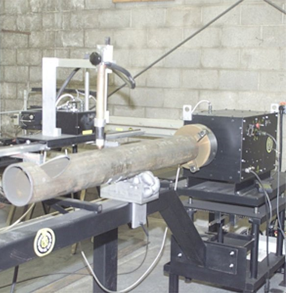

    That extra info is good!
    For the drilling, you need an A-axis, if you want the material turned automatically. To begin with, as you're only drilling holes on opposite sides, you could always just rely on turning the pipe by hand (machine drills/machines one side, then spin the pipe 180deg and let it do the other side).
    However, now that I know the type/size of holes you're doing, a x and y axis is pretty much essential.
    For the bigger holes, in order to keep the edges parallel, you either need to use a milling cutter and move the work under the cutter, which requires 3 way movent (up/down, fore/aft, right/left), or to rely on having the correct sized cutter so the pipe remains stationary.
    The hardest part I'd say to design, will be some form of clamp/support for the pipe. Rotary table at one end with chuck to control rotation of pipe, then on the moving head, some form of roller/guide assembly on the head to support the pipe at the cutter (probably one either side of the cutter for maximum support).
    Just check this video out, it shows what I was trying to explain....
    The interesting stuff starts around the 2 min mark, cutting large holes with a plasma, for your design the plasma would be replaced with a small router or Kress with something like a 6mm slot drill. Also it shows the machine drilling holes with a standard drill bit.
    Same principle as I was trying to explain though, just an X axis to travel along the centreline of the pipe, an A axis to rotate it and a Z to plunge through, Z would be optional but nice to have! Not sure why you would need a Y axis at all??
    You could also cut the ends of pipes so you can create your own 90 degree joints.
    Simples....!
