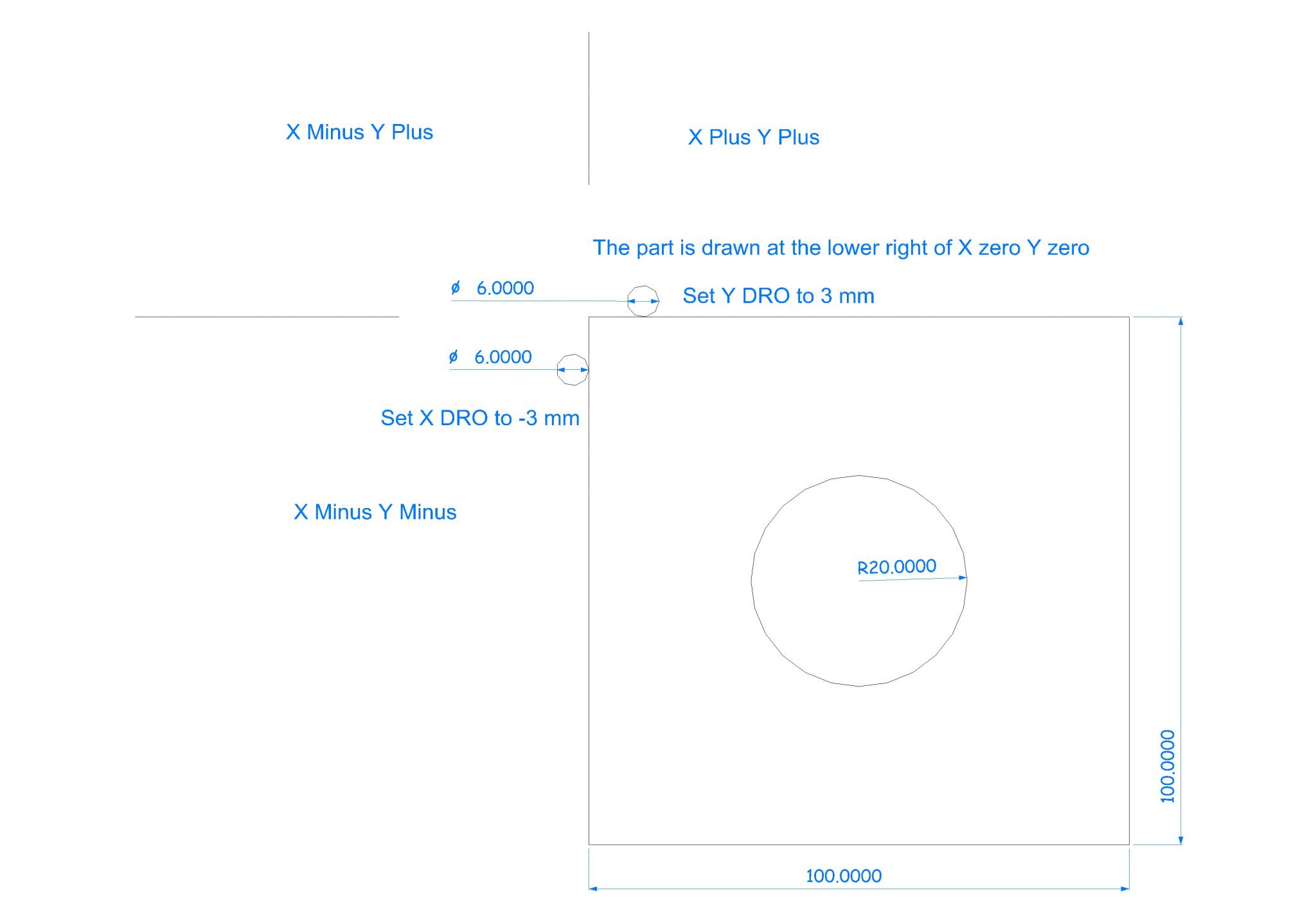

    You draw your part in CAD then create a Gcode file using a CAM program
    The attached pic is drawn in the lower R/H corner this is X Plus Y Minus
    The piece is 100 mm square and you want to put a 20mm hole in the centre
    This assume your machine is perfectly set up, no backlash etc
    You only have simple equipment no edge finders of any type
    You will hold this in a vice clamped to the table with the back edge running perfectly parallel to the X axis
    Have the part stick out say 10mm on the left hand side
    You can use a dowel of 6mm dia or a cutter mounted in your collet upside down
    Bring the dowel up on the left hand side so it is just touching you can use a feeler gauge to do this but you have to add the feeler gauge thickness to the DRO's setting
    Once you have TOUCHED OFF set the DRO to the correct dimension then raise the Z and move the table to Zero it should be obvious if the dowel looks correctly on the centreline
    Then you repeat for the other axis
    Using this method you should be able to be accurate to 0.02mm
    You could also have other holes, recesses shapes in the plate but the edge finding is the same
    HTH

    I get a piece of paper and hold it between the cutter and the job, then gently move the cutter to the job until the paper is just trapped. You can do this on the edge of the cutter and the face, for x,y, and z.

    I do that too, adding 0.1mm for the thickness of the paper. Or get the cutter close, put the spindle on and move it so that you just hear it brushing.

    i used to wet a piece of paper and nudge the tool onto it but sometimes you get a fine witness mark on the job if you're a bit heavy handed. With a dry piece of paper and the spindle off you can feel the connection.

    Edge finders aren't that expensive - http://www.arceurotrade.co.uk/Catalo...t/Edge-Finders
    However, I've always used an edge finder, then if I need critical height, a bit wet paper, or just wind down/up until the tool just starts to mark the workpiece, depending on what I'm doing.
