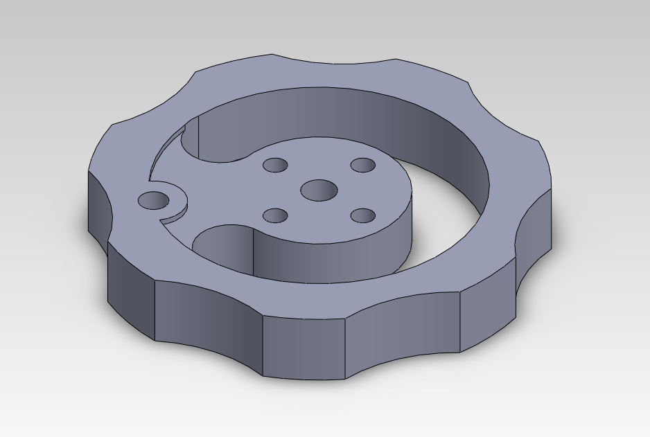

    This project uses a 12mm or 1/2” thick aluminum plate or round bar to create a hand wheel.
    If using cutoff round bar material you may need to square it up in the lathe first. Drill through the center of the material with a 5.0mm drill and thread with an M6 (6mm) tap. This serves to bolt the aluminum to a piece of material that can then be clamped to the machine bed.
    When complete the center hole can be drilled or reamed out to the size required. The file's provided will machine the basic shape, other details can be done manually to one’s own requirements.
    The G-Code file to machine basic wheel shape using a 4mm slot drill and a pdf of the part are attached to this post below. The part is quite a large file and may take a couple of hours to complete, if a lathe is available you could also turn the wheel for a final finish.
    This was originally provided by Roy over at www.diycnc.co.uk, He also has some other cool projects too.

    Hi, can I ask what cad cam software you used to produce this part and post process it please?
    Hi Chuck,
    I got this project from Roy over at www.diycnc.co.uk so I don’t know what software he used sorry, I have updated the original post to correct a few things and I have also added a pdf as a technical document for the part, it shouldn't really be too hard to re-draw this part in your own favourite CAD program.

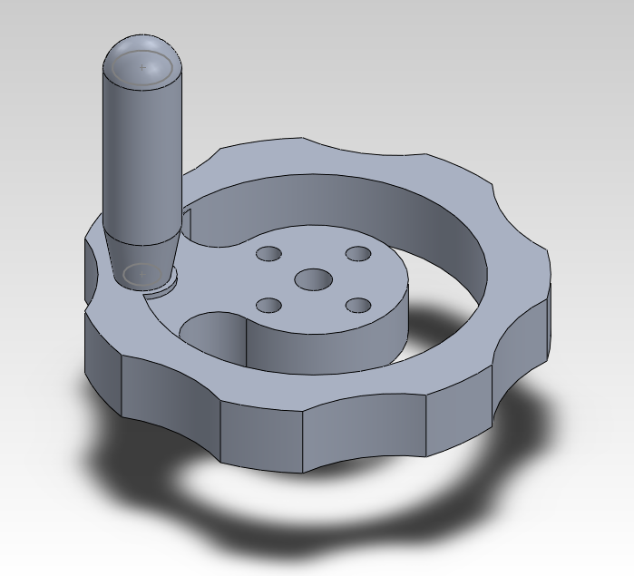

    If I may just ask a question Lee, why is the handle not in the middle of the solid part as it would be much stronger!
    Peter
    i2i's Avatar
    Lives in Cardiff, United Kingdom. Last Activity: 23-12-2016 Has been a member for 7-8 years. Has a total post count of 693. Received thanks 30 times, giving thanks to others 0 times.
    You could move the centre connecting web to the handle position.
    Nothing to stop you designing your own.
    John S -
    Not that I would want to design my own wheel, just from an engineering point of view having the handle offset from the web could lead to a fracture as the rim will flex under heavy stress as did citreon sterring wheels in the 60's DS19.
