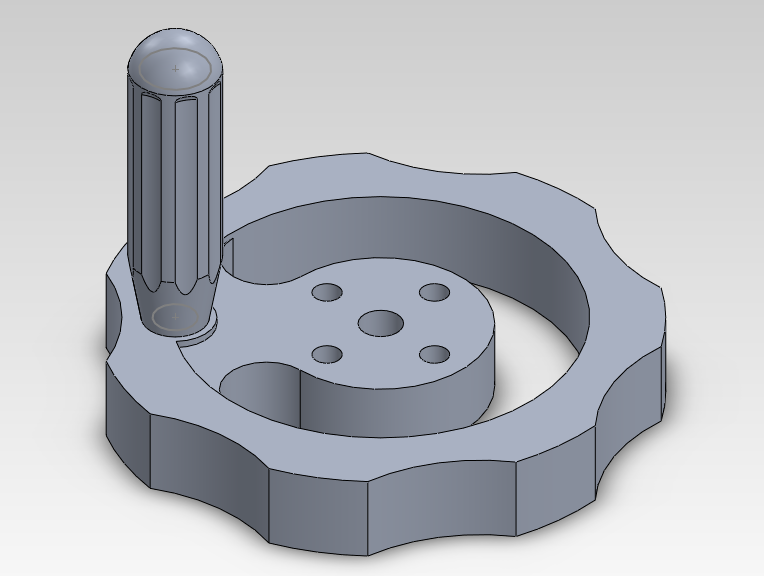

    More like this?Click image for larger version.
    Quick RenderClick image for larger version.

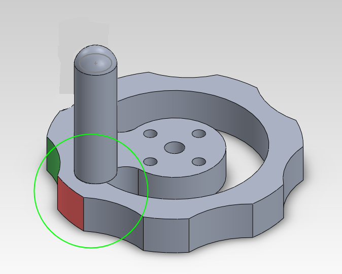

    Nice!, think i would rather see the handle as a solid bar with no tapered fixing, with a dome/ball finish on the protruding end.
    Maybe also move/rotate the 25mm radials on the outside of the wheel so that the handle has more material on its outside edge. Should keep Pete (ptjw7uk) happy also ;-)
    What did you draw this up in ? solidworks ?
    Not sure I follow???

    Almost...
    Like this for the handle see pic (more contact area for Pete :lol:).
    Then swap the red with the green, so rotate your arc's around the wheel.
