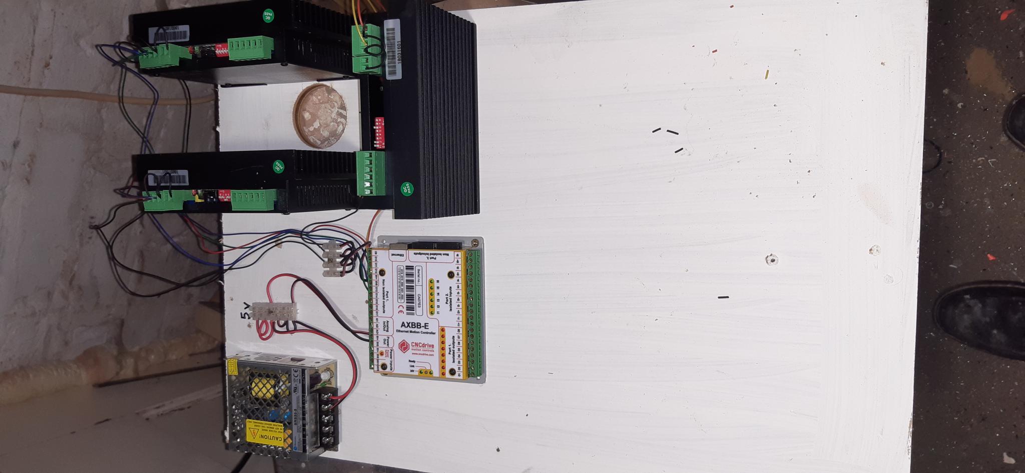

    Bending down inside a cabnet is not as easy as it was (you'll know when you get older) so some work has been done on the new control gear to give my back a rest

    Still can't get the pictures the right way round
    Next step work out the new wiring.
    Flashing lights and no magic smoke.
    I need to source some bigger terminals for the transformer to rectifier connection and a twisted ethernet cable as going via a hub is having issues connecting.
