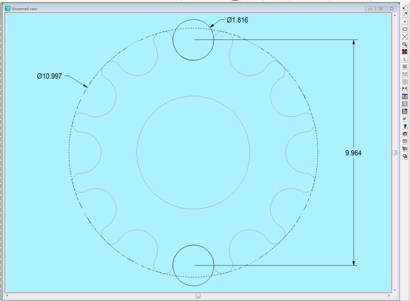

That's what I did for XL pulleys ... but then that's only a trapezium.
Small ball nose cutter and several passes to get the right profile? Would take ages but if it's a one off why not?
P.S. I've got some 3m HTD pulleys if you're interested... I'll go and check what sizes.

The profile for 3m looks like this
What about to drill 12 holes 1.8 mm dia then turn it to proper outside size???? Eventually tweak corners a bit
Jonathan I have those pulleys, but I need something like shaft ending with a pulley on the end. The stock one are not any good, I tried:sad:

That looks like the profile for the belt, not the pulley. There's generally a small difference.
I've seen pictures of it done by drilling, so I suppose it's worth a try. I can't think of any reason for the holes not to be accurate. I would use 1.9mm as you'll be a bit stuck if the cut-outs are too small and it does not fit.
You might be able to 'tweak' the corners well enough with a chamfer. Maybe put it in a lathe and spin whilst holding a piece of wet and dry to it.

I think I'll go for self center chuck and eventually in a future for independent jaws.
Thanks Jon for calculations to do pulley this way will save me hassle with producing a cutter. What's the program by the way????
10-08-2011 #20
Pulley generated in Gearotic,
www.gearotic.com
Then saved as 2D DXF, brought into CAD and the two circles added and dimensioned.John S -
