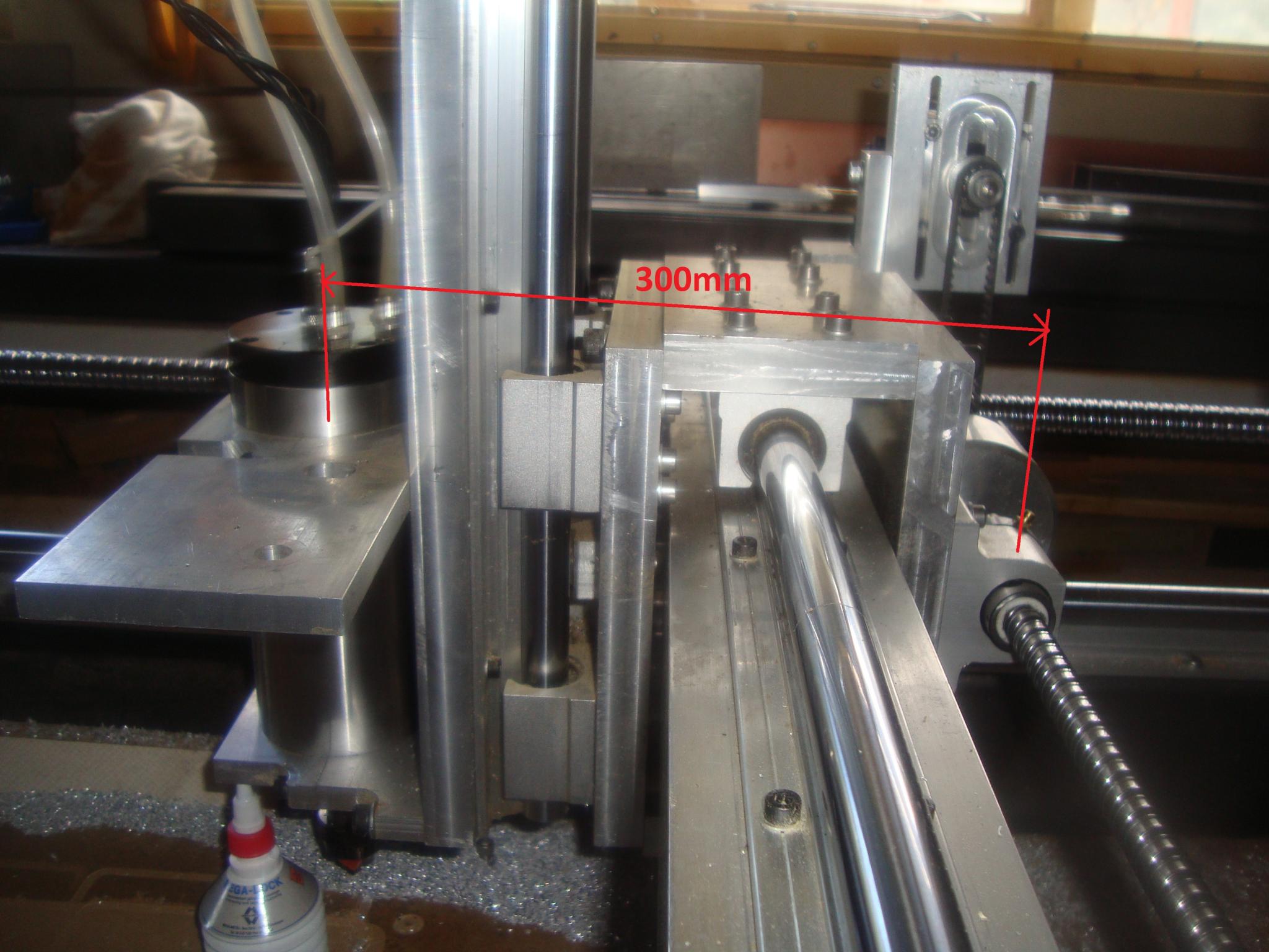

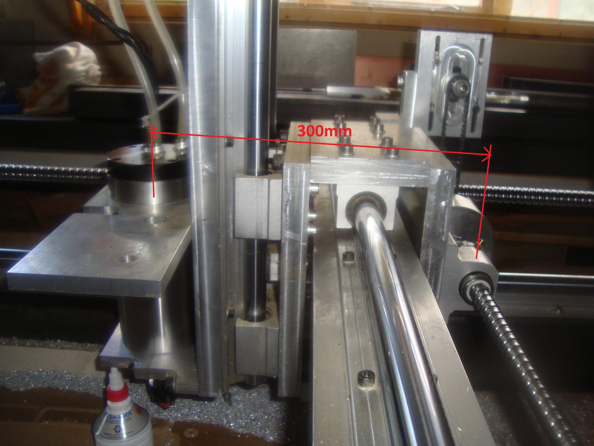

    On my router the distance, measured parallel to the X-axis, from the Y-axis (across gantry) ballscrew and spindle centre line is about 300mm. This allows the tool to deflect in the Y direction since the support is effectively 300mm away and the aluminium in between and the screw will bend since the linear bearings offer little support...
Name:	Router gantry Y distance.jpg
    The obvious solution to this is to put the screw closer to the spindle (ideally intersecting the axis of rotation of the spindle) but realistically it's still going to be at least 120mm away.

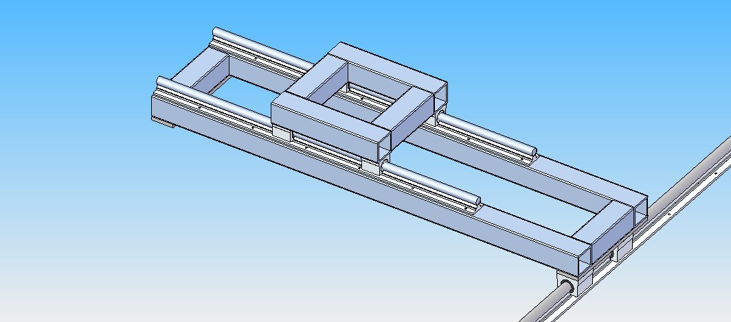

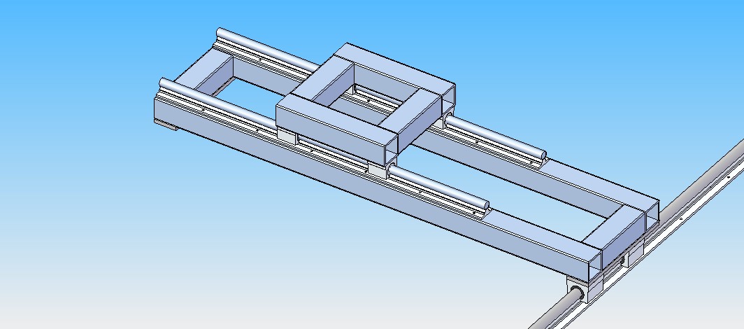

    So why not put another ballscrew on the other side of the Z-axis and add a second gantry cross piece on which one linear bearing will rest? Then the distance makes little difference and you've also pretty much eliminated the problem of the gantry twisting and helps with racking:
Name:	Provisional Router3.jpg
    (Bad drawing I know... add one ballscrew mounted beside each of the Y-axis rails.)
    Clearly the added cost of a second ballscrew is prohibitive (£65 for me), but I think it's worth the extra. I would probably link the two screws with a timing belt as adding another stepper and driver is expensive.
    Tricky bit is mounting the Z axis ... I could use the same argument to have 2 ballscrews on Z, but that's getting rather silly.

    I've only had a very small think about this, but the ball screw moves it, the bearings hold it. You say the linear bearings ar not supporting? They should though? They look like they are hanging free from either end? Anyway, can you can mount a dial gauge on the bearing rod, or the bearings themselves and pick up exactly where the flex is. I bet it's the x bearing rods flexing? It's probably not the screw at all, in fact, moveing the screw closer may allow the bearings to flex more (or the flex at the tool will be greater because the screw forms a triangle?). Mine has an ali extrusion that supports the rod, the bearings have a break in them, they cover about 270 degrees of the rod. So the bearing is supported all the way across. You could upgrade and squeeze some rails in there but ££££s. To me, if you dont want to spend much, and your relying on the screw as an anti twist device of sorts cuz the bearings have play, move it away from teh bearings if you see what I mean?
    You could add a third (or fourth) bearing, pref at the bottom, other side of ball screw so although the top still deflects, this will be minimised.. Whats the travel? I think there is a ground rod about a meter long and bearing (bearings if I can find them?) on the floor of my LR (Land Rover) (about an inch dia) (don't ask why!). You can have it for the postage mate if it's of any use?
