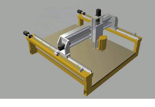

    Box section steel frame at least 25mm x 25mm - filled with sand (thanks JAZZ!) a bit like this one, (Is there a name for the high side design?)
    In the above pic, along with some other changes I'm thinking that I'd add a third vertical under the top rails and possibly add a cross bar at the back roughly where the steppers are at the far end for better stiffness and also triangulate the bottom of "open" end. I have seen another similar design that uses a substantial C section for the top rail too…

    To me that machine looks like an excellent basis and the changes you suggest sound worthwhile, particularly the triangulation. I would be inclined to leave the sides open as it may be convenient for long pieces. By all means make the steel box section that supports the rails bigger to compensate.
    Milling the surfaces for the linear bearings flat is a good idea, but you want to do it after all of the welding as any subsequent welding may throw it off again. If the milling machine is big enough then it's easy enough to clamp the whole frame to the bed - the difficult bit is clamping it to the bed without distorting. If it twists when you clamp it to the bed, then reverts when you take it off then it's a waste of time...
    An alternative to milling is using epoxy resin. Put barriers round the top of the box section where the rails round with a channel / tube between. Pour the resin in (couple of mm thick I reckon) and gravity will self level it extremely accurately.
    You can mill the spoil board with the router when it's finished. Having an adjustable height bed is great but it's hard to keep it level when you move it!

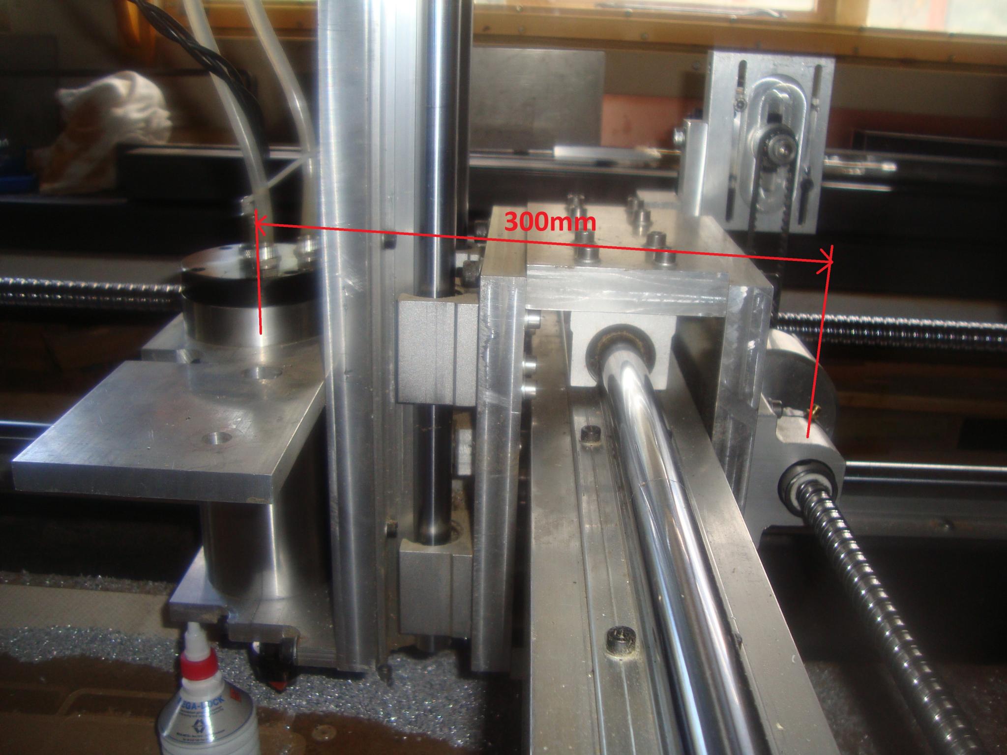

    The Y-axis ballnut should be as close as you get it to between the rails and not far from the spindle. That ensures that the only thing which can flex, when you apply a force parallel to the Y-axis, is the aluminum. If the ballnut is far away then the bearings can move on the rails relatively easily, leading to quite a bit of deflection.
    This is a problem on my machine at the moment:
Name:	Router gantry Y distance.jpg
    I think aligning the X-axis ballnuts with the center of mass in the XZ plane (or at least in Z) is a good plan as when the X-axis accelerates you've eliminated the turning moment about the ballnut. Ideally you would do the same for aligning the X-axis ballnut with the Z location of the cutting force, but that clearly moves so the best you can do is an average.
