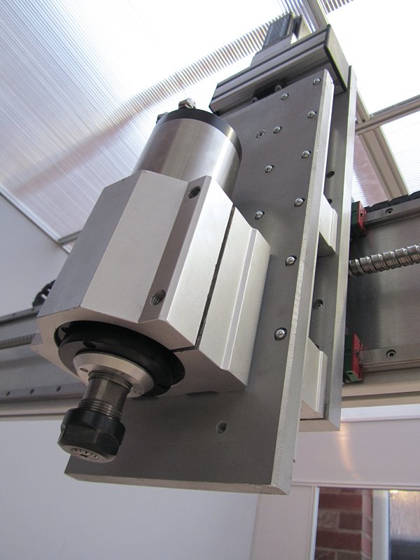

    Hey folks. After a spell of disappointments I've been wanting to update this thread with good news for awhile now
    Its a long and probably not that interesting story but the original machine had issues with flex and play in the Z axis. With the help of JazzCNC(thanks mate) I found out the causes and took this information back to the manufacturer who did the right thing and agreed to rebuild the gantry. We stuck up a deal whereby they agreed to upgrade some of the gantry components because of inconvenience caused and I paid extra on top for them to use heavy gauge 200x40mm extrusion. You could argue that it should have been built like that from the start but I'm more interested in cutting now rather than questioning manufacturer build decisions. The important thing is its fixed and looking good for materials up to aluminium.
    Jazz is sorting out some changes to the way the X axis ballscrews are mounted and I've still got a bunch of odd jobs to do here and there but I reckon it'll be cutting its first part within the next couple of weeks.
    I've attached a few shots of the new gantry. Compare these to the original posted on page 4 of this thread. Looking in much better shape now.

    The electronics supplied with the machine were OK but I wanted to more speed. To help with this, Strike did give me a 60v regulated PSU as part of the compensation but I had a change of plans and went with a pair of unregulated 70v supplies for the four drivers. I've taken it upon myself to upgrade the electronics and have got a lot of enjoyment out of doing that.
