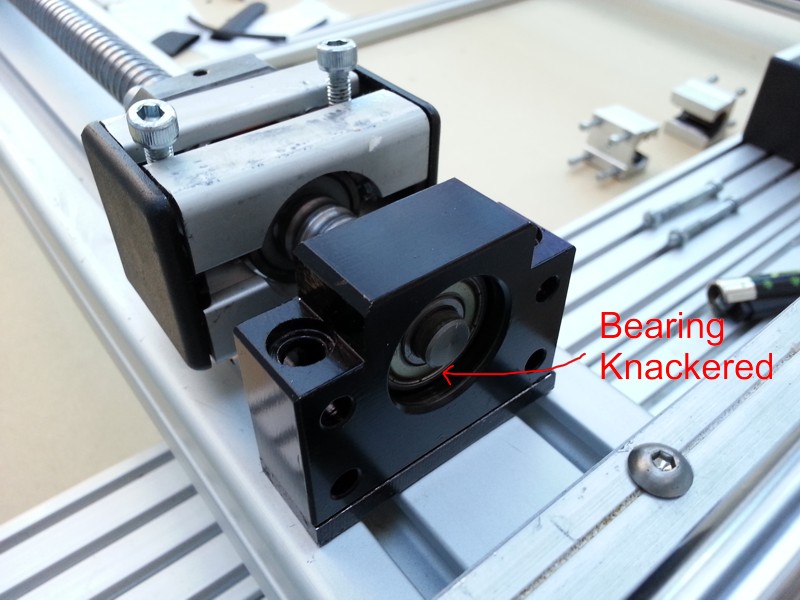

    OK here's some shots of the problems with Strikes replacement Gantry.

    At this point I'm going to re-design the Z plate and then pay someone on here to cut the part.

    Btw is it essential to have the ballscrew floating end mount on? The bearing is damaged and I figure it isn't really needed for such a short ballscrew since its supported at the fixed end and the ballnut?

    Quote Originally Posted by Shinobiwan View Post
    Probably not.
    The support bearings purpose in life is to support long screws from bending under thier own weight, and/or to stop screws from whipping when spun at speed.
    If the screw is short enough/not spun fast enough that whipping is going to be an issue, and it's not long enough/mounted in a way it's own weight could bend it (i.e. hung vertically), then you don't need one.
    I'm sure Jonathan will be along shortly with the required calcs for working out the theoretical critical/whipping speed (or just search for his posts, as he's covered it before)
  5. #115
    Agree with what m_c said. You can find the formula he suggested by searching for screw critical speed on google, but assuming the ballscrew is 350mm long the critical speed is 3500rpm - so 3500*5=17.5m/min. The formula isn't that accurate, but that's a huge amount more than you'll ever get on the Z-axis so you're fine to run it. It's <£2 for the bearing you need on eBay, so it's not much loss to get a new one, not that you should have to pay for it anyway.
