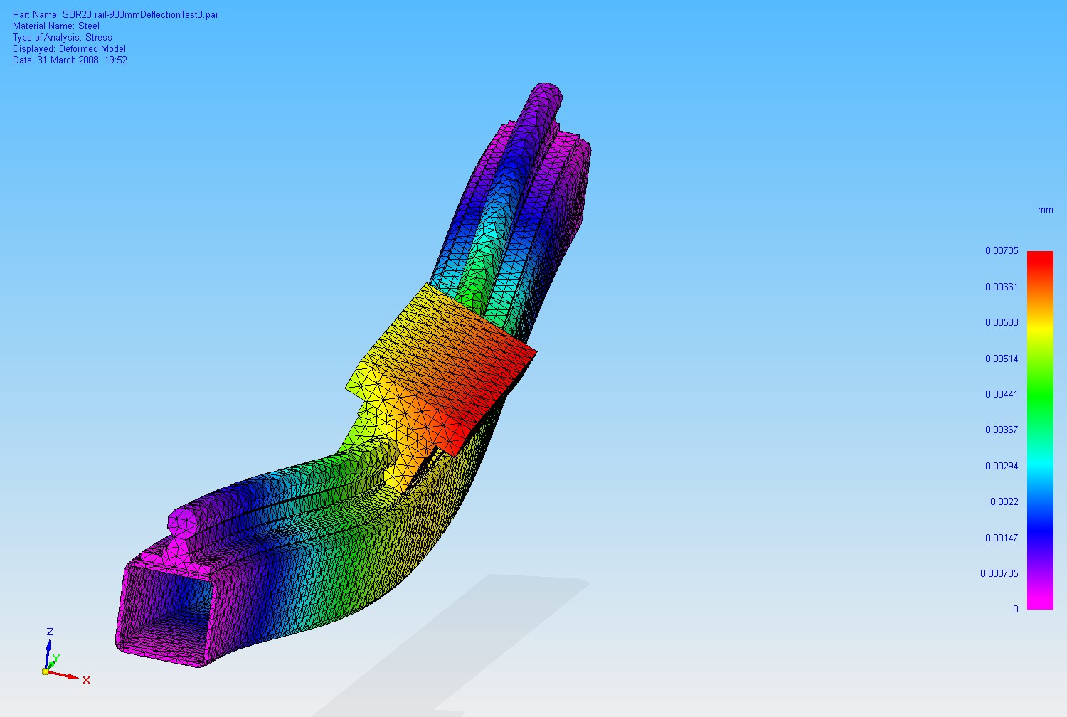

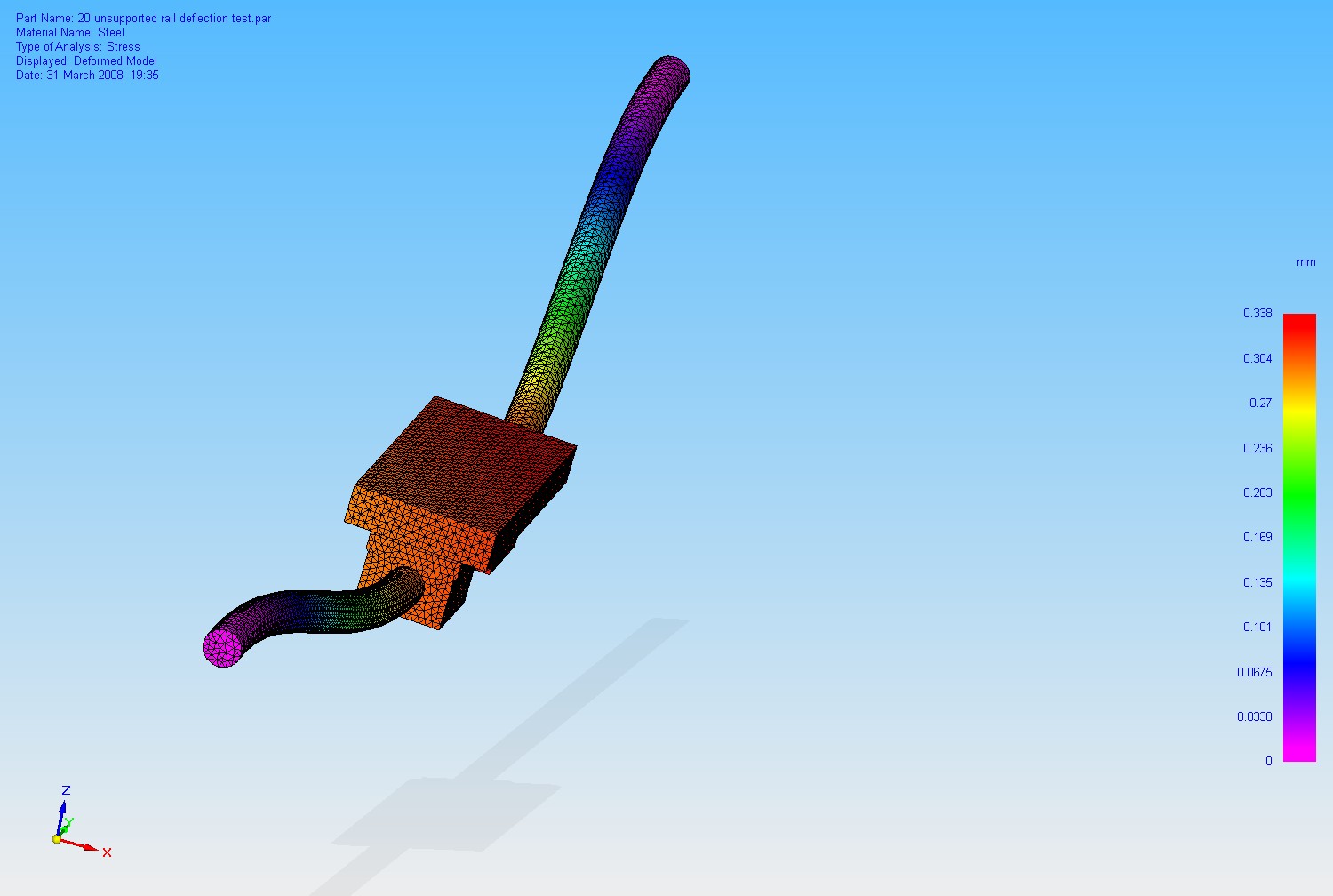

    All rails are 20mm diameter with 150mm between bearing block outer faces. The bearings are attached to a 75x160x20mm plate to which the forces are applied.
    Assumptions:
    Rail / box section ends are perfectly rigidly supported - in reality wont be so deflection will be greater than calculated.
    All joints are perfect, modelled as single entity - in reality will get some deflection between joints.
    The following diagrams each have different scales to make the deflection visible throughout.
    Unsupported rail 200N in Z direction to simulate weight of Z-axis:
Name:	SC20 900mm z200N x50N_steel.jpg
    Supported rail 200N in Z direction to simulate weight of Z-axis:
Name:	SBR20 900mm 200N_steel.jpg
    Unsupported rail 200N in Z direction to simulate weight of Z-axisand 50N in parallel to X for cutting force:
Name:	SC20 900mm 200N_steel.jpg
    Supported rail 200N in Z direction to simulate weight of Z-axis and 50N in parallel to X for cutting force:
Name:	SBR20 900mm z200N x50N_steel.jpg
    Max deflection for supported 0.0074mm vs 0.34mm for unsupported... draw your own conclusion.

    So, for those of us who are colour blind:
    Case 1) Unsupported deflection is about 100 times greater than supported
    Case 2) Unsupported deflection is about 50 times greater than supported

    You seem to be under the impression that I'm trying to say that unsupported rails are weak. I'm not, I'm saying they are many times weaker than their supported equivalent. If 30mm unsupported rails give you enough accuracy, then I'm saying you could achieve the same result on a much smaller diameter with support.
    If I'm honest, I've seen so much abysmal design in commercial machines that I simply ignore what 'expensive' machines do. Their objective is to make money not make good machines, and those different objectives result in different designs.
    Yes, there is deflection in the bed, I'm not implying this accounts for all the deflection. My only point here is that the same diameter of rail is tens of times weaker when unsupported, so all other factors being equal, if given a choice between unsupported and supported, you should go for supported.
