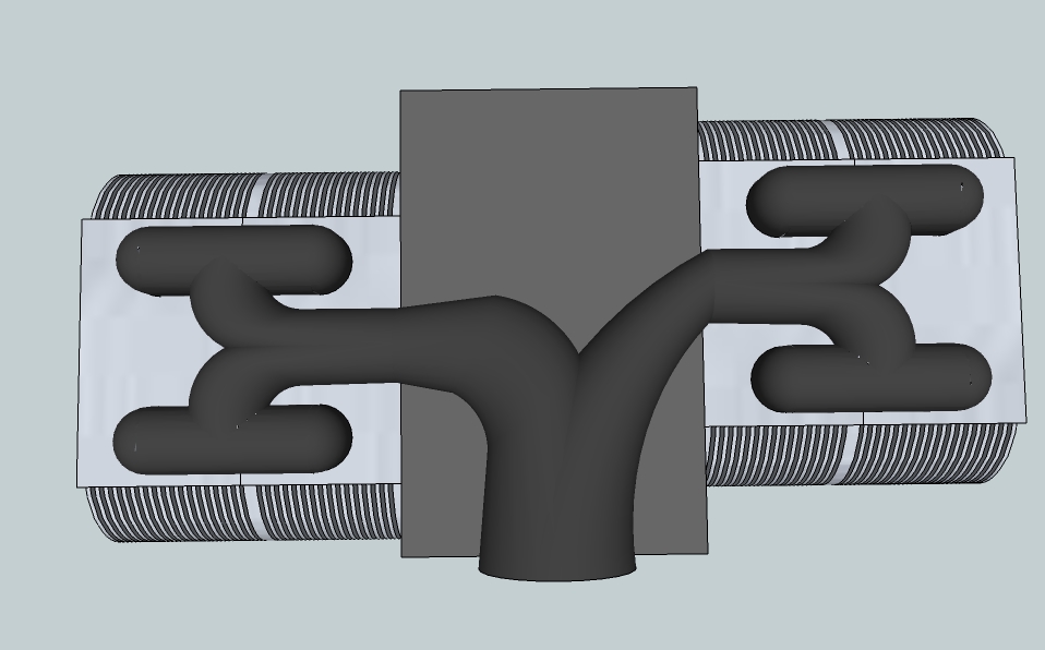

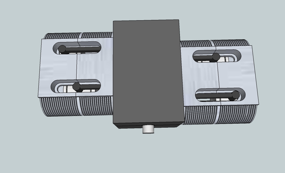

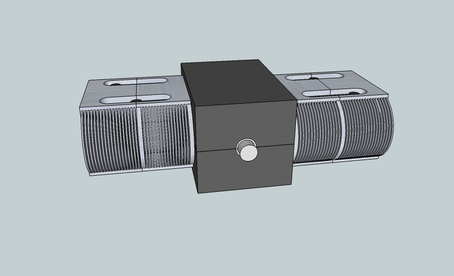

    There's something missing there, presume this is a simplified drawing. You can't run a round bar against a flat and ask it to push. You have to put a box around the bar so you have flats to do the rubbing.
    brett, its allways a good idea to let people have a look at your drawings so they can pull them to bits :) try not to take any criticism personaly... most of us have had a go at re-inventing the wheel and if nothing else, the attempt is fun and beats watching eastenders :)

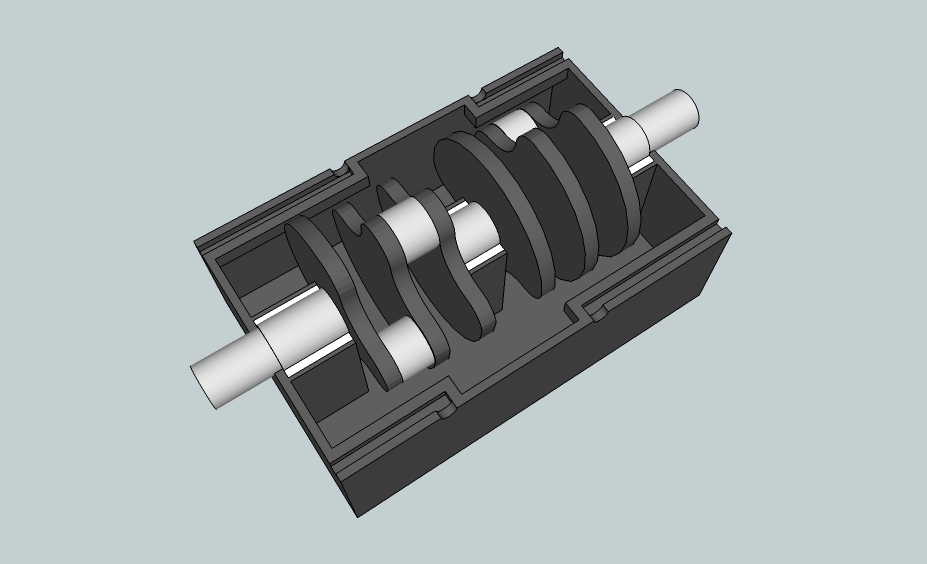

    your crank looks to have no meaningful counterbalance

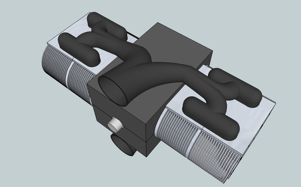

    your inner cylinder ports wont pull as much volume as your outer ports because of the con-rod obstruction (not sure if that would be a massive issue)
    the crank will have a very small footprint in that slot (not sure if that will last long)
    iv not seen a two stoke with injection, i think understand the issues you are trying to solve with injecting but im also assuming that the reason we dont see it is to do with the optimum injection timing being during induction so it would follow that the exaust port would still be open during injection and you would still be left with the old issue of raw fuel escaping before the exaust port closes (im sure two srokes are being phazed out for that very reason, terrible imissions)
    im reasonabley sure you could machine most of those parts with a lathe & cnc mill (im not overly confident on your design at this point though)

    BR i can see some issues with your design and position of TDC when firing happens. With everything being at opposing positions you will just end up with a pile of bits as it locks up upon detonation. I would look at a more traditional layout of the crankshaft myself? As for tools a Mill and a lathe is must for what you are doing. Buy the biggest you can get away with on your pocket and space. Allow plenty of time to learn the basics to save hundreds of hours screwing it up. Expect to spend more money on the consumables, hand tools and measuring devices than the machines.

    A combustion chamber at each end of the cylinder eh? :-)
    Turbo charger direct drive on start up and clutch disengages once EGT reaches working temperature?
    Scotch yolk?
    Looks rather like a modified 'Bourke' engine...
