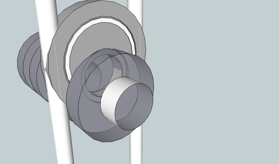

    Thanks for the advice Geoff. I didn't consider your post naysaying because you backed it up with facts and real experience. I looked but could not find any information on the limitations of the scotch yoke. The books you recomended sound like exactly the kind of thing I would be interested in. I don't mind a steep learning curve as long as the information is available. It seems like all the books or websites I have found are either ridiculously simplistic or very specialized. I don't have my heart set on this design I just think that simplifying is the answer to many complex problems, a philosophy I believe Lotus has always embraced as well. Thank you very much for your insights and I hope to chat with you more. This engine is not my main motivator for getting into machine work it is just something to discuss while I wait for the funds. I also plan to purchase a 1970s Datsun Z(I'm afraid Lotuses are a bit cost prohibitive here in the US) and rebuild an engine from a 1980s 280ZX turbo to swap into it. I don't know if head shaving is a bit advanced for a newby like myself but I may try it. I am just the type of person who likes to create things and metal seems like a wonderful thing to create with.

    I came up with a variation on the yoke that I think could solve some of the issues with not being able to deal with the stresses of a diesel motor. Instead of an open yoke that the crank slides in it has a round insert that spins inside the rod and off center on the crank. The diameter of the crank is half the stroke of the engine. I'm not sure if this increases or decreces the stress on the crank but the sliding and hitting of the yoke is gone.
