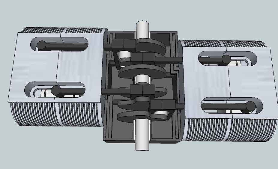

    That engine is pretty clever, using manual rods from the crank to open and close ports.
    So the piston is connected to one or both of the valves? If you made the valves come off the piston at 90 degress then you could have one cylinder with two expansion strokes as you could have a combustion area on either side of the piston.
  2. #42
    As for diesel 2strokes, they have existed in the past. Some had conventional valve trains, some were ported, but pretty much all of them were supercharged.
    Diesel 2-strokes used to be used extensively for model aircraft without supercharging before the days of outrunner electric motors. I'm not sure how well they scale up though.

    Actually a good share of commercial diesel engines are two stroke even today. Catapiller, and Detroit Diesel to name 2 big ones. The main concern with this design, I think, is that injection starts after the exhast port is closed, which I don't think will be a problem.
  7. #47
    Quote Originally Posted by jcb121 View Post
    clever boy :)
    Look at it again, there are no valves, only ports. There are already two combustion chambers per cylinder. The rods you see are the scotch yoke/connecting rod for the piston. Actually though if I had them go 90 degrees and then down I wouldn't have the difference in exhast flow on the bottom chambers.

    I wasn't talking about model engines. I was talking about ones that could power real vehicles!
  10. #50
ID:	6257Click image for larger version.
ID:	6258Click image for larger version.
ID:	6259Click image for larger version.
ID:	6260Well I took some of your suggestions and made some changes to my model.  I staggard the cylinders, increased the stroke a bit, made the intake ports longer than the exhast ports, and completely redesigned the crankshaft and crancase, including some counter weights.  I still need to redo the manifolds and induction system as well as add injectors and systems for cooling and oiling.  I wonder if one could design the lubrication and cooling systems as one system.  As in oil cooling, running the oil through a radiator and such.
