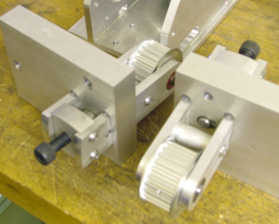

    I'm just about to try out open belt. I went for Plan B, I pre-tension springs with circlips then run a bolt in to connect the tension roller to the spring.
    The idea is that I can slacken the belts when not in use then set them by taking up the slack plus 2 turns.
    I'm using 16mm T5 steel reinforced belting. I hope to find out how stretchy it is tomorrow, will 2 turns be enough?

    Lives in East Lothian, United Kingdom. Last Activity: 1 Day Ago Forum Superstar, has done so much to help others, they deserve a medal. Has been a member for 9-10 years. Has a total post count of 2,908. Received thanks 360 times, giving thanks to others 8 times.
    Why?
    Modern belts don't stretch.
    Why?
    Everything stretches - it's a matter of how much, which in this case depends on things such as the width of the belt and type of tension members in the belt.

    If you're using the belt on a machine with low or zero cutting forces (e.g. laser cutter), then the gantry can be light so the force should be small enough for this not to be an issue. However if it's for a router as the title suggests I would do the calculation to find out how much the belt will stretch, or at the very least use the widest belt you can fit.

    I'd say plan A, provided it's adjusted correctly.
    However plan B would allow for a bit of idiot proofness if anybody happens to go tinkering with belt tensions.
    You don't have to retension timing belts on cars, and the latest ones last 150,000miles or 10 years with no maintenance.
    And given quite a few run with fixed tensioners, stretch isn't a concern.
