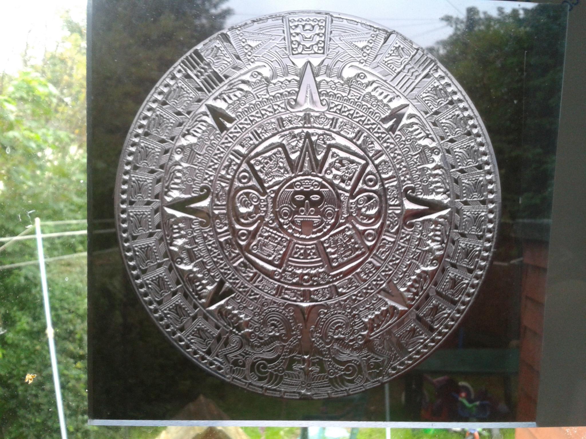

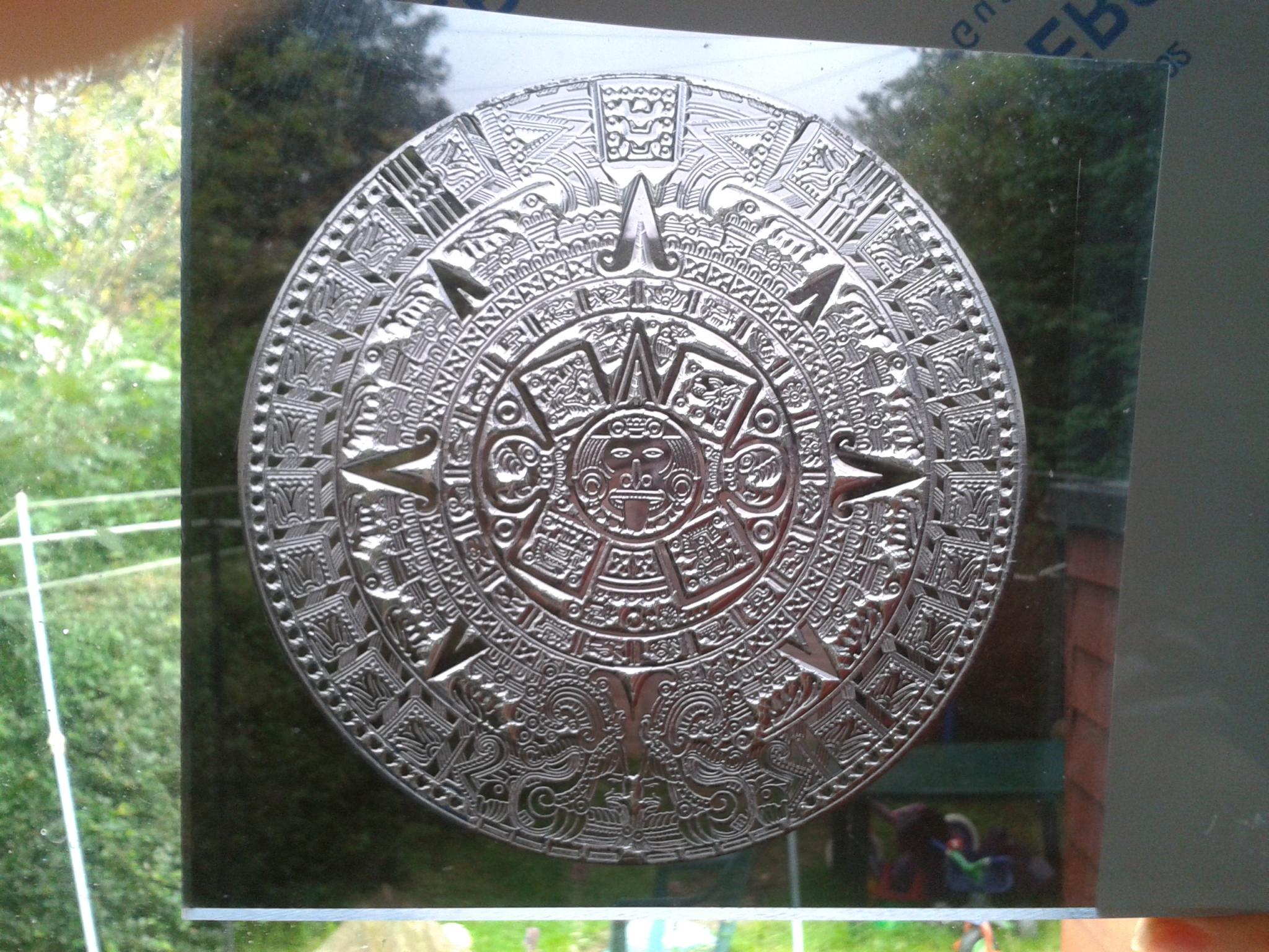

  1. Here are pictures of the test cut that I did to really put the CNC router to. Goal was seeing how well it cut and what the result would be from the required ability to:
    1. Not lose steps (position loss)
    2. Run at speed
    3. Finish of work
    It passed pretty much cleanly with only a few problems with the Ethernet card and that is being dealt with by Smooth Stepper and I have to say that they give very good support. Due to the few minor issues I was able to truly test the positional memory of the machine as had to restart cuts at a few locations.
    The item below was cut under the following conditions:
    1. Rapids where at 8000 mm/min Velocity with Acceleration of of 1250 mm/sec^2
    2. Cutting was done at 950 mm/min and plunges where done at 850 mm/min
    3. Bit was a 60° single spiral flue engraving endmill from Sorotec.de
    4. Cut time was 2 hrs and 43 minutes plus time for starts and resets.
    5. Material is smokey translucent acrylic that is 10 mm thick
    6. Deepest cuts are i believe to be about 5 mm.
    So here is the pictures. Click image for larger version.

    Hope you enjoy and I will try to remember to take some video when doing other cuts.
    Michael.
    Top quality Michael. Well done.
    Awwww. . Our baby's starting to come of age Micheal I'm starting to get all emotional. . . . . .Well done.
    that looks awesome... i dream of my machine doing something like this i really do.
    p.s that acrylic backing looks identical to the stuff i've bought recently.. it's not from henleys by any chance is it?
    Quote Originally Posted by wilfy View Post
    That acrylic isn't backing it's actually the material it's cut into.? . . . .Looks like aluminium at first glance doesn't it.!!
    the backing is still on at the right hand side of the piece... and yes it does look like alu at first glance, it's amazing
    Doh.!! . . .Yep get what you mean now.!
