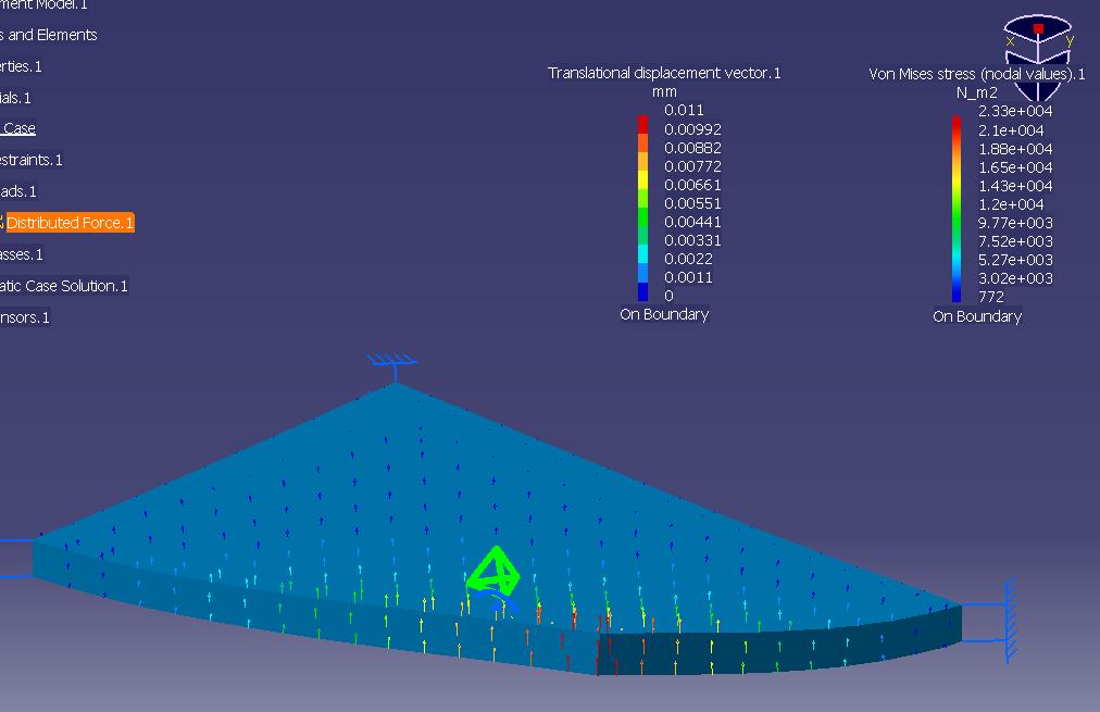

    I've answered previous posts on sideways mounted open bearings by pointing out that they will open up a bit with load in that direction. This time however I decided to carry out some stress analysis on a simplified part. The results were quite interesting.
    For a 16mm open bearing:
    1N load was applied vertically to inner bearing whilst restraining the outer face (the area you would clamp your gantry to).
    Displacement is 1.85e-5 mm, therefore 1.85e-5 mm/N.
    So for a 30kg gantry spread over 4 bearings thats 73 N per bearing, which is about 0.00136 mm or 1.36 microns.
    Initially that seemed pretty small so either there was an error in the calcs or I was worrying over nothing - but then realised that I should really model the supported rail and include that since I think it would be quite significant. Will have to wait for another night . . .
    Here are the pretty pictures for the open bearing under 1N vertical load. Stress on the left in N/m2 and deflection on the right in mm.

  3. Hi RouterCNC, what package are you using for that?
    Hi Tenson, Irving2008
    The software is called Catia V5 made by Dassault. It is a very powerful piece of software designed for high end use, and very expensive. FEA is just one small part of the software.
    I'm sure there are cheaper packages out there which will do the FEA part of the job - on simple parts at least.
    It will also do modal analysis although I've not used it for that.

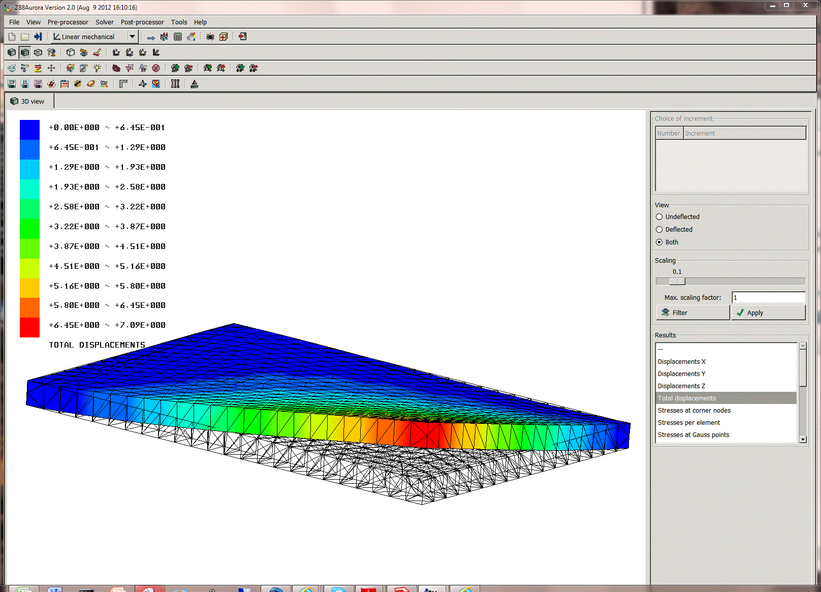

  5. Been looking for a freeware FEA package. Been playing with LISA but the 300 node limit of the free package is... limiting ! And I'm too tight fisted to spend $80 on the full one until I'm sure I can use it properly!

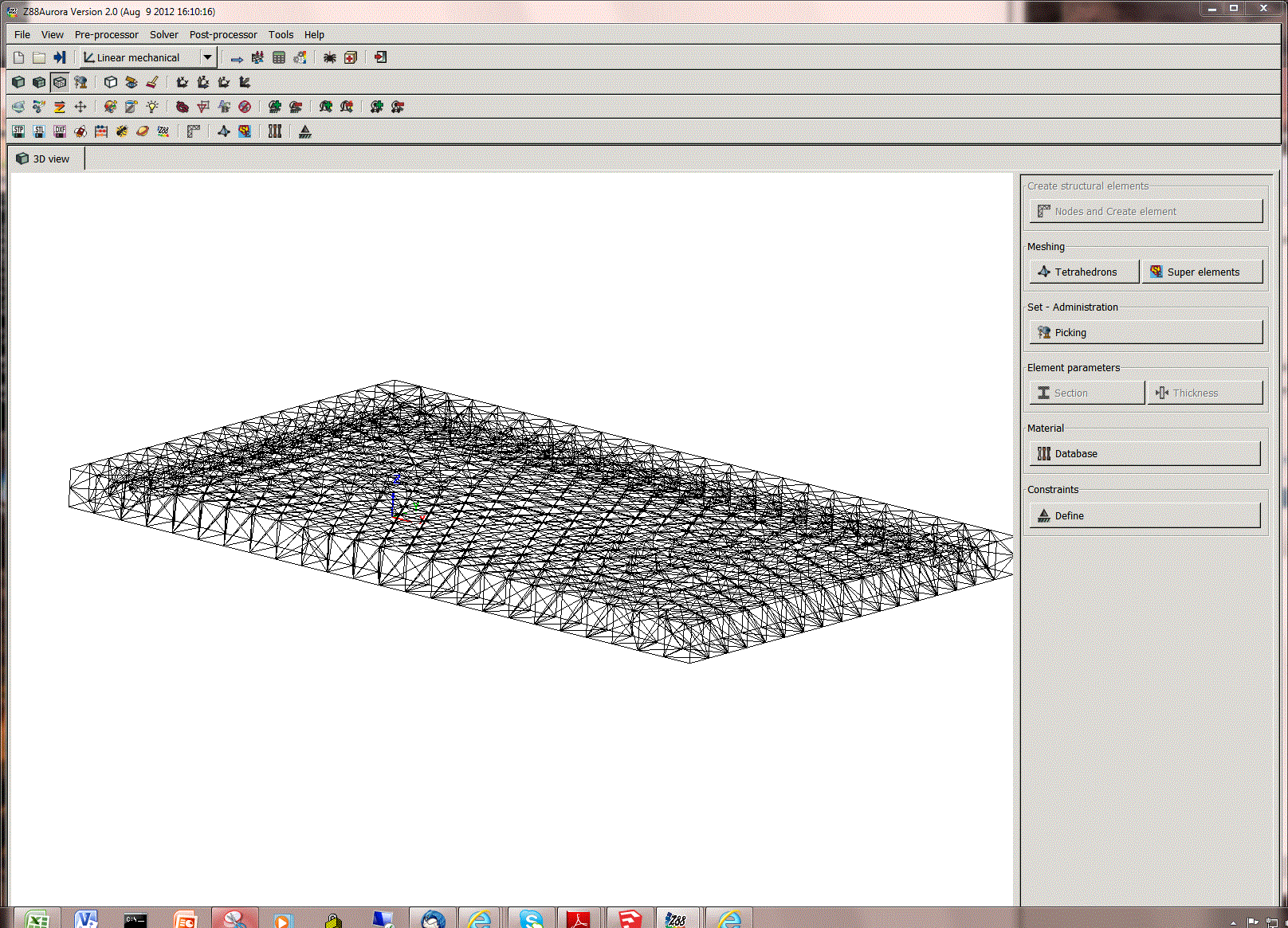

  7. Ok so far I've looked at/tried...
    AxisM11 Lt
    Z88Aurora v2
    Lisa FET
    Analysis for Windows 2.04
    GeoTec

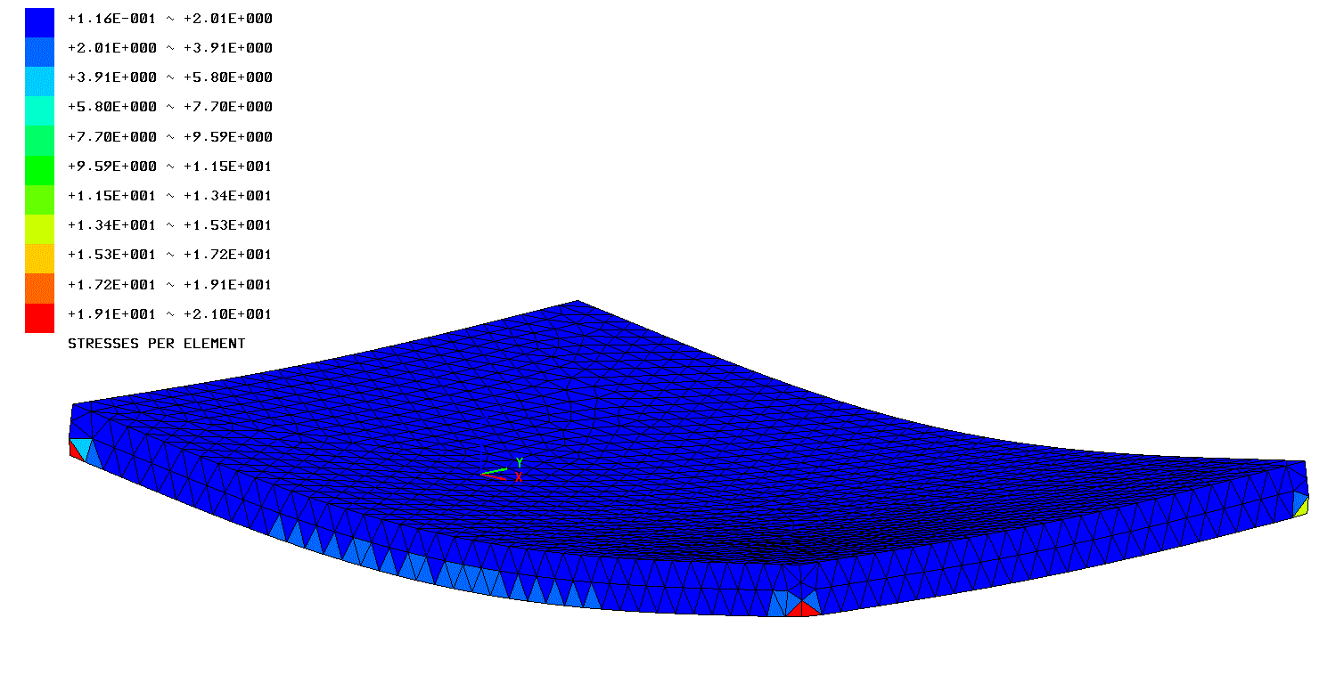

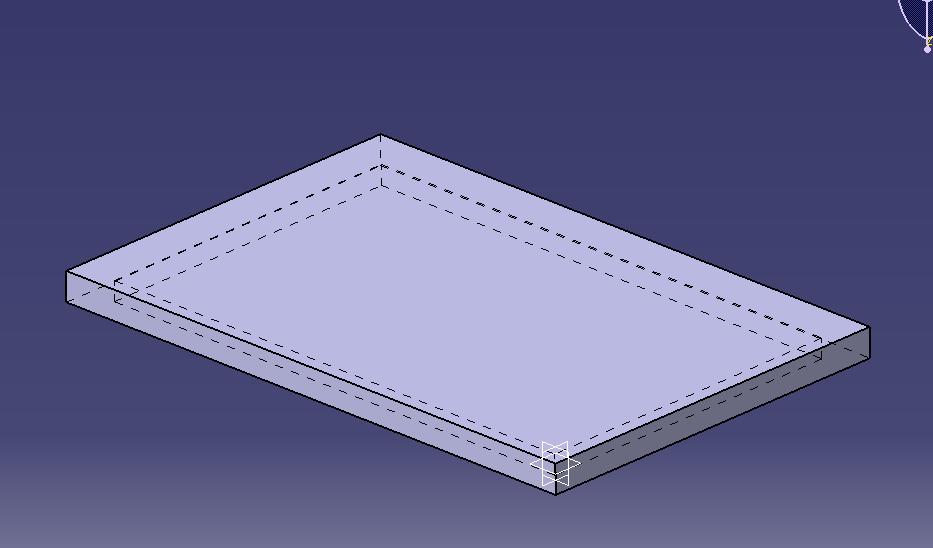

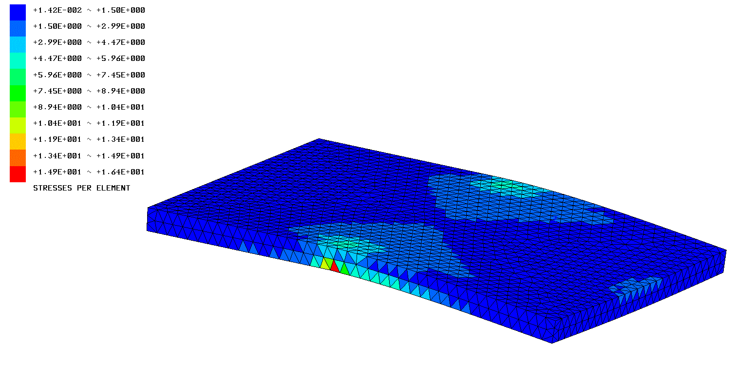

    All have their limitations or complexities - usually the free version is limited to a few 100 nodes. Z88 is the most flexible having no limit to the model/structure size but its harder to work out how to use.... Lisa works well, but for the 300 node limit, but I've not figured out how to model what I want in it yet... my understanding of the way to get my real world model into the tool is limited...

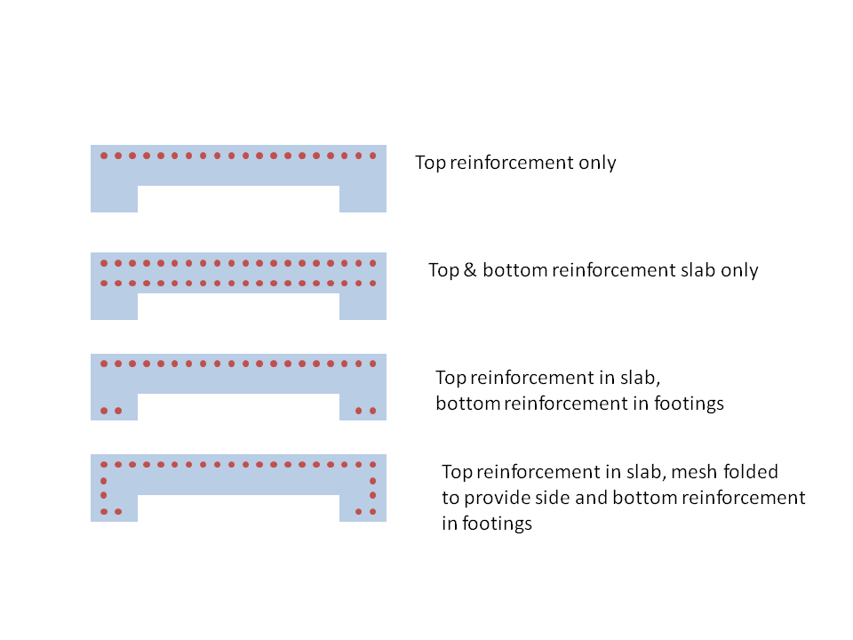

    what I'm trying to do is model a concrete slab with reinforcement. I've not found a tutorial on this online yet. I'm guessing I can model it as a set of stacked beams/fibres?

  9. Quote Originally Posted by WandrinAndy View Post
    Does that explain the slower than normal progress on your workshop build Irving ;-)
    Lol
    No, progress halted by the fact the hole is doing a poor impression of a swimming pool filled with porridge :(
    But before I order the reinforcing mesh I want to check out that A142 mesh is sufficient and whether I should put 1 layer mid beam or 2, top and bottom, or fold the top one down the sides and back under the footings
    The reason being thast the clay soil I am 'floating' the raft into can experience 'heave' of up to 150mm potentially so there's quite a bit of stress on the raft if thats all at one end...
