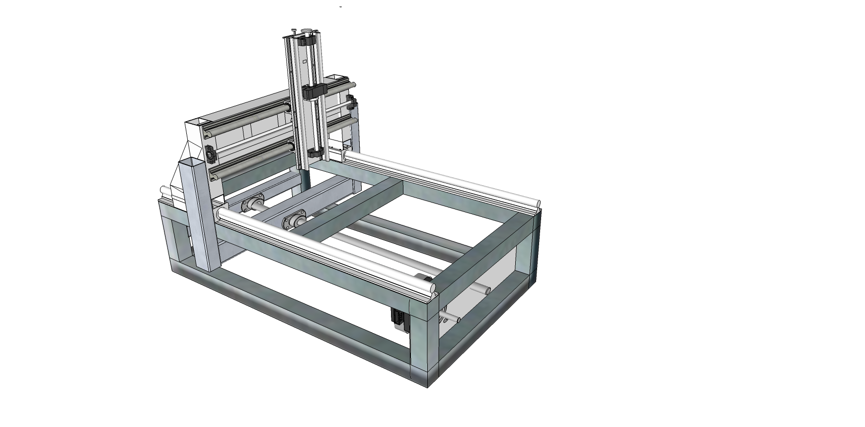

    managed to have a play with sketchup WOW what a piece of software. with thanks to kingcreaky and his file in this thread http://www.mycncuk.com/forums/router...ation-cnc.html and other kind people who have uploaded files i managed to create 'something' that resembles the router i have in my head. if you guys could have a look at it and let me know if i am on the right track it would be appreciated it is not to scale but if i am on the right track i will start to work out measurements

    Couple of thoughts...
    That X screw looks heavy... what size is it meant to be? Also with the stepper inside the frame you've limited X travel - Is that what you intended? I also noted the misalignment of the screw on the rear bearing but thats just a drawing issue.

    well like i say nothing is to scale i just want to make sure the basic design will work. i don't know where to start when it comes to screws and motors so i thought i would get the frame work done first (if it passes inspection lol) then move onto the next step
