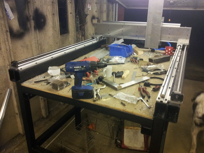

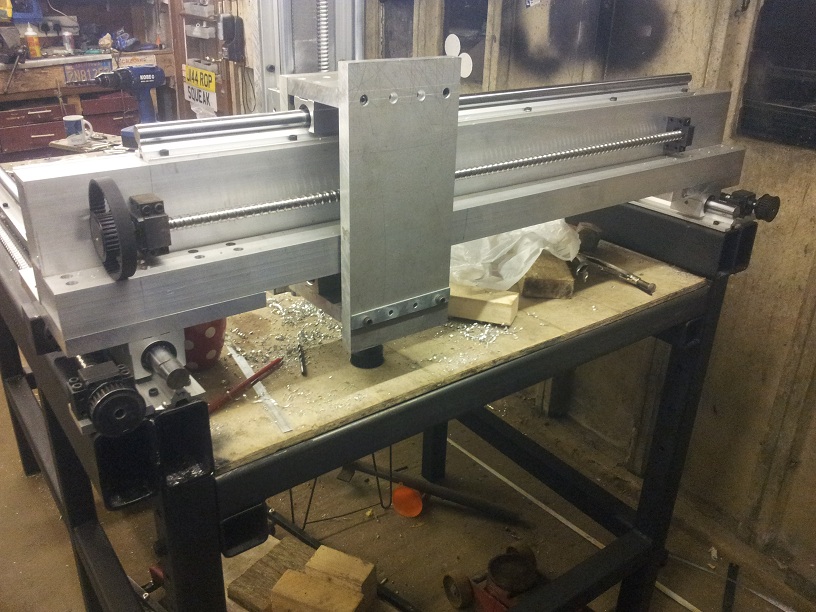

    small update.
    X Ballscrews on... and connected to gantry using chai's bearing blocks... (although run out of m6 cap bolts, so ordered some here tomorrow) - incidently, that means ive used 200
    pulleys done on X, was very suprised at how effortless the gantry moves when turning pulleys. I was initially worried the steppers wouldnt have the balls but the gantry moves very easily.
    I was even more suprised to see, if I just turn one ballscrew the drive goes down the ballscrew across the gantry through the other ballscrew and turns the other pulley.... thats got to mean ive done something right?
    there is a bit of track... if you hold one pulley and turn the other... I think ultimately I will connect them both with one big belt.

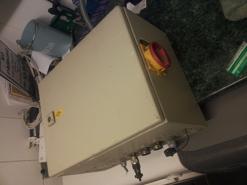

    seperately... Ive managed to scavenge a electrical inspection box from the darkest dungeons of where I work.... perfect for all the electricary and can be mounted to the machine.

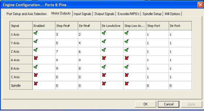

    Ok... so all seems well... Y is working, Z is working. X however is causing me grief
    as previously explained X has two steppers... I have set X to be one, and A to be the other
    then in mach3 set A to be the slave of X
    Ive wired the stepper drivers in 'active low' so
    A-----------
    PUL(+5V) --- 5v feed
    PUL-(pul) --- PORT 9
    DIR+(5V) --- 5V FEED
    DIR-(DIR) -- PORT 8
    X----------------
    PUL-(pul) --- PORT 3
    DIR-(DIR) -- PORT 2
    both steppers turn correctly... however I need to reverse one... so it kinda goes in the opposite direction to the way its presently going?
    doesnt matter which one...
    make sense?
    also, obviously im using a stepper controller for each stepper... cant I just use one controller for both?
  7. #137
    Just Change either of the DirLow active in Motor outputs and it will spin other way.
    Yes you can control 2 motors with one drive but not good idea because of the way they work and sharing pulse's etc, just don't do it.!!
    Also if your slaving motors you want away to control each motor for squaring the gantry and one drive won't allow that.

    thanks jazz. do you mean just in the software... ie (changing tick to cross) or change the wiring aswell.... (or both)
    dan - yep. thats Mr Cooper. 7 y/o my little mate.
  11. #140
    Well really it's better to change the wires because of the way the rising pulse works but you can just change it in software and it will work fine. If you have any funny happenings like missing steps on that motor then change the wiring but 99% of time with modern drives it will be fine.
    Noticed the screen shot shows B axis active and A axis not but you say your slaving A axis was that a Typo.?
