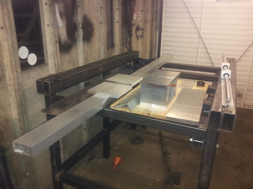

Some simple calculations can give you a better feel.
By way of example (and i'm not suggesting this is how to do it necessarily) lets say your gantry is a couple of 60 x 60mm x 3mm 2m long steel box sections joined by 3 bits of 10mm ali plate 200mm x 200mm at each end and the middle. The overall weight is 15.5kg and the deflection in the middle under its own weight, (ignoring the extra stiffness from the ali plates) would be ~0.1mm. A 10Kg spindle/z-package would cause a further 0.1mm sag, for a total of ~0.2mm. The max load on the bearings would be 255N which is nothing for a 25mm SBR. Increasing that to 100 x 60 box section with thicker walls would stiffen it further. Box section has its own issues with resonance but there are ways round that. The Y-rails would add further stiffness. All calcs are approximate and a more thorough analysis could be done.
So its doable... just need to get the detail right...

Also, I can see where I went wrong in my blogs and I have mislead everybody. To be clear forget about 3 meters. the bed im planning to make will be at best 1700mm by around 1100mm

This is excatly where i'm going with my machine simply because it'll suit my workshop more. My latest design has the longest axis of 2m on the gantry using 2 or 3 lengths of 60x60x5 stacked on top of each other with an ali back plate and using a rotating ballnut to drive it on a 2510 screw.
But then am i sacrificing rigidity of the machine just to make it easier for me to access.....?

Im thinking 1400mm x 800mm x 300mm. with the conventional setup (having x being the widest axis) and having a shorter y. Unlike what I previously suggested earlier in this thread.
Being Realistic, I simply do not have the skills to be able to pull off a spun- ball screw nut. Manufacturing all the housing etc is just out of my depth. (as previously suggested), so my first question is
1,)What is the maximum length I can have, with a conventional 'spun-ballscrew' setup (keeping the nut static)?
